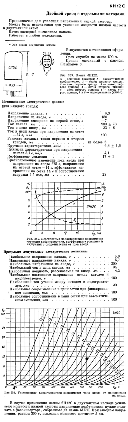

The Chinese 6n12p is not a type number I can find. 6H12P is IO base and 5687 is B9A and similar to ECC82 but has a different pin out.
5687, Tube 5687; Röhre 5687 ID20809, Double Triode
''GSTube.com''. Tubes, sockets etc. Parameters and characteristics 6H12C

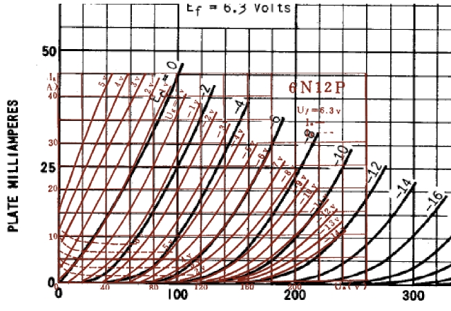

Thank you, chinese 6N12 is octal and near equivalent to 5687.
Here says 6N12P & 5687 are equivalents.
