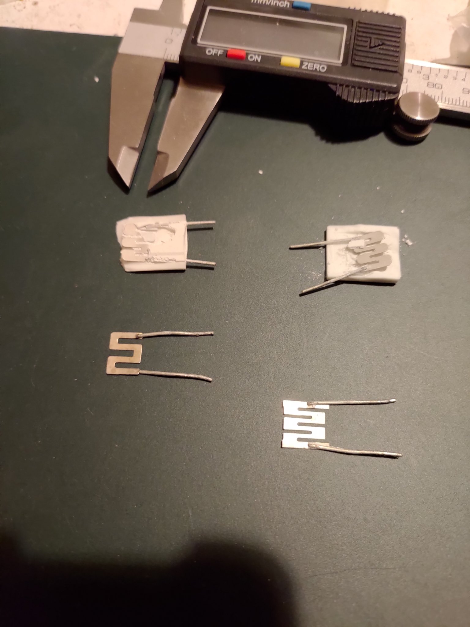

I like to show you the inside of a cracked open 5W power resistor I bought on Aliexpress.
Those resistors are sold as "BPR56" 5W non-inductive power resistors and cost roughly 0.30€ p.p. including shipping so I was hoping they could be somewhat well made.
Needless to say I accidentally destroyed one of them during measurements and cracked it open to see what is inside.
What I found inside looks rather disappointing:
Lots of cement filler and the actual resistor looks like it can handle 1W maximum.
Also, the resistor is wire wound, thus not low inductance.
Here is the picture:
What do you think?

The half-watt inside a "2 Watt" brick is an old-old story.
For 1/3rd of a buck, I think you got everything you paid for.
Yes wire-wound (shocked) and low-Ohm but it takes a LOT more turns than that to matter inside or above the audio band. Look at an output transformer's 8r winding: 30-100 turns on an iron core.
The naked element may be one-watt but embedded in masonry can handle a lot more. Bad embedding (porous plaster) could reduce the rating but good clay and porcelain can raise it by increasing the effective surface substantially (and cheaply) without raising thermal resistance as much.

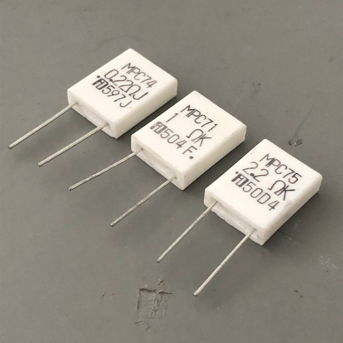

Seems legit, looks like they cloned KOA Speer BPR58 with a snake like resistive element, these resistors cost 0.31€ from TME if you buy 10 so the same price as the dodgy Aliexpress ones but no free shipping from TME.

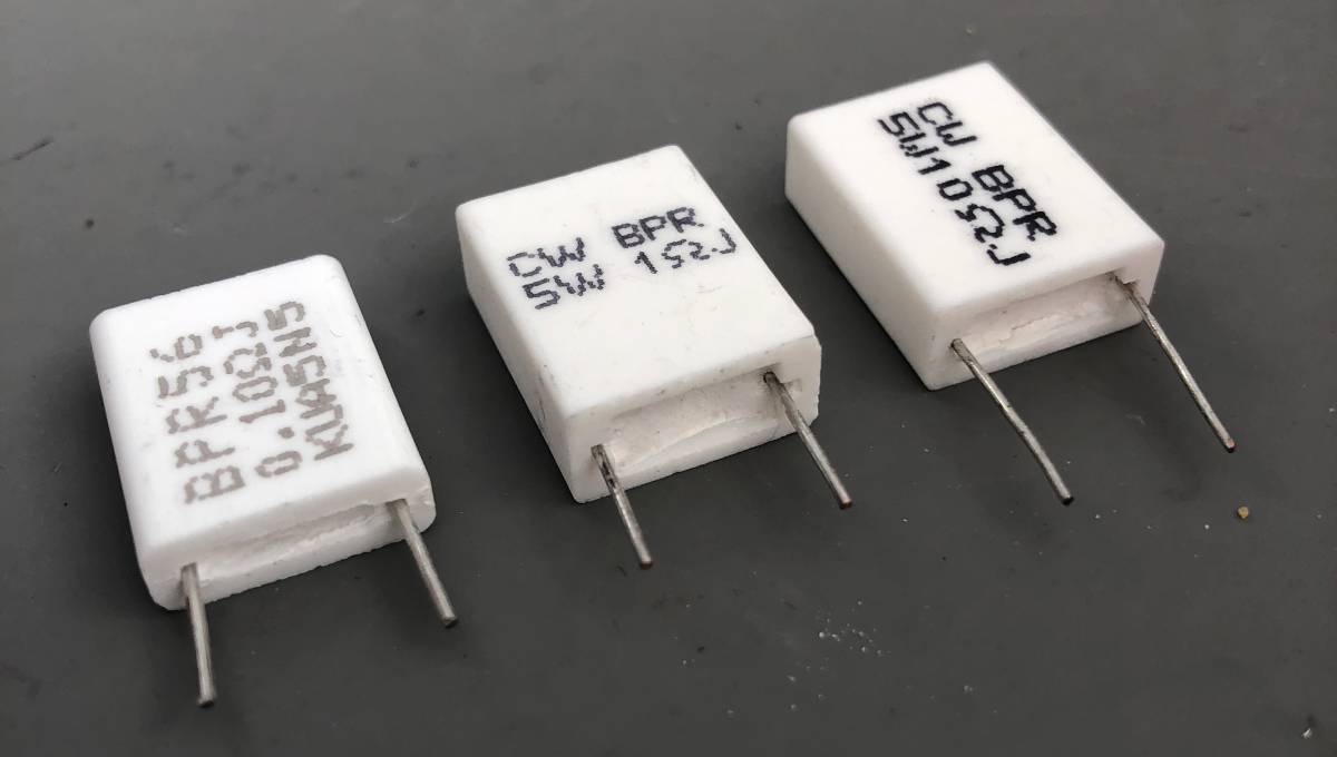

I promised an update and here it is:
This is my collection of fake BPR resistors so far:
As you can see, they all look different.
The 0R1 is much thinner, the 1R0 is much thicker, the radius at the edges is different, the print is different and the inside like is different, too.

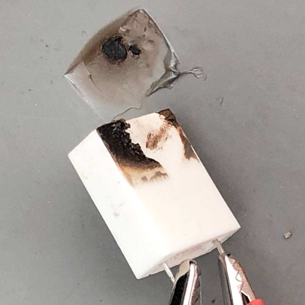

At a voltage that should result in 5W dissipation, it burned my (Chinese) anti-static soldering mat:
I must have done something wrong because the 10R did not burn a hole into the mat. I guess that the (Chinese) multi-meter reading was wrong.
Even the resistor ceramic slightly changed color due to overload:
The resistor inside looks similar to the one inside the 10R resistor, just has thicker wire and if you look closely, you can see the overstressed wire changed color:
I did not test the 0R1 resistor, but cracked it open right away. This is how it looks inside:
Totally different design. This is how I expect such a resistor should look like inside.
I was kind of expecting this since the bottom view hints that the opening is too narrow for a cylindrical resistor element.

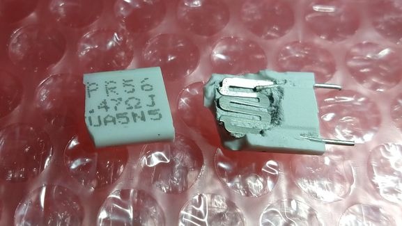

Very interesting thread !! Had purchased many resistors , BPR56 , from same mentioned ali*** , and never had big problems with them . Purchased low values like 0,1 ohm and 0,2 ohm as i can remember now , have some unused ,some desoldered ,so probably i will disassemble one to check what's inside and post photo. Used them in amplifier ,and in electronic load ,had some oscillation issues , which had resolved. But what if that was caused by these resistors fake parameter (non inductive)...

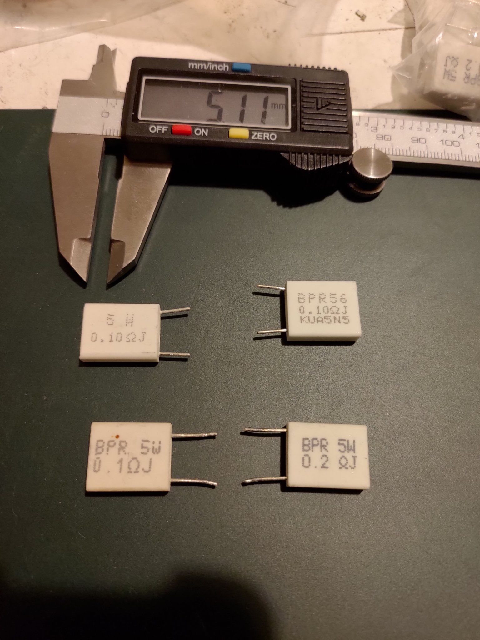

Lee, what is the thickness of your 3 different resistors shown in #10?
