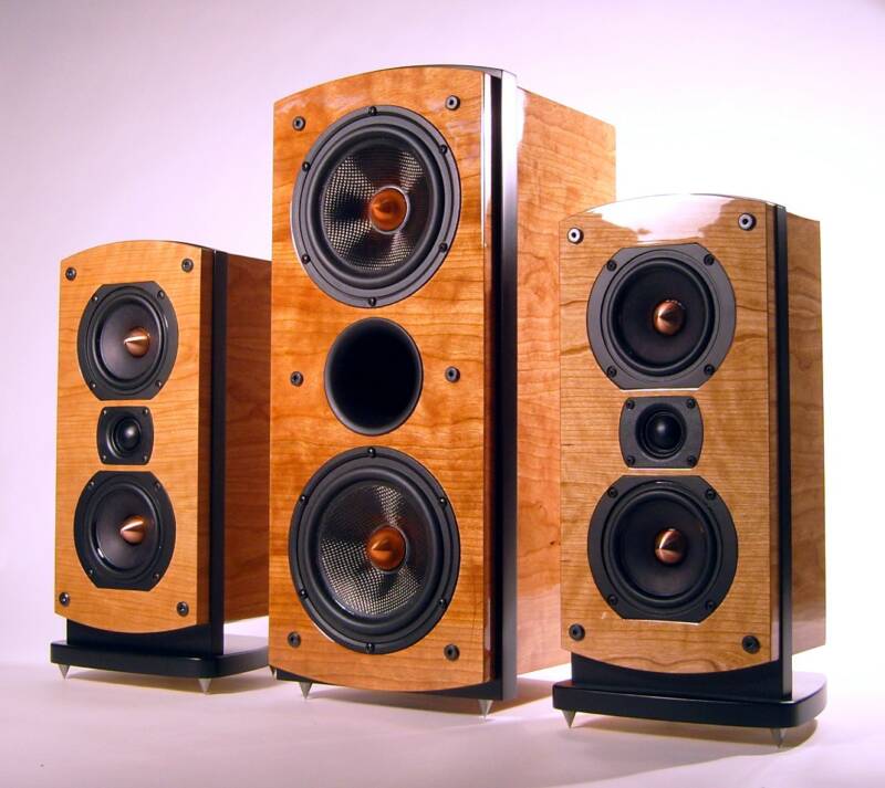

Something like this might look nicer.
You can do all sorts of wonderful things with MDF and nice cherry veneer, as shown above. 😉

If you want to save on labor and materials, you could purchase MDF with cherry veneer already glued on to it. You would have to get a 4x8 sheet but if you consider the absence of all machining of the solid lumber, it’s a clear winner. MDF is a better core to for a speaker cabinet anyway. The other potential problem that you will eliminate is a possibility of your speaker drying out and cracking or warping in a years to come.
