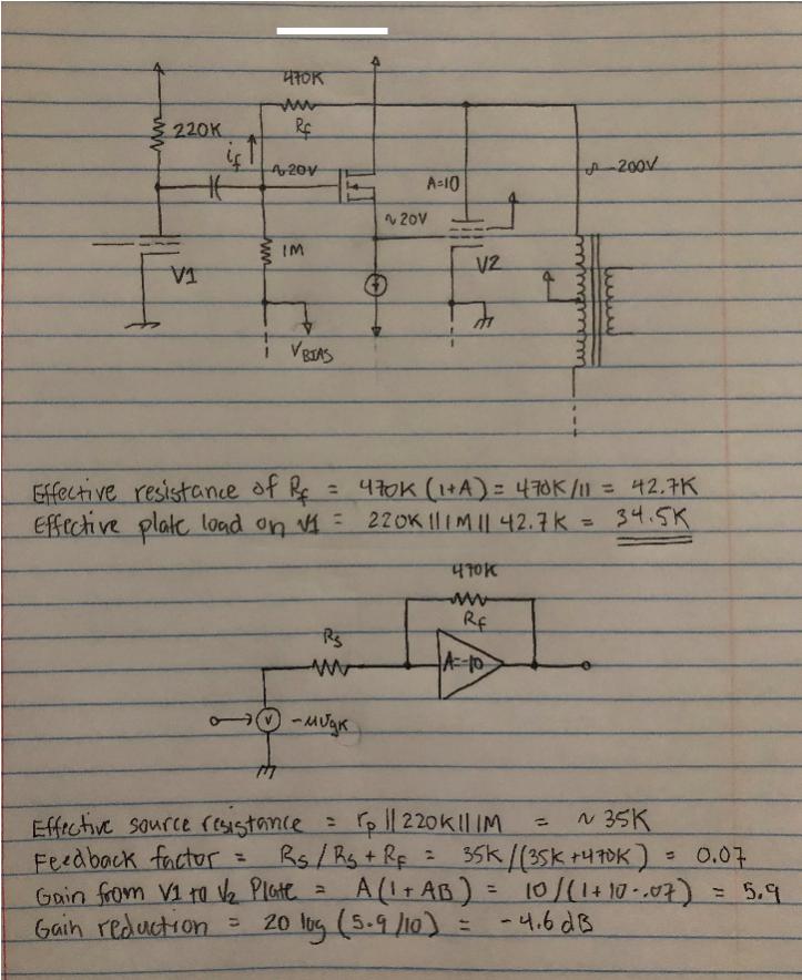

I'm having a debate with another hobbyist and I was wondering if someone would check my calculations. The image is a simplified schematic of part of a push-pull pentode amplifier. There is a 470K shunt feedback resistor from the plate of the output tube V2 to the input of the source follower. I would like to determine the effective load resistance seen by the plate of the driver tube V1.
1) I assume the gain of the source follower is unity.
2) I assume the gain of the output tube is 10.
3) The feedback resistor is bootstrapped by the gain from the MOSFET gate to the V2 plate, giving an effective resistance of 470k / (10 + 1) = 42.7K.
4) The effective plate load on V1 is the parallel combination of the plate resistor, the bias resistor, and the bootstrapped feedback resistor, 220K || 1M || 42.7K = 34.5K.
To throw some more numbers at this, assuming the amplifier is driven to full output with 20VRMS on the grid, giving 200VRMS on the plate:
Feedback resistor current = 220V / 470K = 0.47mA
Plate resistor current = 20V / 220K = 0.09mA
Bias resistor current = 20V / 1M = 0.02mA
So, the total AC current in V1 is 0.58mA. With a 20V swing, the load line resistance is 20V / 0.58mA = 34.5K, the same result.
The bottom diagram is a more basic model. The signal source is the Thevenin equivalent of V1's internal generator voltage, uVgk, and the parallel combination of its plate resistance (~44K assumed) the 220K plate resistor, and the 1M bias resistor. This gives Rs = ~35K.
Rs in series with Rf forms a voltage divider having a ratio of Rs / (Rs + Rf). This gives a feedback factor of 0.07, a little lower than Schade's recommended 10%. Using the feedback equation, the resulting closed-loop gain is 10 / (1 + 10 * 0.07) = 5.9. The resulting reduction in gain is -4.6dB.
In the real world there will be some cathode resistance on V1 which will increase its effective plate resistance, giving more feedback. Also, the value of plate resistance may be higher depending on the tube's operating point. So the actual gain reduction may easily be set to Schade's -6.95dB.
Note that the gain reduction is from the V1 internal voltage generator, not its plate. This is an abstraction, as uVgk cannot be measured directly in the circuit.
This example is based on a schematic floating around the forum. The real-world amplifier uses a 6SL7 differential driver with a tail current of 1.15mA, or 0.575mA per tube. Since we calculated above that we need an input current of 0.58mA RMS = 0.82mA peak, it follows that the circuit as designed will be unable to drive the amplifier to peak output. Nonetheless, the designer has built and tested the amplifier, hence the debate and the conundrum.
FWIW I have put the full amplifier schematic into SPICE and confirmed the values I obtained by calculation. I know SPICE sometimes lies or gives misleading results but the fact that the simulation yields the same result increases my confidence in my math.
Assuming the value of 34.5K for the plate load is correct, this would seem to be far too low a value for a high-mu tube like the 6SL7 to drive, even at levels below the clipping point.
Since a number of people have built the amplifier and it seems to work I'm at a loss to explain the apparent contradiction. It would seem that I've made a mistake. If so I would be very appreciative if someone would show me what I've done wrong.

I don't see the image.
There is no low-load a tube *can't* drive. It may be weak and nonlinear, sure. Without seeing the circuit I would expect gain above 30 with 34k load and THD like 5%. "Works".

Changed to an attachment, should be more reliable.

I don't see any errors, math or theory with a quick exam. And yes, I see the schematic in the second post.

I'm not smart enough to be able to parse a much smarter person's thinking, but maybe could add some common gotchas.
The gain of the output stage can't really be "defined" a priori. It'll fall out at the end of your calculation. Maybe start with an estimated open-loop gain, 30?, or something in that range, from an estimate of gm times R-load.
The first stage valve might be more usefully modeled as a current source when studying the current summing node. And of course the MOSFET can be ignored.
So, the interesting part is the current summing node, with the first valve's current contribution, some parasitic R losses, not too bad, and the fedback current from the output valves. All sum to zero, but what's fair in your zero-sum game?

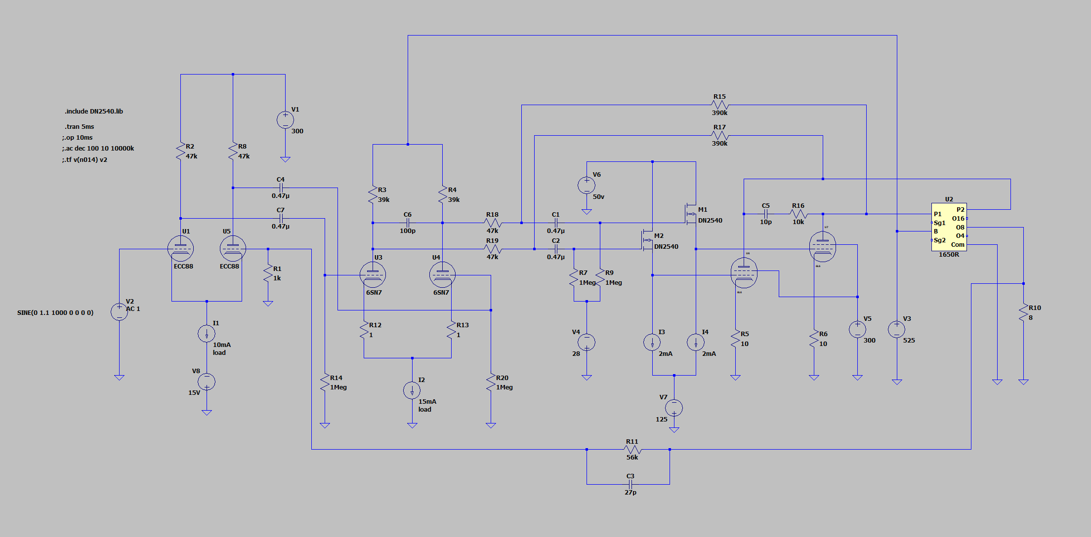

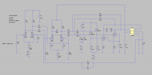

I have two power transformers rated 380V @ 800mA and 6.3VCT @ 7A. I was intending to build monoblocks but I don't have space in my rack. One power transformer would be sufficient to run a stereo 807 amplifier. Monoblocks are not out of the question, but simpler is better.
The outputs are Peerless S-271As from Magnequest Mike. They are supposed to be superb transformers. The main reason I never built an amplifier around them is that I was always waiting to do a no-holds-barred design. The complexity and challenge put me off and I never got around to it. Setting an achievable goal increases the probability I will actually do the project.
KT-120s would require separate chassis on account of the increased filament draw. I have some nice screen regulators I built last year but I think UL would be better in this case. I don't want to rely wholly on global feedback for low output impedance. Because the grid drive requirement is double for KT-120s versus 807s, designing a driver stage for shunt feedback would be much harder.
I guess a good way to motivate myself is to get other people interested in my project. I would hate to disappoint folks, though.
If I design the amp for KT-120s I can also run KT-88s. So let's suppose the two options are 807s in Class AB2 with shunt feedback or KT-88/120s in UL mode. I would use the source followers in either case. I'm leaning toward 807s but I am willing to be convinced otherwise, so have at it.
I've never used SPICE in any serious fashion until now. I understand the pitfalls but it seems useful for trying out general design ideas. So I threw this circuit together (attached). I put in a differential input stage to get the benefit of the extra gain in the second stage. As shown this design has 30dB closed-loop gain and 6dB global feedback. I'm not wedded to anything at this point.
You and me both, hah.
I'm reading the output stage gain directly off the 807 plate curves with a 1250 Ohm load line (correct for a 5000 Ohm push-pull primary in Class B). With 525V on the plates, 300V on the screens, and -30V on the grids the voltage gain is actually less than ten. I just used that number because it was convenient for working out my original question.
You probably realize the speaker impedance varies all over the place so the load line is at best a crude approximation. Because there isn't enough feedback to make the closed-loop gain independent of open-loop gain the whole thing is a continuously-varying nonlinear mess. It makes my head hurt so I try not to think about it.
This whole thing gets much easier if you use a pentode driver which actually comes a lot closer to being a controlled current source than a triode. I probably should use a pentode but I have an irrational fear of them even though they make more sense in this application. You can convert the tube model to the Norton equivalent, which uses a current source. The math is slightly different but the result is same, which is why it's "equivalent."
Miller's Theorem tells us when we have a floating network driven by voltage sources at either end, we can compute the total current as the sum of the currents due to the the individual sources, as if the opposite ends were grounded. Though there's only, say, 20V on the input end of the feedback resistor, the -200V on the other end adds another factor of ten to the current, hence the dramatic reduction of apparent resistance.

I have a nice solid-state amplifier. The last two tube amps I built I sold and I don't have any others at the moment. This project is mostly for my head.
I considered adding a cathode resistor to the 6SL7 so I can raise Rf. This works after a fashion, but in the end you need a certain amount of gain and current swing, and the tube is a fixed quantity.
The EL84 looks like it would work well, if a bit of overkill.
A quad of 6V6s would protest if I hit them with 525V.
I built this line amp last year. It's the chassis work that's such a bloody pain. Hopefully the image will show up.
I feel bad that I used Broskie's boards instead of rolling my own but I wanted a relatively quick and easy build. I only post the image to demonstrate that I do have some modest building skills. It works pretty well. More gain than I need. The main problem is the crappy Chinese power transformers buzz. One day I will replace them, and pay through the nose for a professionally-made front panel.
I've just about convinced myself the version with the 6SN7 LTP will work. If I don't run out of enthusiasm I may build it that way. I would design the amp so I can swap out driver boards easily.

I have a lot of NOS 5687s. Turns out switching the 6SN7 to a 5687 works much better driving the shunt feedback. So I will do it that way. And a 6SL7 differential pair input. I have some of those, too: NOS Tung Sol. Tung Sol good, right? Gives me 41dB open-loop gain and 6dB gain reduction across the 807. I'm satisfied with this formula. I have no bloody idea if this is accurate but I found a THD plug-in for LTSpice and the numbers look good up to 70W or so.
So this is the design. I will not let you try to convince me to change it. I will move on to considering parts purchases tomorrow.
Check out my funky voltage regulators. Shamelessly reverse-engineered from a commercial product that was promoted for years on the non-commercial part of this forum:
Do not be surprised if I don't actually follow through on this. But one can always hope.
You will discover that a 5687 is not as good as a pentode for driving the shunt FB. I resisted pentodes for signal amplification too...LOL
Also, why are you contemplating an 'amp within an amp' in form of regulators?
