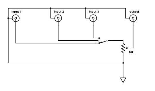

You may not need any gain with only CD or streaming sources. If that is so, try no preamp at all (a 10k volume control in a box), rather than a tube preamp.
What sources do you have?
I'd definitely go either passive, or at most a simple cathode follower stage after a pot. $500 I think is enough to build a very nice preamp. You could easily build a 4p1l directly heated tube with Colman regulators etc. But even a tube with a gain of 10 makes little sense in your power amp has a sensitivity > than 2vrms.

I figure you could make a good cathode follower-line level buffer with 3 sets of input jacks, one set of output jacks, input selector switch and volume control for not too much money.
Hammond 8" x 10" enclosure = $25 or so
Hammond 269BX 300VCT 86mA, 6.3VAC 2A power transformer = $60 or so
9-pin mini tube socket (chassis mount) = $5 or so
6N6P or 5687 twin triode tube = $10
8 pcs chassis-mount RCA jacks = $20
3 position stereo input selector switch plus 36-position stereo attenuator kit = $35 (including resistors)
IEC inlet (for AC wiring) with fuseholder = $5
DPST power switch (chassis mount) = $5
Power indicator lamp (neon or LED, as you wish) = $3
Various 1/2-watt metal film resistors = $5
2x cathode load resistors (7W wirewound) = $10
2x 6.8uF polypropylene film output coupling caps = $15
2x 0.22uF film caps = $2
3x 220uF 300V electrolytic caps = $18
2x UF4007 rectifier diodes = $2
hookup wire = $10
That comes to $230 or so.
Did I miss anything?
