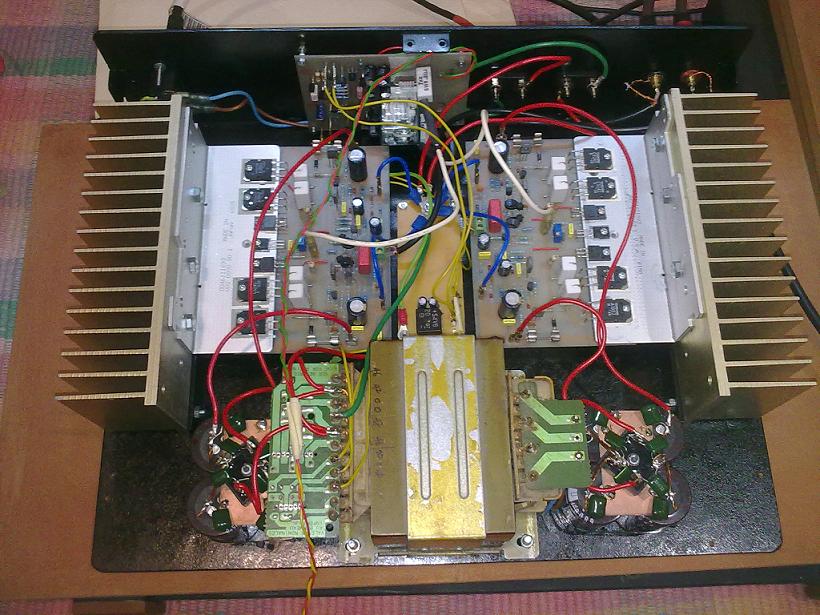

Very good sound from fellow Argentinian designer
Build this and be surprised of it's performance. Output can be any type you can get hold off.
Regards.......Raj
Regards.......Raj
wich is that amp?
