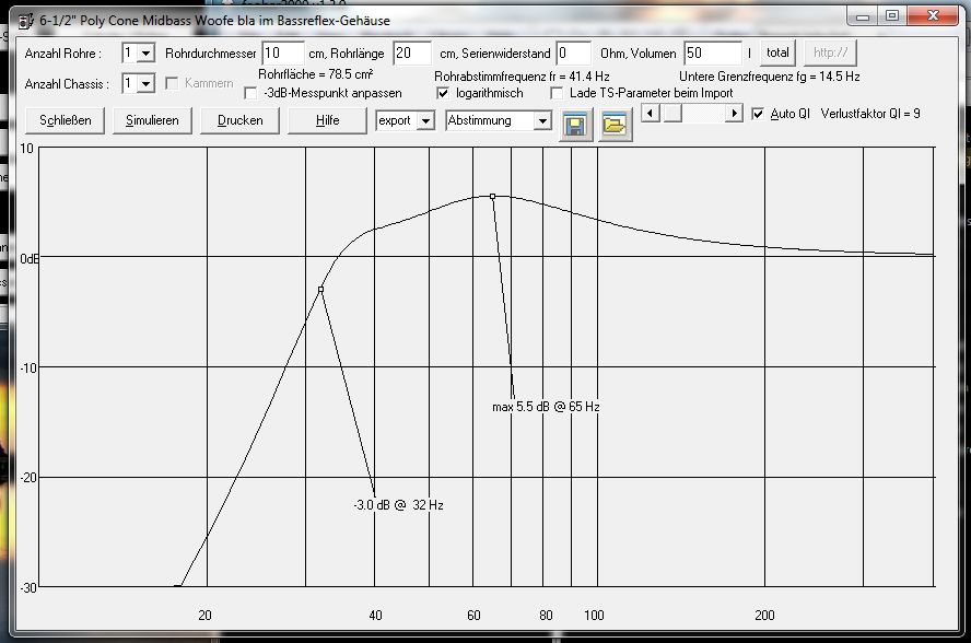

If a 2-way, try this Parts Express woofer. It's a very high value Chinese maker. At $5 each you can't go wrong with the price. 🙂 It also has a good -3dB point vented of 30 Hz and meets your SPL requirements.
It got a Qts of nearly 1 (0,95), that gives you an extremely boomy and unprecise bass, in a sealed box and even more in BR. Typical one-note-box, plays just the one in the bass. 😀
boomy and unprecise bass, in a sealed box ...😀
You're talking nonsense!
