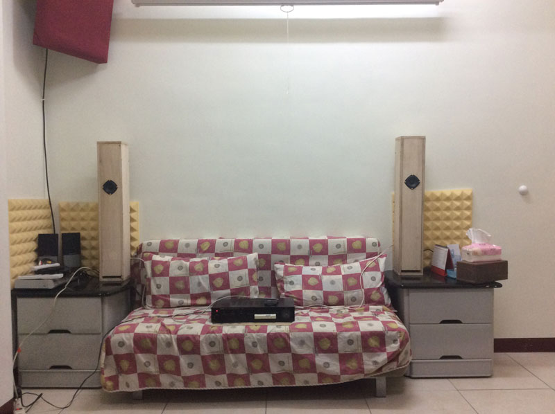

The Fountek is right in the range of the TABAQ. One of the easiest build, and it sounds great, with a nice solid bass.
Add a sub for a FAST and it would be very nice!
I even found a local hardware store that had the perfect size of wood panels... didn't even need to cut anything besides the vent, the top and bottom boards. Made the pair in a single day.
