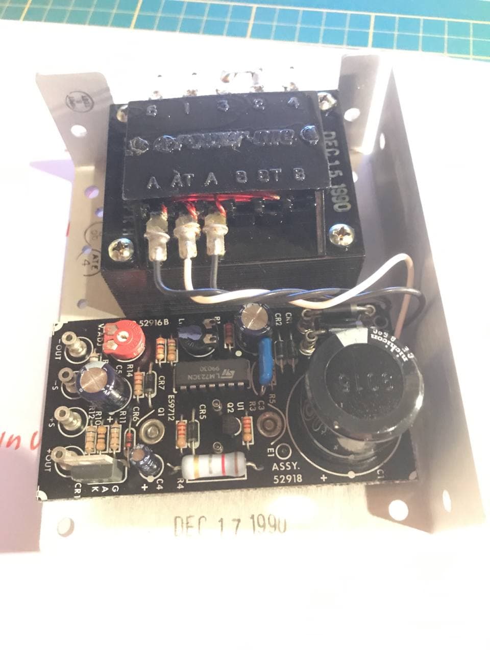

Just picked up 3 of those from a local guy for €10 Ive seen these under four brands already. So i dont think that module is actually made by Huges, or there was some defacto standard for these kind of modules.
It is industrial (read: military) stuff made by several OEMs, that is why they are almost identical. Old but good, no LDO and one needs a casing/IEC inlet.

Mine actually have an output overvoltage crowbar present. Which is a nice feature if you want it to be bombproof, The 723 is a giant of a regulator kit too, said to be immune to RF which is nice.

I think they all have the crowbar circuit. LM723 is very low noise even compared to todays regs but noise is only specified from 100 Hz to 10 kHz. Todays regs are much more wideband .... Please let's write stuff as intended. 5V 3A it is. Today I visited a flea market where I found a few linear PSU's of which one is a 13.5V 2.5A. They are not all scrapped it seems 😉
