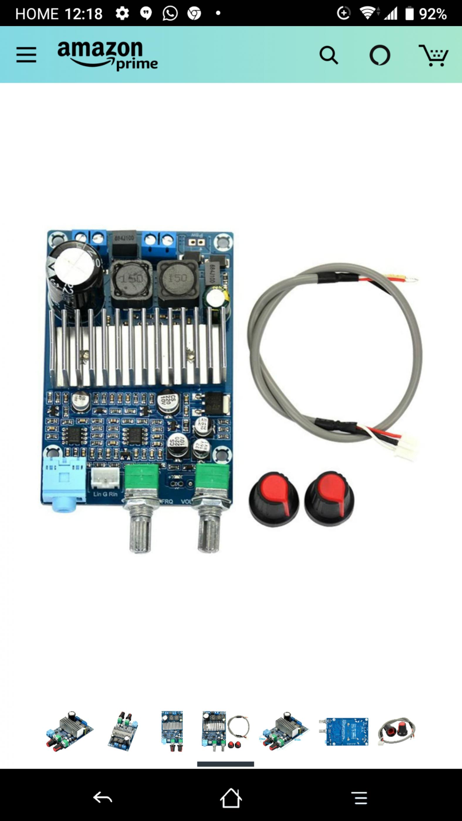

I recently bought a subwoofer amp and wanted to know what I need to hook up to AC? It's came with a clip with wire I assume that for AC wiring. I using it for bass shakers on a recliner chair. Voltage is 24. Attached a pic and link. Thanks.
AOSHIKE TPA3116 DC 12-24v 100W Subwoofer Amplifier Board Support Bass Output Digital Small Power Amplifier Board Video Audio Accessories https://www.amazon.com/dp/B01N5DGK3...abc_4QH88B6KVERK9H3Z1XGS?_encoding=UTF8&psc=1
Datasheet page 9: 60W@6ohms but quite often the chips are not sufficiently cooled so it´s questionable if that is reached.Thanks Jim and with 24volts? 75 watts?
Most probably yes with music; sine wave testing, probably not.
