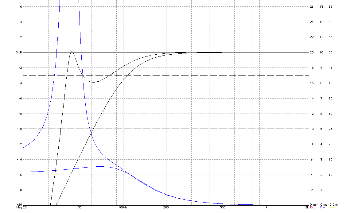

Ye gods, War and Peace. ;)
Skimming it only, it's roughly what I'd expect at this level of AI, and I'm not sure I'd want AI to be any 'better' anyway as we're getting into a deeply ominous situation for humanity in general. Quite a responsibility, creating a self-conscious lifeform.
Be that as it may, there is no Alpair 4 of any kind, although CHN40 exists (story behind that, which I can't go into -nothing questionable, just commercial information).
From a quick gander on the first part, it's spitting out values based on fairly basic mathematical alignment assumptions, probably QB3 & Butterworth sealed without accounting for damping, box leakage etc., nor external electrical factors such as series loop R, amplifier output impedance etc. It does appear to 'know' that other aspects such as desires / requirements for different tunings to suit different conditions are significant -while not at present being able to do anything about it. Whether it can or not in the short - medium term is open to question. I suspect it will get better, but probably not as good as an experienced human designer, as this starts to move into areas that don't necessarly have a single, or any, 'fixed' answer / answers, but require a creative leap in thinking & overall system analysis. That isn't necessarily difficult for humans -setting aside false modesty, but also speaking honestly, if I can do it to a reasonable level, anybody can. But -and it's quite a big one- that usually comes with, and requires, a good few years worth of real-world experiance, and understanding some often fairly abstract fields that are not automatically / directly linked to basic mathematical cabinet alignments. For instance, we can think on acoustical scaling, and how we deliberately manipulate responses in various ways to achieve given results, or equally important, the impression of given results: an axial FR or given alignment doesn't tell you everything and can even be quite deceptive. There's a number of reasons the LS3/5a has an (originally designed) FR that looks the way it does for e.g., but they aren't really to be found in box alignment mathematics. It's always a good example, because whatever you think of it in general, or specific aspects, it was a brilliantly conceived piece of design for its intended application, and in that application, it sounds as neutral as distilled water -or as far as possible with the drive units available. That isn't necessarly what it sounds like in other conditions, or looks like on a straightforward graph though. The NS10 -there's another good example. A terrible speaker in many ways, but in the right situation, with knowledgeable people behind the desk, a useful studio tool. Used badly -it can be responsible for some shocking mixes though.
Anyway, digression over -some of those values you wouldn't want to do. A 2 1/2in driver in 18+ litres doth not a happy combination make; it's what the bald mathematics says due to primarily the Q value if you're simply using something like a stock QB3 / B4 nominal flat, which it doesn't appear to realise can only realistically be achieved if the driver parameters fall within a specific (relatively broad, but nevertheless) range of values; if you go outside of those, the alignment isn't actually adhering to that nominal any longer -it just gets as close as it can, which usually isn't very. In any case, power-handling for a driver of that size in that volume would be catastrophic -one of those 'don't go there' areas if you don't want to risk blowing the thing.
It's also mirroring the use of the word 'optimum' without actually establishing what is a contextual optimum -there isn't really any such thing except if you're defining it to a specific target. Overall, I'd say from that it's not making a bad fist of attempting to distill something workable, but it's limited by the source material and the more abstract aspects of design that aren't directly linked to, say, baseline alignment formulas.
Reactions: 1 users

  • Free-air resonant frequency (f0): 97.4826 Hz
  • Equivalent volume of air compliance (Vas): 1.1523 Ltr
  • Total Q factor (Qts): 0.6429
  • Effective radiating area (Sd): 0.0023 m²
  • DC resistance (Re): 6.8 Ohm
My sim say sealed is 5.5 litres, but it should be a bit smaller due to damping.
The vented alignment is particularily bad. The driver is not well suited to vented.
ChatGTP gets a “F"
