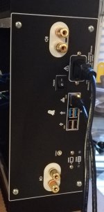

Custom panel individual banana connectors, Schaffner fn9226 ac pcb reception. My power switch controls a smps and relays control the start and high power. The only wires are the transformer and the HDMI jumpers from the pi to the chassis plate. Everything is pcb mounted. I love my Schaffner.
Edit
Also TR5 cartridge fuses, pcb mounted.
Edit
