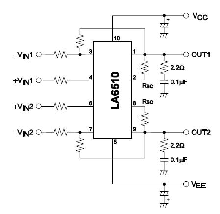

Next: LA6510
-Has 4R9 on the line below. Not sure if that 1A output current is considered good or not... As the datasheet image show, it has a small metal, what I'll call "mono-fin heatsink" stick out the top with a hole. So if it is a decent choice I can probably sink it if that'll help any lol

I've decided to give the LA6510 a try, basically just to see if I can even get it to simply work. That being said, the two thing I don't understand on this sample circuit in the datasheet are: the "Rsc" label which I'm unsure of it's meaning/function, and then what value one is suppose to use for all of the resistors that are marked

Try this datasheet, it's not just a summary like the one you listed, it's from Sanyo:
http://semicon.sanyo.com/en/ds_e/EN2624E.pdf
It explains the values for Rsc at the end.
For all the other resistors, it just looks like a dual op-amp, so if you treat each half like an op-amp, the resistors would set the input impedance and the feedback (ie gain). You'll want the input resistors (+/- VIN1, VIN2) to be somewhere between 10k and 50k (try 25k to start?). Set the feedback resistor from that.

Yea I had just came across that datasheet last night, which was 100x better than the previous one I had!! Not only was it current, but the images were clear and it provided far more info.
So I take it RSC is backwards for Current Sense Resistor?
As far as resistors themselves though, I would've though to use 100Ω based on all the sample circuits in that datasheet

Yes. Those samples are the circuits they used to measure the device's characteristics and are not functional for normal use. 100 ohms is WAY too low for the sources you would connect to an amp.
You are correct about Rsc. You should set the current limit fairly low to start with, then increase it after you are sure the circuit works.
