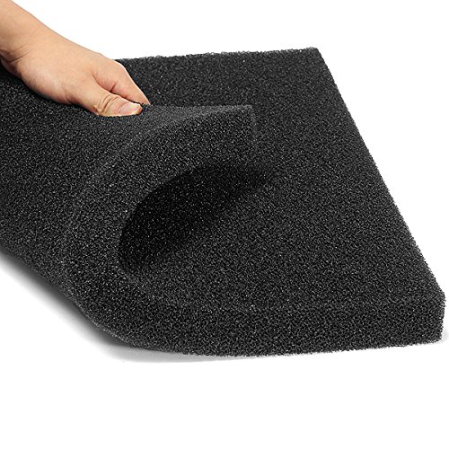

I have a TAD 2001 where the foam is old and loose. Does anyone know where i find such foam?
And what kind of glue do i use towards the dark grey felt mat?
If you read the description, it's flexible to fit air filters, etc.

Probably the best available foam for the compression driver rear chamber would be basotect (melamine), much higher absorption coefficient than 30 ppi open cell foam.
