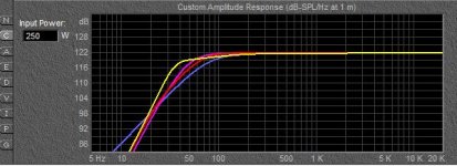

well i would simulate it. which i did ever so briefly. depending what your requirements are as far as spl and extension, the driver simulates ok. i'd suspect 5mm-ish to be the cutoff for excursion so the vented alignments would benefit from a high pass to protect them.
blue - approx 2.5 ft^3 sealed
red - approx 2.5 ft^3 ported tuned to 38
purple/pink - "maximally flat" ported
yellow - "extended bass" model
not a home theater monster by any means but should provide fairly decent results (within reason) for "standard" music

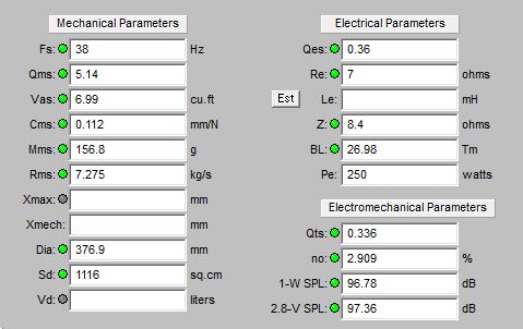

EDIT: I've been trying to plot the Atlas 18 into WinISD, but I don't know what to fill into the missing parameters. :-/

depending on the type of material you play, a high pass filter could/should be used to protect the driver from overexcursion. excursion rises rapidly below port tuning, with the above speaker this is in the 40hz range. if you listen to edm, or even some popular rap/hip hop, there is content below that range.
box volume, as with most things design related is a compromise of what you are trying to achieve. ill keep away from too many broad generalizations and suggest simulating the driver in various configurations. ultimately you may find the compromise that suits your needs/wants. in the example you gave though, the 120liter enclosure loses a bit "up top" in the 80-120hz range but gains a db or so in the lower octaves. you also pick up almost 2 cubic feet of box.
enter compromise. is the dB of low end worth almost doubling the size of the enclosure?
most of the missing parameters can be calculated from the info given. here you go:

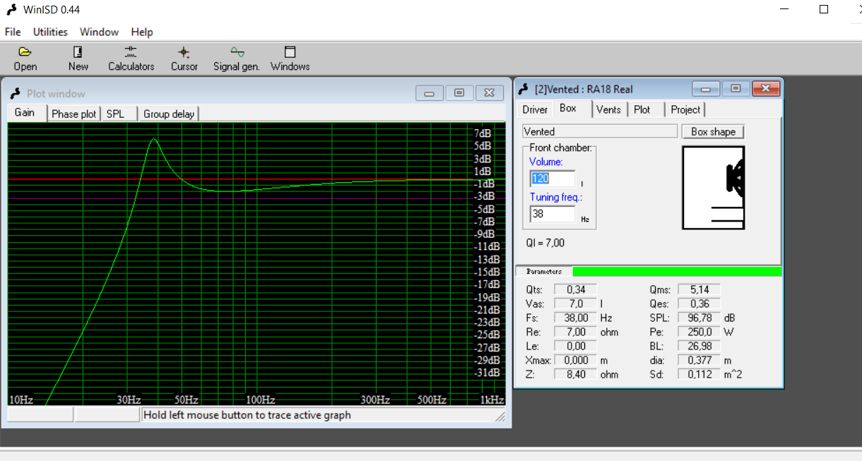

I still can't WinISD to project properly. This spike keeps appearing whenever I raise the box volume above ~5 litres.
The reason for the different enclosure volume is that I've one lying around, which I was wondering if could be used, if the ports were tuned to the correct frequency. 🙂
look at your Vas measurement
Ah, damn it. I'm sorry ...

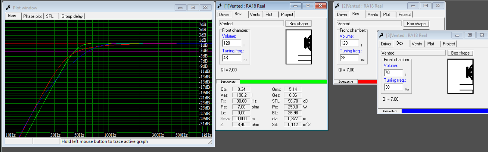

Is 46Hz a good tuning freq? Sounds a little high to me, but it seems to have a flatter response? Falls short below 45hz compared to 38hz, though.
Depends on your music.

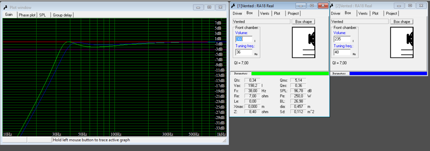

So I've decided to go for the RA18 unit. I have some doubts about the box volume and tuning frequency.
Is a -2db drop a lot at around 60-80hz? See attached image.
Which of these two box sizes is ideal, when I already have a pair of 15'ers as "tops", which should (hopefully) cover the 60-20k hz area?
Basically; when is a drop too big?
