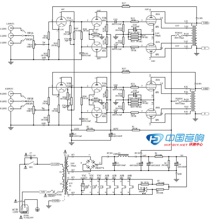

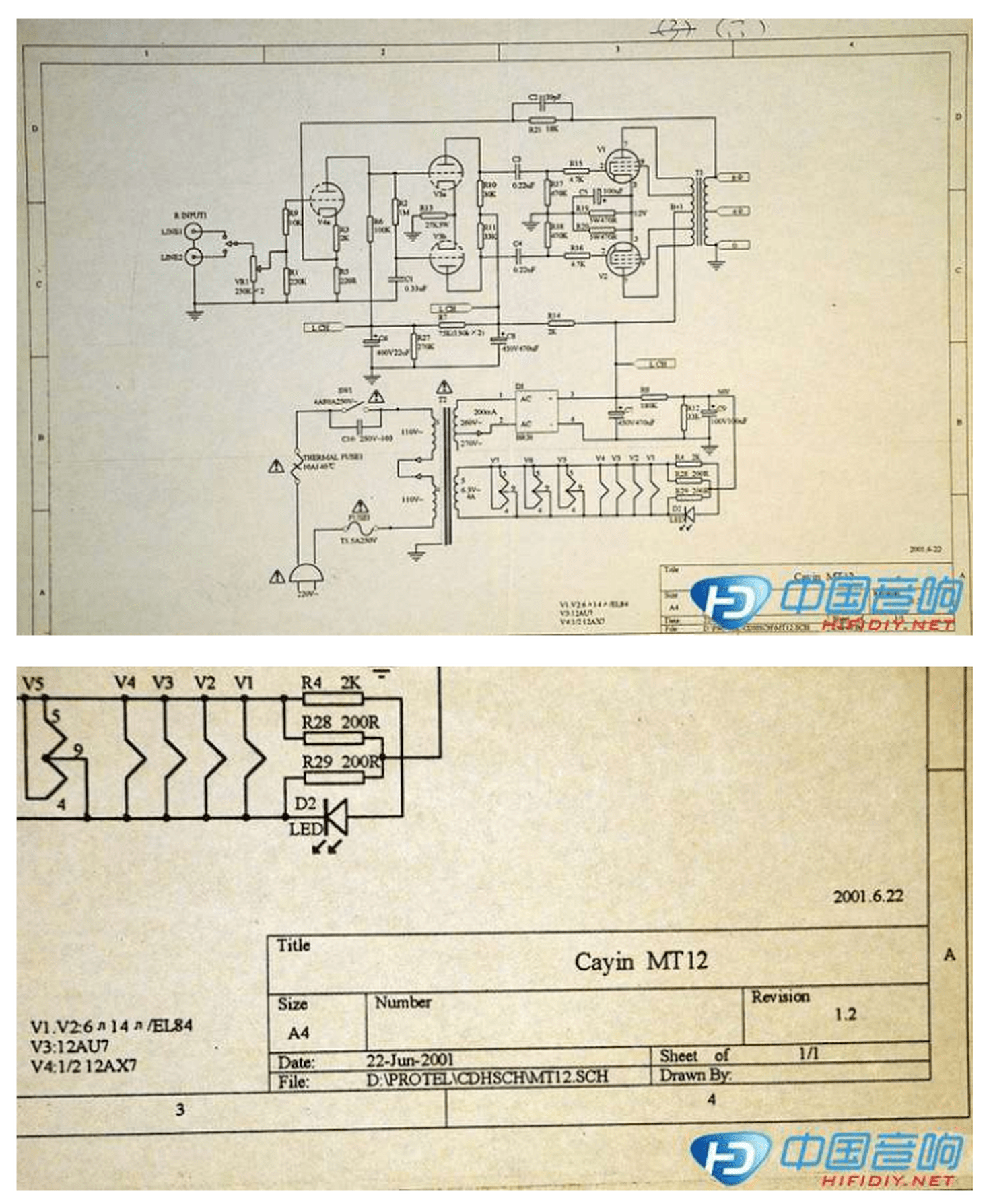

Without a diagram it's not easy but there are chances that the Cayin is more punchy than the Reisong but can be less fine but it's not even sure because there are also chances that the iron of the Cayin is of better quality than the Reisong.
