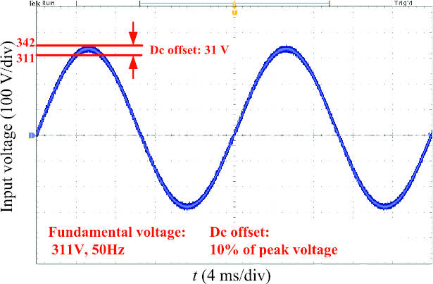

Will try to reduce dc bias. But visually what exactly is dc offset or bias.
It would be hard to measure offset using a waveform, unless the sine amplitude is 100mV or less.
The whole waveform would look moved up or down, and not be symmetric vertically about the zero line.
Instead, just short the inputs and measure the DC voltage at the outputs.
