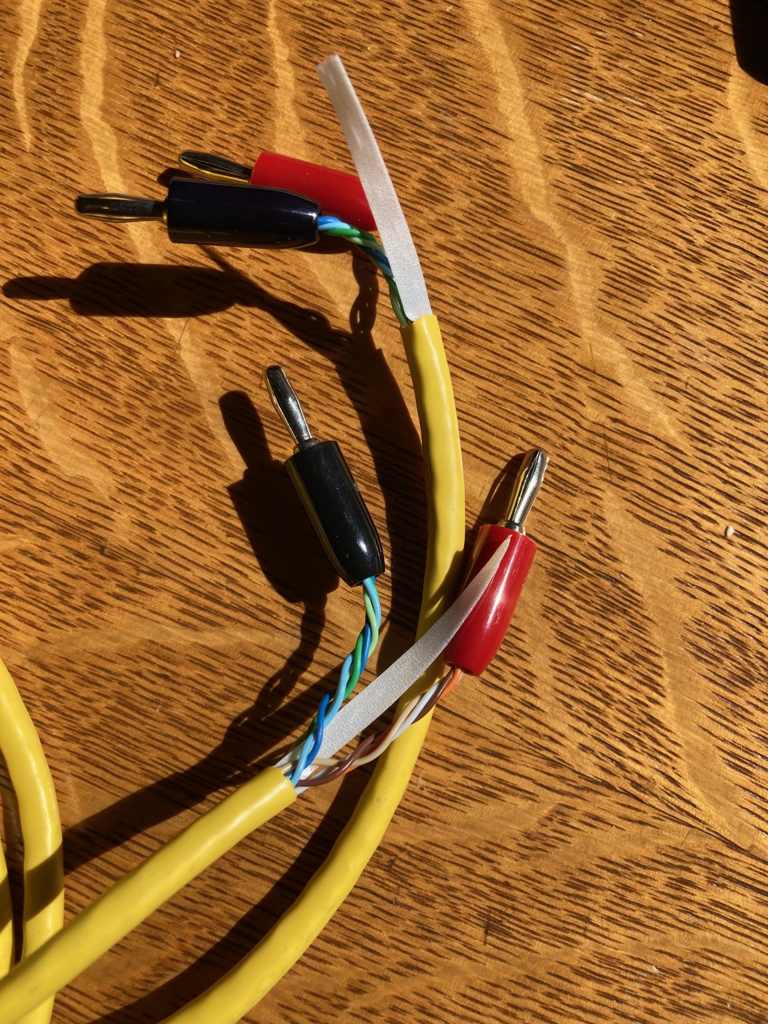

Okay, so if one keeps an 8-strand CAT5 cable bundled together, how does one wire the twisted pairs? Two pair in parallel for positive, two pair for negative, or one of each pair for positive, and one of each pair for negative?
Interesting question and reminds me that Belden 1192a star quad cable data sheet specifies what wires should be paired. The four 1192a conductors are tightly twisted but not as separate pairs.
FWIW I made a pair of 6' speaker cables this way, by using two pair for positive, two pair for negative. They didn't sound good to me, but it wasn't a single-variable comparison- I had no easy way of swapping in normal cables. The other ends of these are female spade lugs.

Use the solid colors as positive and the striped corresponding colors as ground. You can join two solids and two corresponding stripes to make one rca cable. Total of four conductors per rca cable. The twisted pairs should be maintained to make the wire do its job. If you use Orange plus Orange/white as positive and Green plus Green/white as negative you lose the advantage of twisted cables. You obviously have no shielding but if you are ok with that go for it. Cat5 works better as shorter speaker wiring than interconnects.
