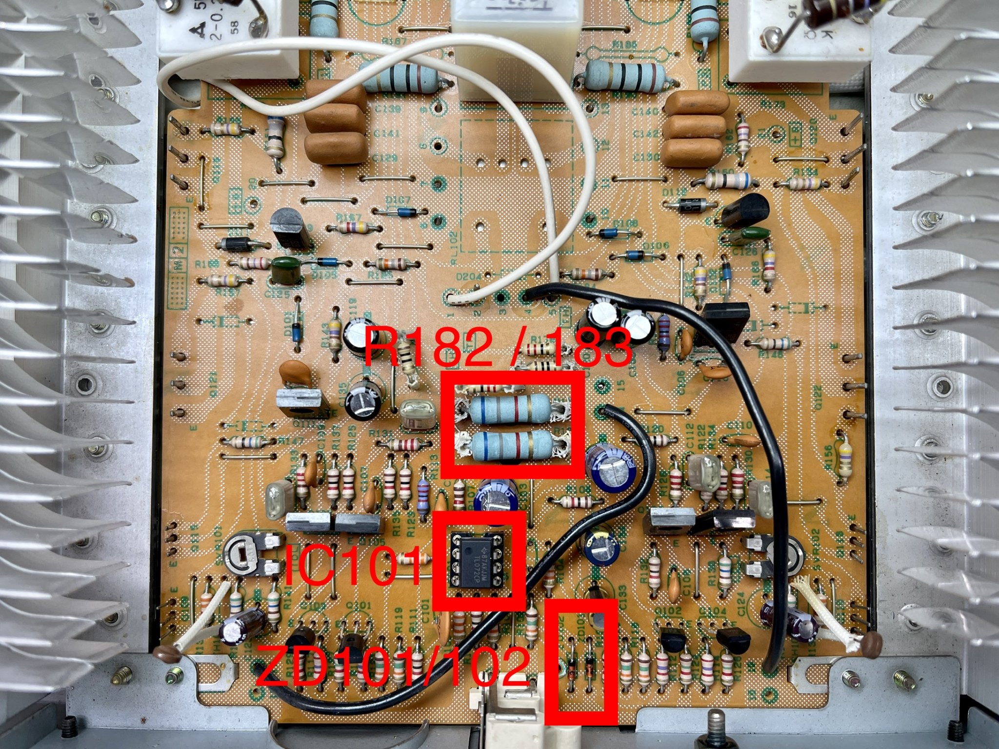

I've been working on and off on this M-500T that I just can't seem to fix, primarily because I just don't understand the circuit. Hoping someone can help.
Initially the unit was not coming out of protection. I was able to resolve that by fixing cold solder joints. Ended up re-flowing the entire mainboard and power supply. All output transistors check out, out of circuit on my Peak meter. Once I got relay click, I installed new caps on the mainboard and the smaller caps on the power supply. All voltages from the supply are there at the initial measurement points, but then it starts to change halfway through the schematic, which I also don't really trust because it already has some mismarkings at the power supply, but anyway...

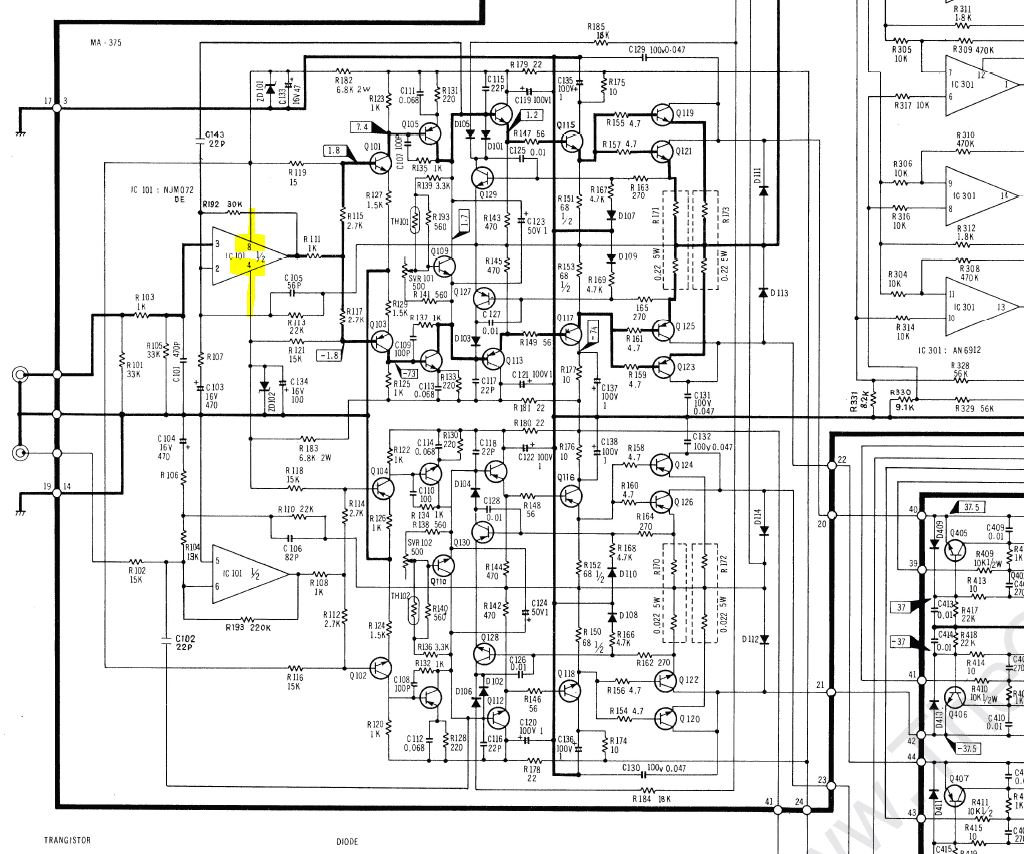

I don't understand the switching power supply and how it works. And i don't know if it's relevant to the issue I'm having, but basically I'm supposed to be seeing a + and - 14v at IC101 at pins 4 and 8, and I'm not. i'm getting around .6v +/- which goes up to maybe .7v if I connect an input signal. I've pulled both zener diodes and checked them and they read fine. I'm presuming that if both voltage rails are missing at that chip, then it's something that would be tied to both and not channel specific. That's what I'm having trouble finding. I'm seeing 74v and 43v +/- at points on transistors where I should be only seeing less than 2v.
This is my last ditch effort to try figuring this thing out. I'm attaching a pic of the area of the schematic where I'm supposed to see the voltages, for what it's worth.

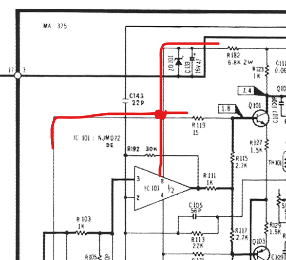

The chip IC101, Zeners ZD101, ZD102, or 6.8K 2Watt Resistors R182, R183 could be toast. Note R119 is 15K, not 15.

The collector of Q101 shows 7.4? but it should be about 73 Volts. If the base is also ~73 Volts then Q101 is shorted.

You must resolve why you are not getting the supply to the opamp first.
R182 and R183 should feel 'hot'. If they are cold (no voltage on them) then check the 22 ohm feeding them (R179 and R181). If those are open then most likely you have a fault around the transistor stages fed by the 22 ohms.

Forget the transistors, concentrate on the opamp supply. The only thing that comes to mind is that either the opamp is faulty, ir it is an incorrect type that has been fitted, or there is a physical short... or the Zeners are in back to front. That would give a supply of -/+ 0.6 volts. Check the Zener orientation.
Edit... the Zeners if fitted back to front would give the voltages you are seeing on Q101 and 103. They can be replaced with any 0.5 or 1.3 watt 15v Zener. In use they dissipate less than 0.1 watt.

Just to be sure the end of the Zener that goes to pin 8 (+ opamp supply) should be the end with a stripe and the Zener that goes to pin should have the non stripe end connected to pin 4.
R182/3 If they are hot they are basically OK, They are dropping 74 volts by your measurements and so they dissipate 0.8 watt. That will heat them quickly. If they are cold they are faulty.
If you have doubts just tag a 10k across them, even a half watt or quarter watt will survive long enough to prove the point.

One thing you could try is to remove the opamp and see if the rails come up. They have to because there is nothing else low impedance connected to them, just the opamp and the 15k's.
This gets more interesting then...
The circuit shows there is nothing else connected to those rails.
You have to be logical. I would look at the print from the resistor to the Zener and make sure nothing else (that might not be on the circuit) connects to that print. Follow the print to the opamp and again make sure there is nothing else. I know there are the two 15k's but they can't load anything. There are the two caps across the Zeners but both faulty... nah but you have to remove them and test again. It will work fine without those caps as a test.
The feed to the left goes to another 15k (R119 has a typo, 15 rather than 15k).
Just saying this without thinking it through... is the opamp in the right way around ? Could the Zeners be marked the wrong way around on the board?
There is nothing here that can pull the rails down. The -/+ 0.6 volts is suspicious as it is exactly what you would get with forward biased junction.
