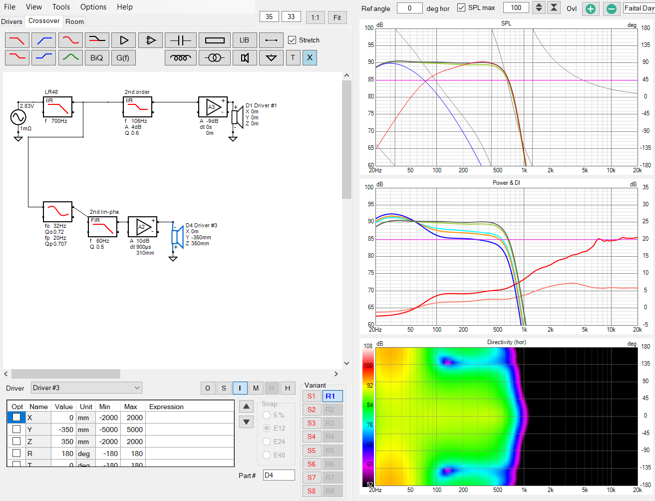

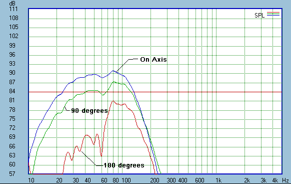

Same with a true dipole woofer. 2 to 2 1/2 octaves is pretty much the useful limit. Any more that that and EQ becomes excessive and the high excursion at low frequency gives rise to IM (or Doppler) distortion. Years back I designed the CRAW that was based on two woofers with delay. The delay was achieved with a passive network. Craw woofer
I'm interested on your application? Since high frequencies in general are not problem at the back, they beam from the driver or are effectively blocked by the baffle. This is of course related to the size of the transducer and the baffle. Use big or small depending what range you need to cardioid.
For good attenuation at rear you need both sound from the front and the back of the driver so it is long wavelengths only, that bend to the back from the front, around the baffle corner. If them back and front signal meet and are both equal other than opposite in phase they cancel, as with dipole. With delay on the back signal the null is steeded from side (dipole) to the back (cardioid) or anything in between.

All the different modes in the W371A are created by changes to delay and EQ, the null steering seems the least useful to me.
The principle is pretty straight forward, the big woofer and baffle does a lot of the directivity control to 300Hz the cancellation does the rest.

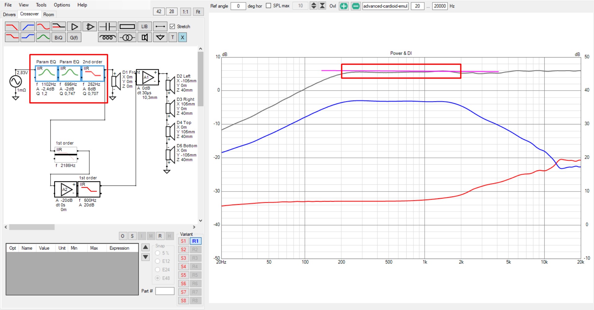

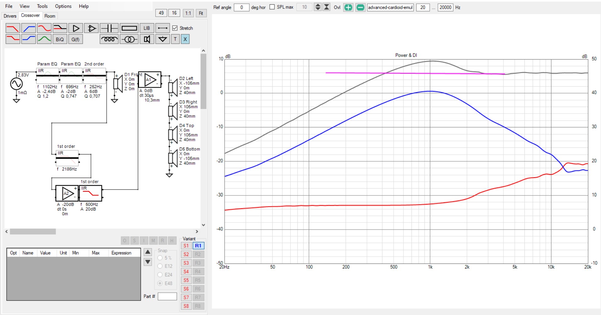

It looks like there is ~2 octaves ~400Hz - 2kHz without EQ at all? With 6db shelf and flattening the dipole peak there is 3 octaves of flat (cardioidish in this case. It is not cardioid, deepest null around 130 degrees). This is not measured but ideal 8" driver with simulated side ports and what not, tries to roughly emulate real deal. It is not too far of what you guys are saying, but isn't the dipole peak already around 2 octaves in reality as well?

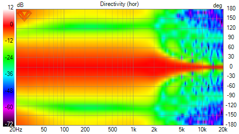

First showing just the emulated passive "cardioid" box. The second one adds filters to tame the dipole peak and add some low boost. Third image is normalized polar map.

^ The box and a large radiator will control dispersion above "dipole peak" in your sim, and keep DI flat and cardioid (or supercardioid).
In open baffle there will be "axial dipole null" where DI is practically zero, and above it DI gradually gets higher.
The lower end of usable response depends on distortion behaviour of the driver and spl wanted. In other words, on how much eq you can use.

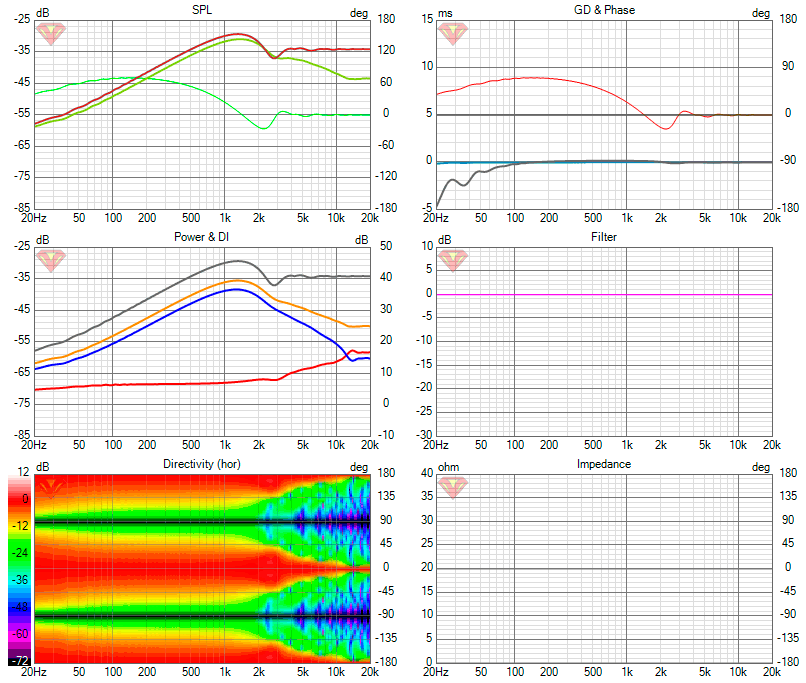

^ yes the response starts to narrow as per driver size (if minimal baffle), same should happen with dipole right? What is this axial null with dipole then, it happens on frequency band that should not travel to the otherside (since it is much attenuated, 3k -20dB to 90deg inspected from the perfect monopole)? Is it the diffraction interference dip like with monopole? It looks the same for sure. See attachment, right under 3kHz there is dip in axial response due to baffle edge diffraction.
Attachment GIF cycles between ideal monopole and dipole, 8" driver on 20cm x 20cm baffle which is about the driver size. They have almost identical axial response from about 350Hz to usable frequency, around the diffraction, maybe 2kHz. That is bit more than 2 octaves without EQ. With the dipole both the peak and dip are bigger. IF the 2kHz was the top, then 3 octaves would be 250Hz, where difference in axial response is like 3dB. Difference in power response seems to be roughly 10dB though. What you guys would refer here as usable bandwidth?

All these have been generated in VituixCAD diffraction tool, except the cardioidish stuff has the filters seen in previous post trying to signal through holes on the box.
edit. latter GIF swapped, remembered the cardioidish stuff has 21x21cm baffle and the monopole and dipole 20cm 20cm. Also the gif was too fast for the eye.

Well the ~3kHz dip, being a diffraction issue with the monopole, shows that yes sound goes to the baffle edge even though it looks to be attenuated by up to 20db towards 90 degree angle. Now, there is same phenomenon (edge diffraction) with dipole happening at the same time on the back of the baffle as well. I remember reading the edge diffraction makes "phantom sound source" but opposite polarity at the edge? In which case diffraction from the back signal at the baffle back edge would be in same polarity as the diffraction from the front towards the listener? This makes the peak and dip more pronounced than with monopole. Am I on the right track?
If so, or what ever the reason, the dipole shows more severe interference to listening window and this is usually kept outside the bandwidth, dubbed usable bandwidth, right? This is about the top of usable bandwidth for monopole speakers as well, and cardioid for that matter, due to beaming, rising DI. If the ideal is smooth DI.
