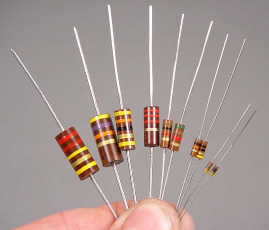

I like CCs b/c they are non-magnetic, non-inductive, and handle surges very well.
And they're just so bloody simple. No end caps and whatnot. Just lead/resistive element/lead.
Also, I think they're just plain beautiful.

Yep the AB cc's are very nice and with sturdy metal wires
Yup. And I also liked the Ohmite Little Demons but I believe Ohmite has stopped production on them and are now making ceramic compositions instead. I've been using the Kamaya's and quite like them.

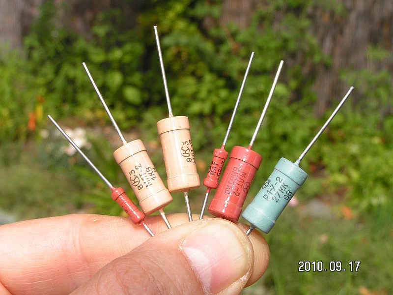

I prefer this type of resistors, except some special cases when other types due to special requirements are preferable:
They look like commie components built like tanks Wave! Built to survive GI Joe's onslaught and take over after the precision US Vishays have all melted away...
Not nearly as beautiful as CCs though.

Actually, MLT resistors indeed were manufactured for Soviet army. Non-magnetic metal film. Blue one is covered by a fireproof paint. The rest if to burn a paint stay naked. I don't mind to have naked resistors in the gear for myself (it reminds me they survived great abuse, after that are more stable and proven to be reliable), but people usually don't like them.

P.S.: Wavebourn, one more question: Up to what voltage do you trust your MLT resistors?
I use 240K MLT-2 resistor for feedback from GU-50 anodes to anodes of driver tubes (about 500V DC +/- 750V swing)
