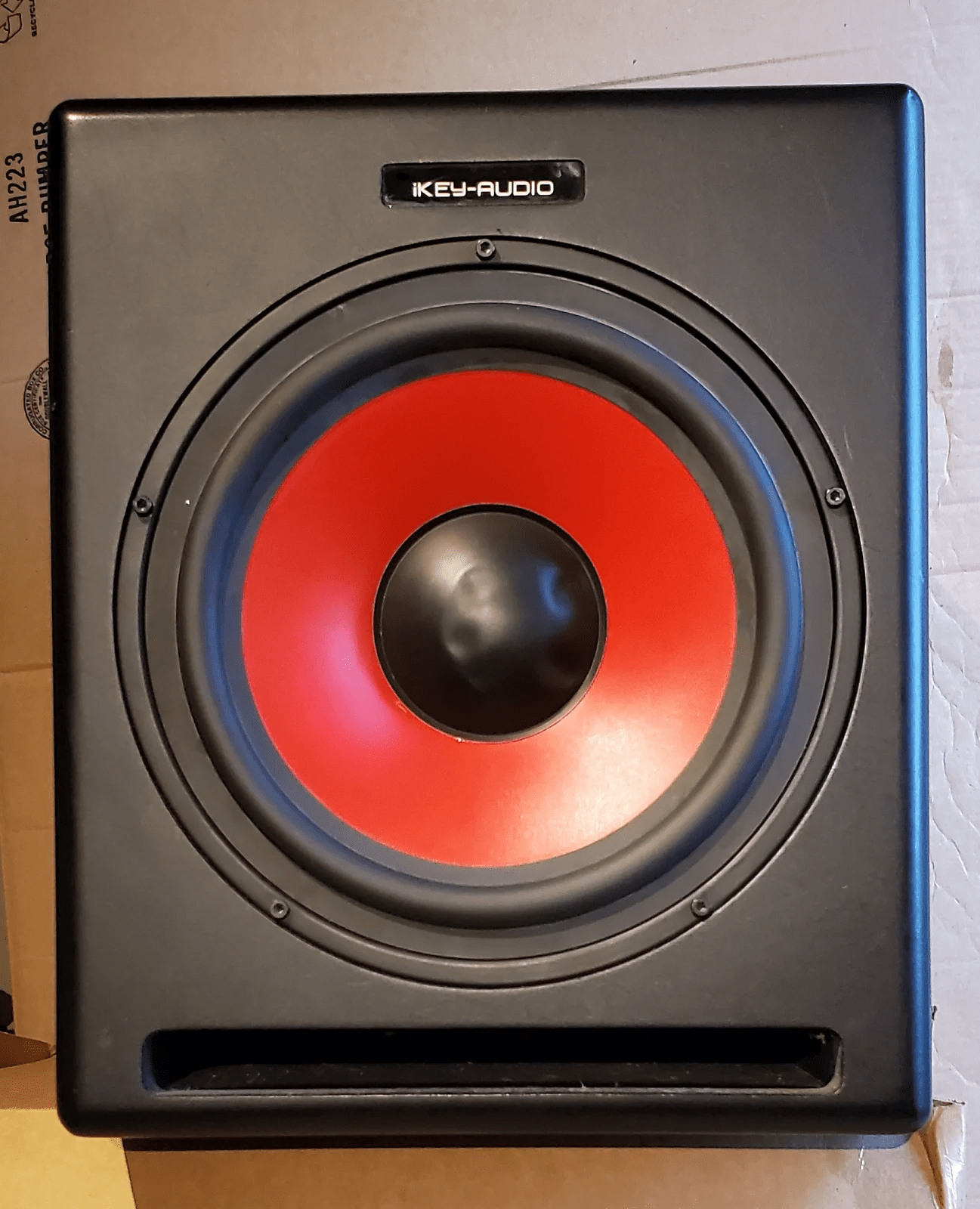

The 10" driver is from an ikey audio 10s would it be a suitable presumption to utilise the same dimensions from this sub in my new speaker design, or is it better to re calculate the size? my aim for the boom box was to have a central sub in a vented box with two separate speakers either side in closed boxes; with the aim to make this one large box with essentially three sections.

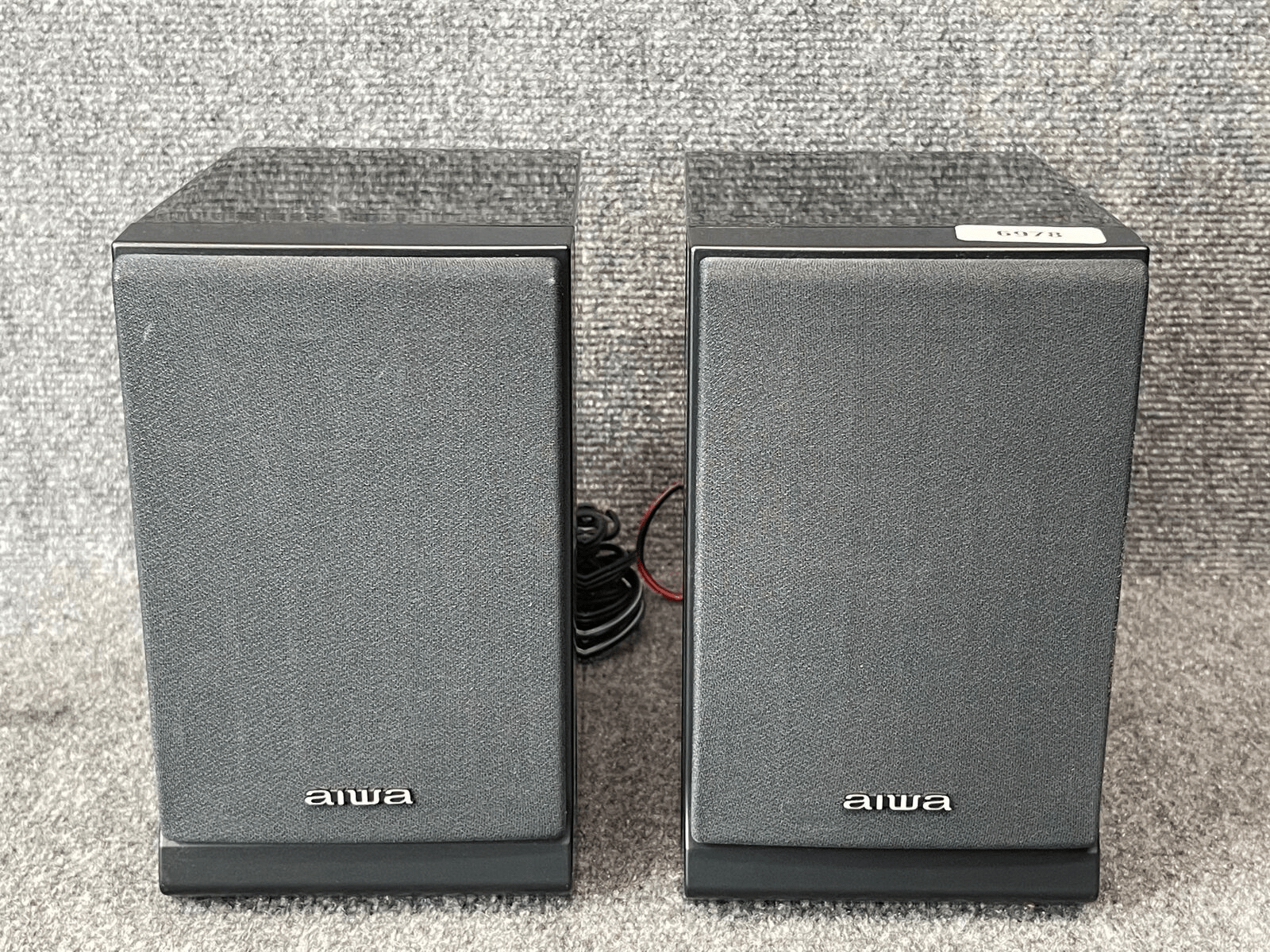

as for the 4" and 2" pair of drivers, they are coming form an Aiwa speaker system model SX-LM200. i also have the boxes for these so could i simply use the volumes provided to make.

ikey audio 10s

The Ikey 10" subwoofer driver should be in its own compartment of the same volume and port dimensions as the original.
I visualise the Awai speakers to be situated to the left and right of the central subwoofer enclosure, each occupying their own dedicated enclosure of the same volume as the original (and the same port dimensions, if applicable).
That is, it can be one big box, but with three separate compartments, sized (and vented) as per the original enclosures.
Does the arrangement I describe correspond to what you regard as "symmetrical"?
You can use either one large (undivided) enclosure (with proper bracing) for multiple speakers that has the same total volume as required by the individual speakers (2 speakers that require 1ft^3 each would be in a 2ft^3 enclosure).
The benefit of using a (properly braced) single chamber is that the porting will be somewhat easier for low-frequency ports. For smaller (individual) chambers, the individual ports will have to be longer (if the same diameter) which could be a problem. You could use smaller diameter ports for a single speaker but you'll have to see what works for the speakers and enclosures that you end up using.
