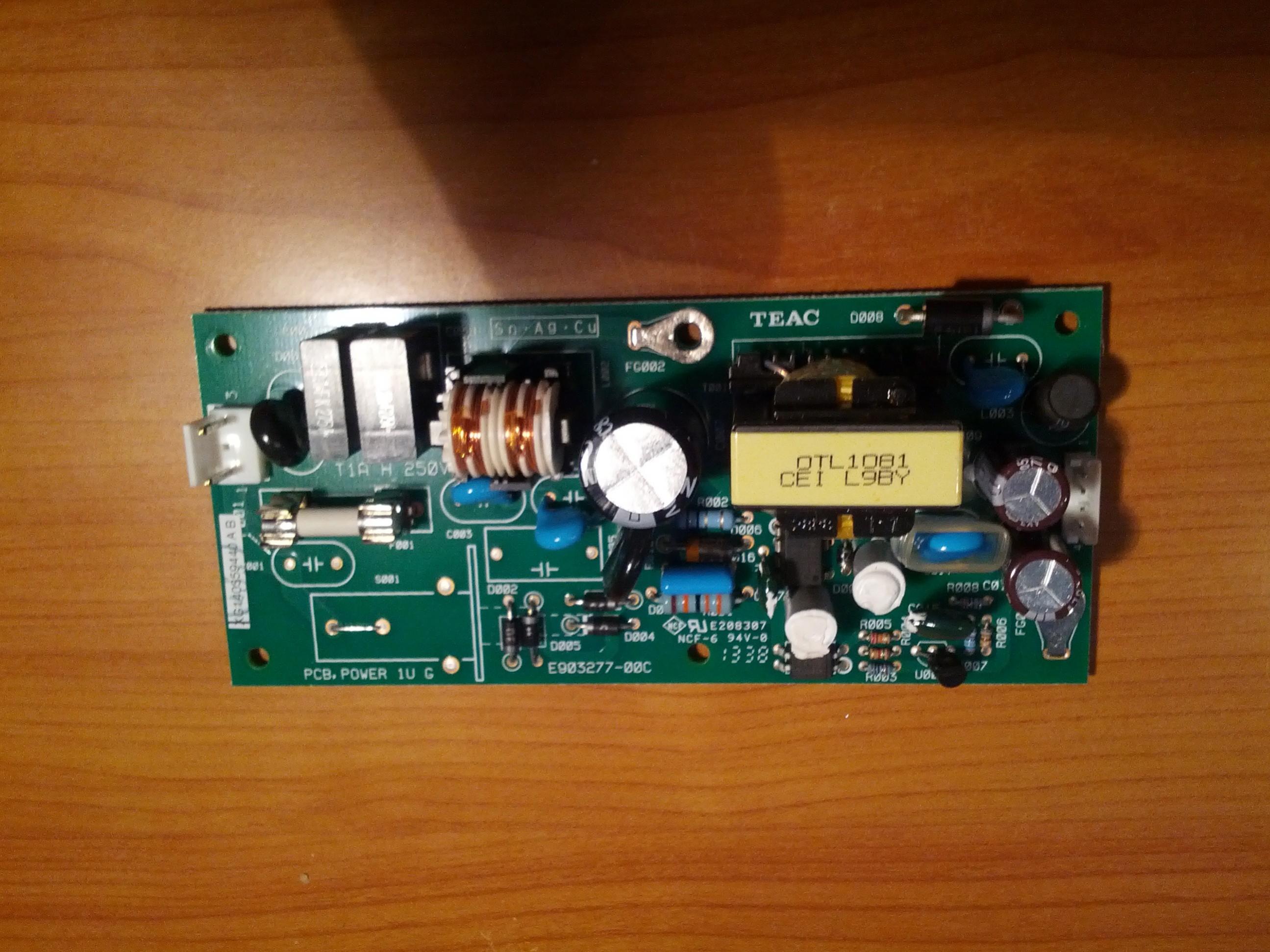

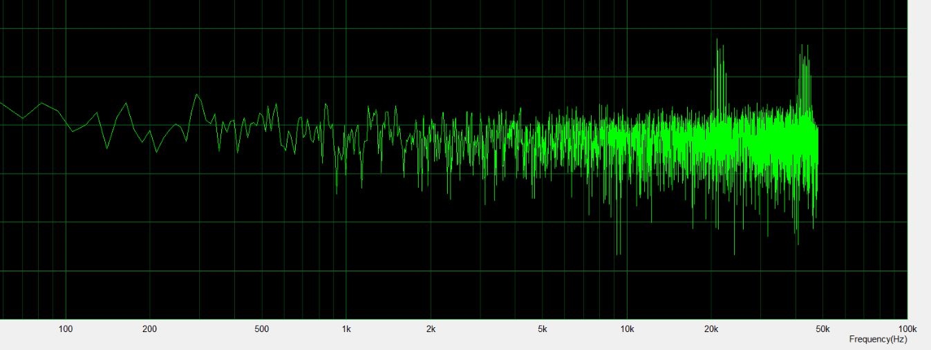

Hi !
thanks a lot for the helpful reply.
it is a hifi piece. There is a psu with output 11.5VDC/1.5A (i cannot measure the current but from the specs they say power consumption 15W) powering the circuits board.
I have used another external 12VDC psu and there is no noise issue.
The noise start from about 20Khz up at multiple Hz (harmonics ?). Not much but it is there very clearly.
From this the idea to filter a little the original psu to keep using it and not having to rely on an external and not very handy psu.
Before replacing the internal psu of course.
Even a R-C filter can help a lot, in your case R of about 1 Ohm would drop 1.5V, add around 1000uF of C and you have a good filter above 200 Hz. Normally solid state regulators have excellent input rejection at lower frequencies. Poor rejection points at a layout problem
I think 1.5V drop is too much and unfortunately i do not see any trimmer to increase the Vout (picture attached). What leaves me surprised is that even with cheap power bricks the unit does not exhibit this kind of noise.
And for sure these psu are not high end at all.
I read that 100mV pk2pk is the norm.
It is not radiated noise from the psu because i have disconnected all the signal cables on the circuit board and the noise is still there.
It is coming out from the psu. How sad.
I am thinking to buy an encapsulated new one psu and then place it inside replacing the stock one after checking for any noise of course.
I guess that an encapsulated one should be also completely shielded while the stock one is completely open frame.
Thanks a lot again, gino
Switched mode power supply common mode noise! By the look of the transformer, the switching frequency is failrly low
Hi ! thank you very much indeed for your very valuable advice.
This is very important for me because I understand now there is a design issue I have no hope to solve.
I was almost resigned to live with it thinking that the issue were instead in the circuit board and so impossible to eliminate.
Then after some searching in the web I tried another 12VDC smps by Dell, a refurbished one looking like it was coming from a garbage bin 😱. I think I paid it 10USD maybe ?
And bam ... no peaks to speak of. A noise floor nicely low and flat.
And after that others with the same result.
All very very cheap Chinese things.
This unit is intended for the pro market.
I really do not understand why they have slipped on a very trivial aspect.
From what I understand the other parts are very good.
I am thinking to put a power brick inside (they are also completely shielded and encapsulated.
I have only one issue.
If the power brick comes with a 3 wires mains in I guess I have to connect the earth to the chassis of the unit ? or leave it floating ?
Thanks a lot again.
Kind regards, gino
