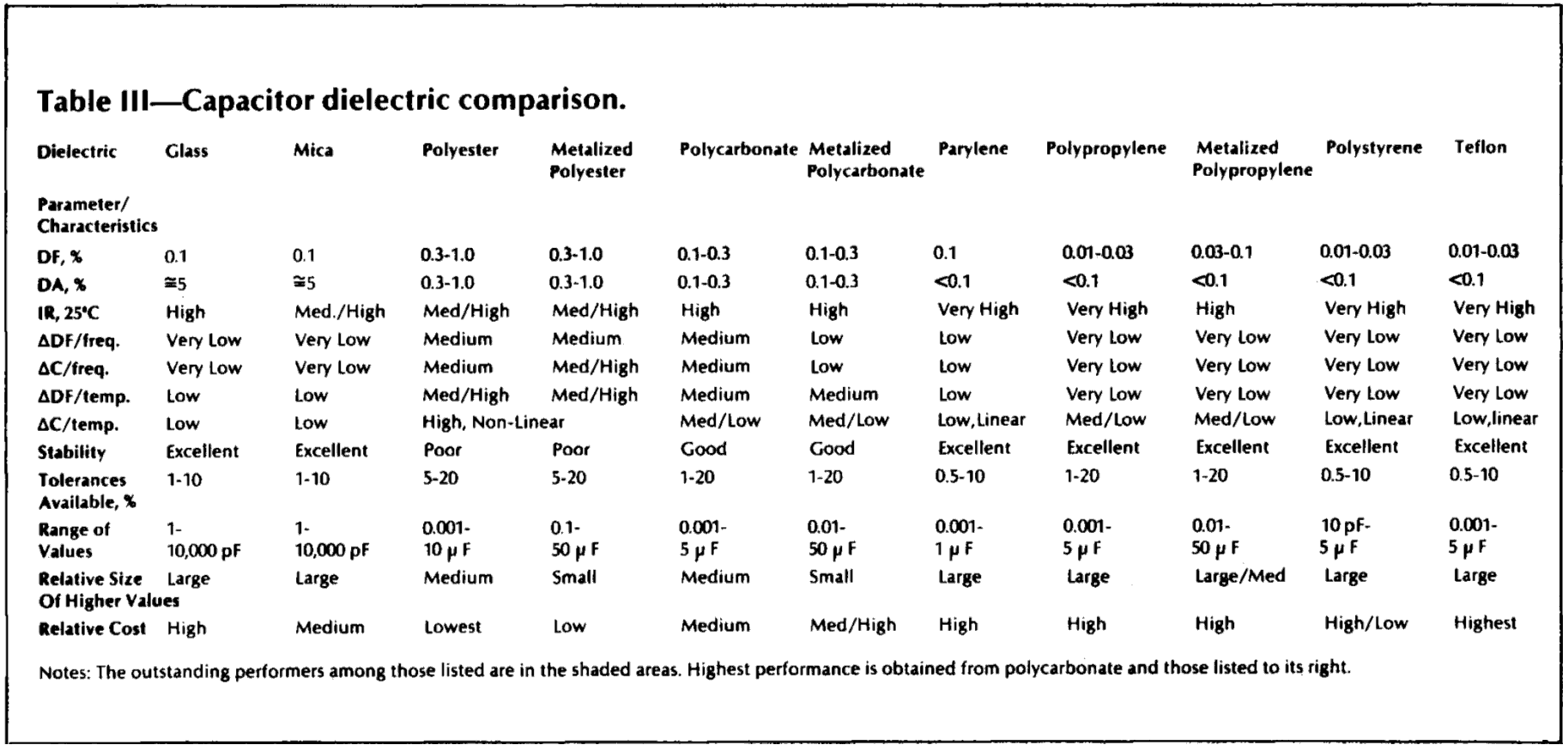

I recently bought a 12ax7 Baxandall tone control PCB from eBay. I'm a confused when trying to obtain capacitors as there are so many type and not sure of the required voltage. As the HT is 250V I'm going to get 400V+ (which ever is cheaper) to be on the safe side.
What type of cap is appropriate - wima, map, mks, mkt, ceramic disc, CBB etc.. For
100pF, 4700pF (tone control)
O.1uF, 0.22uF, 0.33uF(coupling)

Polystyrene would be the best for tone caps.
Polypropylene (mkp or mpp) or paper-in-oil for coupling are good but you may have to check the size will fit your PCB.
Polypropylene film is generally best for most positions. Polystyrene is an excellent choice for tone controls if available. Polyester (PET) is okay in audio applications only if the voltage rating is far in excess of requirements.
Between different types of poly film caps, I find that dogma about the dielectric is largely just dogma. There are good and bad caps for each design with each dielectric.
Wima caps are good, but not as good as the hype would suggest.
A coupling capacitor from the anode to the tone control should be able to stand HT, the rest is not important. Polystyrene are best suited. Don't waste your money with oil and paper, if they were that good, they would still be making them.
Wima is a brand, not a type. Avoid ceramic disc, as they are usuall high-k and so nonlinear. For most purposes polyester/mylar are fine for coupling. Polystyrene are good for filters, as are low-k ceramics (e.g. NP0, C0G).cl1238 said:What type of cap is appropriate - wima, map, mks, mkt, ceramic disc, CBB etc..

Electrolytics should be replaced if they're old and weren't used much (the applied voltage apparently maintains the integrity of the dielectric over time, and lack of it allows deterioration). With regular use, I've got many electrolytics that still work great after 30 years. Some ceramic caps are significantly non-linear and temperature sensitive. I only use those in the power supply circuits (a .01u 3kV across the AC line and across the primary and secondary power transformer winding). Most plastic dielectric caps are fine. I try to use polyprops or polystyrenes when I can, and go with other plastic dielectrics (mylar etc.) when I can't get what I need in PP or PS. The bigger issue might be the manufacturers. Most are fine, but there may be some "boutique" brands that don't really know what they are doing. In a tube circuit, make sure the voltage rating is more than enough at turn-on, when B+ is significantly higher than when the tubes start conducting, and load down the power supply.

i prefer silver mica than Polystyrene in coupling application more natural Highs for me .. cheap to try 🙂
