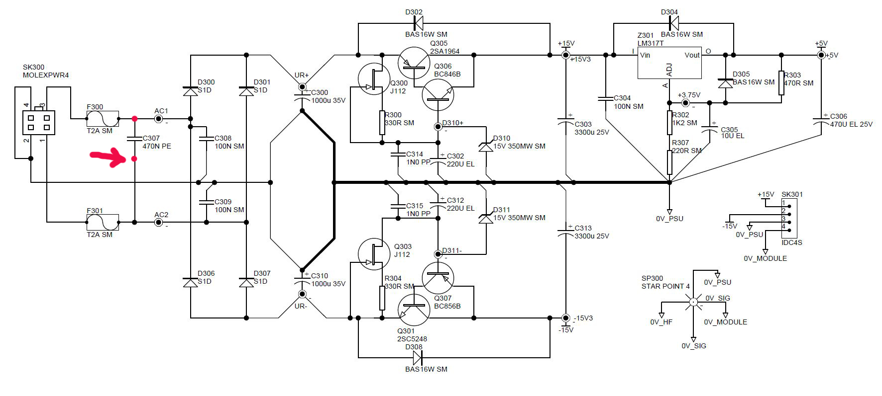

In this situation circuit
C 307
470NF
I know two rules in this situation
1) The outside foil facing
The lower resistance in the circuit
2) the outside foil facing ground in the circuit
In this situation are there different rule ? C 307 -470NF

That's an AC circuit, so either way is ok. You do have ground loops as shown.
The positive and negative supply grounds should be separated.
That's an AC circuit, so either way is ok. You do have a ground loop involving the input common.

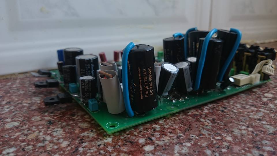

I went back to work on my old arcam amp projectYour 15v3 rails will have 14.3 on them as you have the BE junction to consider.

In some countries, one of the AC mains terminals (AC1, AC2) is wired to 'Neutral', and the other to 'Active'. The Neutral is bonded to protective earth somewhere nearby, and so the Neutral effectively has very little AC voltage on it relative to amp chassis. If that is the case then 'Neutral' side of C307 would preferably be the 'outside' foil.

Rule 2 is merely a particular case of Rule 1.dazzz said:I know two rules in this situation
This rule applies to capacitors in sensitive positions in signal circuits. Your C307 is merely in an uncritical position in a PSU so no need to worry about such matters.
thank broRule 2 is merely a particular case of Rule 1.

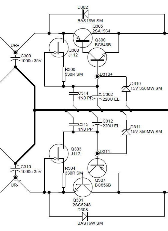

I Thinking to increase capacitor value
C300
C310
How much
I can increase the caps value safely ?
You can increase them a bit, but no advantage in a big increase and some possible disadvantage. Why do you want to change them? Did the original designer get it wrong?

Normal mode power supply based only on voltage regulators like LM317
I certainly would increase the capacitors to improve the ripple rejection.
But because of the power supply of the preamp is also based on Shunt Regulators with the fact that I now without a lot of experience on shunt reg so I do not know what the effect of raise the caps value on the circuit.
I hope I was able to explain it clearly
Increasing the reservoir capacitors will reduce the ripple going in to the regulator, and therefore possibly reduce the ripple coming out. I say 'possibly' because in some PSUs the ripple is limited by grounding arrangements rather than cap values. You can calculate or measure the ripple, and see what improvement you need.
I am unclear what this has to do with instability of a linear regulator caused by the inductive output impedance reacting with a capacitive load.
I am unclear also what this has to do wth a shunt reg as I can't see a shunt reg in that circuit.
I still can't see a shunt reg. I see a JFET wired as a CCS feeding a zener, acting as voltage reference for a complementary pair follower. OK, you could say that the zener is a shunt reg itself - but that is not normally what audio people mean when they talk of a shunt reg. They mean an active circuit, not a single component.
