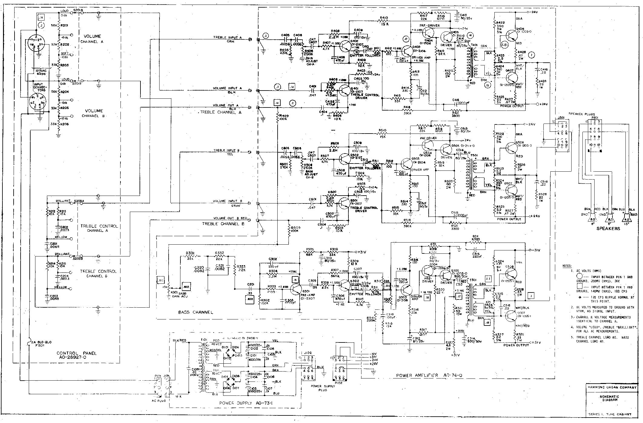

Those are what I am looking for, Mr Tandbergen. Capacitor coupled output to protect my $300 each speakers. These seem to be a bit more modern than the Leak Delta 70 or the Dynakit ST120. Please may you could provide a link or something to drawings where I can actually read the resistor sizes or something? These images don't increase much with the plus control.
Mr. Printer, if you want the ultimate in interstage protection, look at the TC-10 tone cabinet from Hammond. It has transformer interstage coupling. Right out of the GE transistor manual ver 6.

Capacitors are cheap, transformers...
Actually I just have to figure out how to do the output stage. The stages before it are simple textbook examples.

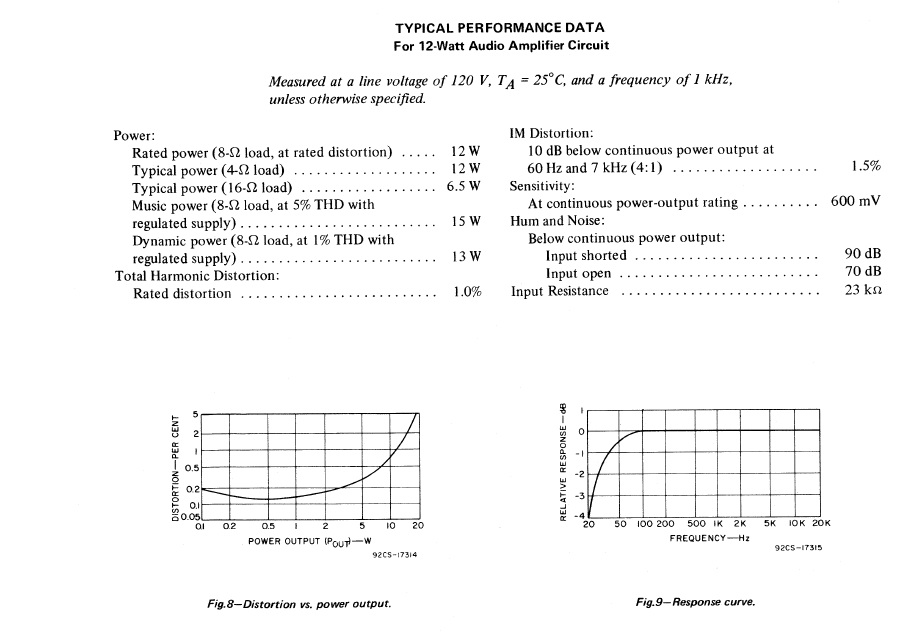

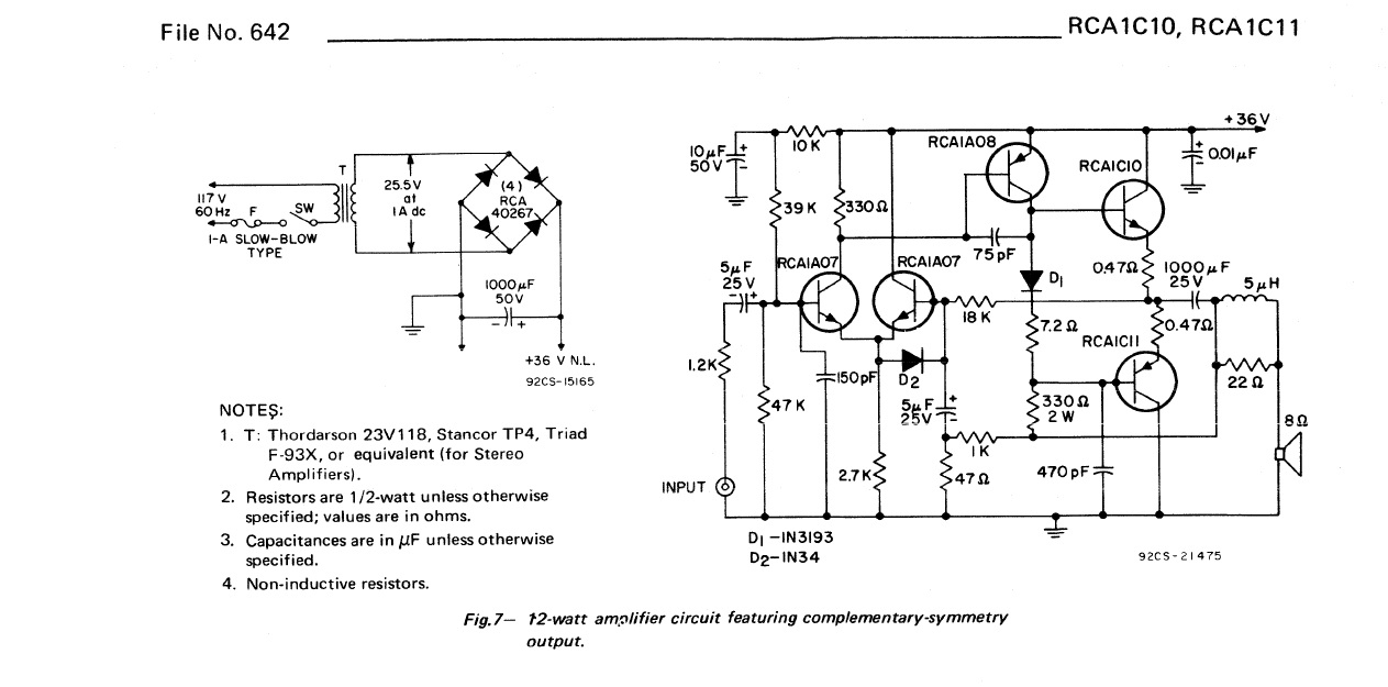

This amp is quite simple and you will get 5% THD at 15 Watt.
Still want to try the capacitor coupling between all the stages first.
