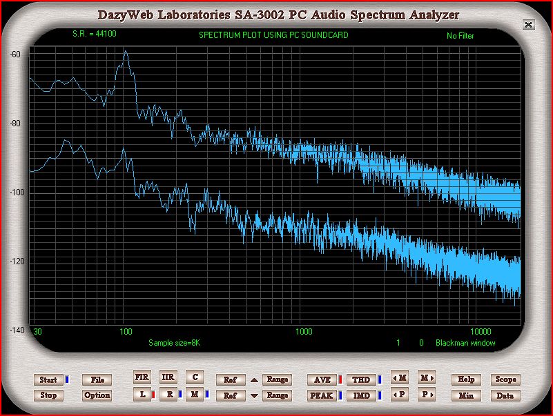

Hello,
I used this method to decrease the noise of a Philips 22RH270 pre-amplifier, on the RIAA phono inputs.
Because, at the earphone and volume CCW, we could hear the hum.
Here is the result:
The upper trace without mod,
The lower trace with a capacitance multiplier.
Regards.
Here is the result:
Regards.
