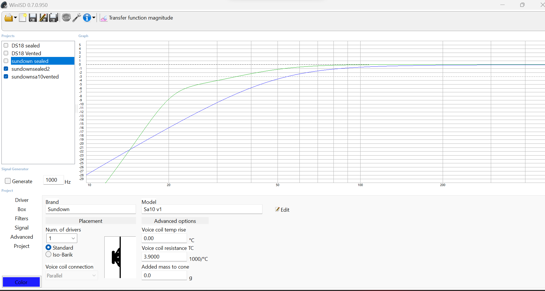

Anyways..... I have learned a bit how to use winISD and was playing around with adding a port
The blue graph is the sub in the current sealed box it is in
The green graph is if I add an external 2", 24" long, port onto the box. This is without changing the size of the box at all. Same size enclosure
Clearly the port gives me a way better frequency response.
Is my work correct here?

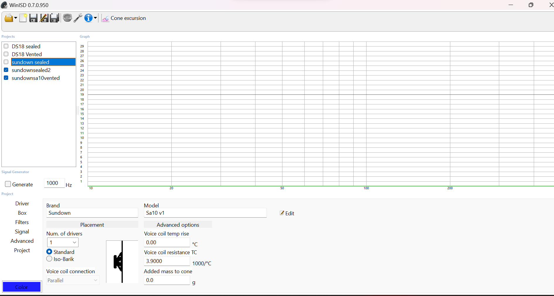

I also know cone excursion is an issue but that graph doesn't show anything. What parameters do I need to add to get that information?

To check port velocity and excursion, click “signal” and input whatever wattage for your equipment.

Sorry to say that, but your enclosure is too small for a vent. With 24" the port length will not work well. With such a driver maybe a passive radiator could do, but this also would profit from twice the volume, if driver tsp permit. You shold show the winISD page with the TSP parameter of your exact chassis, the ones I found do not match your simulation. Also, give some more information about your car. Does it have a full interior, where ist the sub, what kind of inclosure, build material, amplifier etc.
Please understand the relation volume and lowest frequency have, such a small enclosure needs extreme power to move the cone out. So maybe your amp doesn't have the power to drive your cone to the excursion that is needed for a lower low response.

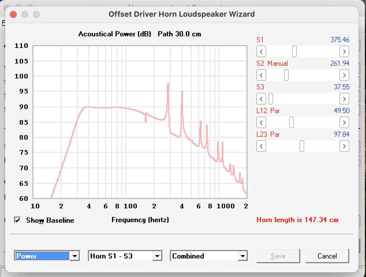

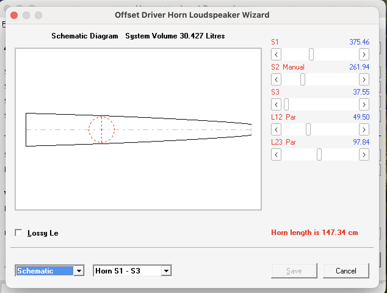

If you can efficiently fold a tapered transmission line into your available space, this might be worth giving it some thought. There are different options available. this one is about 30 litres. The ripple in the higher frequencies can be minimised with filling if necessary. The line dimensions could be adjusted (eg shortened) as necessary and effect simulated in hornresp.

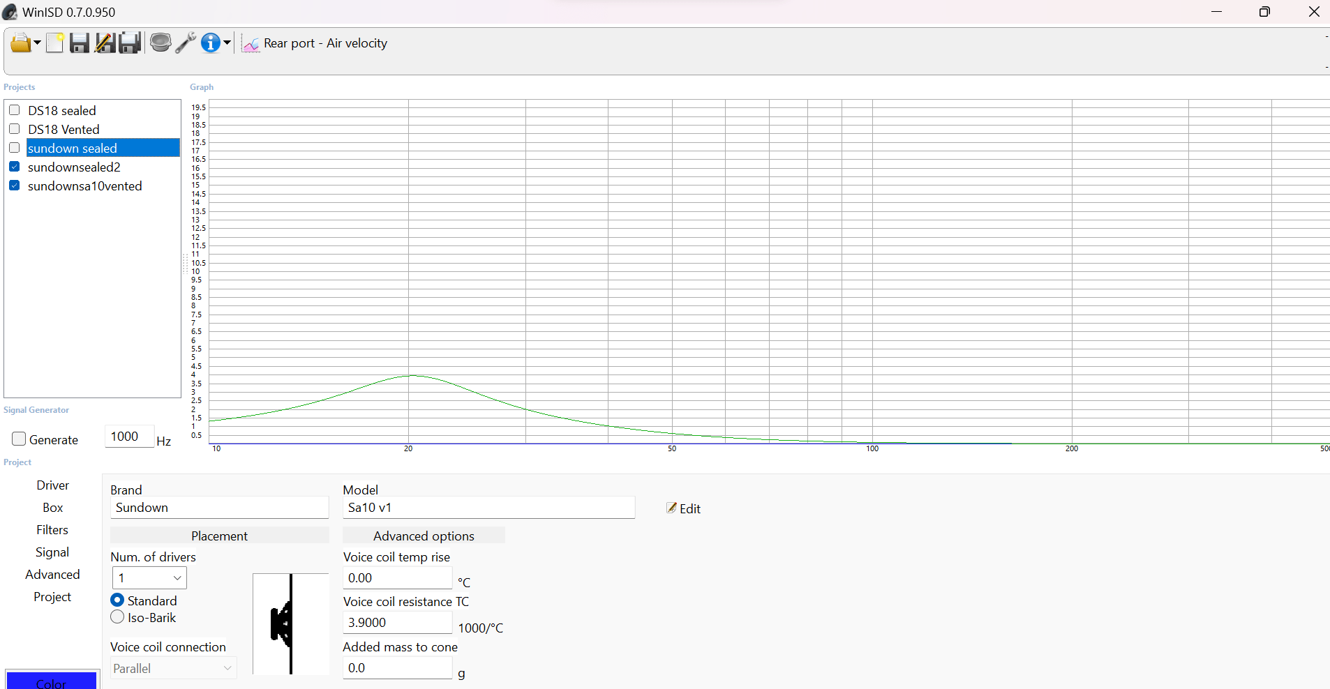

I think this is what you are asking for. Did I enter something wrong in here? It auto calculates some of the measurements. When it calculates them one or two of them is different from what they state on the sundown website.Sorry to say that, but your enclosure is too small for a vent. With 24" the port length will not work well. With such a driver maybe a passive radiator could do, but this also would profit from twice the volume, if driver tsp permit. You shold show the winISD page with the TSP parameter of your exact chassis, the ones I found do not match your simulation. Also, give some more information about your car. Does it have a full interior, where ist the sub, what kind of inclosure, build material, amplifier etc.

I could fold onto the back of it. I have another 12" of space behind the box to work with. What program is this?If you can efficiently fold a tapered transmission line into your available space, this might be worth giving it some thought. There are different options available. this one is about 30 litres. The ripple in the higher frequencies can be minimised with filling if necessary. The line dimensions could be adjusted (eg shortened) as necessary and effect simulated in hornresp.
View attachment 1241802View attachment 1241803
What do you mean by "whistling"? The port is going to make tons of noise? Can this not be minimized by the tapered horn or another feature?Generally car audio manufacturers quote the smallest possible enclosures for their subs, they recommend 1 cube ported which probably needs a port volume half the size of that box to not chuff with 19mm xmax... hence your 2" port would be a whistling Billy
Hornresp freely available at www.hornresp.net. There is an ongoing thread in the subwoofer forum https://www.diyaudio.com/community/threads/hornresp.119854/post-1462861. There are related threads about software to help design an enclosure to translate one’s simulations by Brian Steele and lordsansui which look to be useful tools too.What program is this?

Super helpful. I'll learn how to use this. ThanksHornresp freely available at www.hornresp.net. There is an ongoing thread in the subwoofer forum https://www.diyaudio.com/community/threads/hornresp.119854/post-1462861. There are related threads about software to help design an enclosure to translate one’s simulations by Brian Steele and lordsansui which look to be useful tools too.
Such a long thin port will just blow out compressed air not bass. The simulation sees only the energy, but this is not converted into sound waves, but very fast puff's of air. Like an engine with lot's of HP, but only first gear. You need the right transmission with sound, just like with a car. A thin vent is short, if you make it larger, it get's longer. Too long means too much volume, too thin too much losses passing through the pipe.
With your small box volume you will not get any usefull tuned vented system.
If you want to keep the volume small, you have to equalize the drop off to lower frequency. Which means large cone excursion, using extreme power.

In Winisd, once you have decided on your ideal box volume and port tuning, click on the port air velocity graph this will show you how much port air speed in meters per second 17Msec is a general rule of thumb to stay under to stop any port chuffing sound.
Winisd by default signal input is at 1 watt, Im pretty sure your going to feed these subs more than 1 watt
Now go to the signal tab down by the box/port tabs and increase your input wattage to the actual Wrms power of your amp and take another look at the graph, you need to balance your port dia and find a happy medium. In reality you only hit max power rarely so if youre the sort who just likes nice smooth not over powered bass, open the SPL graph and change the signal input to the level you think appropriately represents the max Db level you desire in your car.
Go back to the port velocity graph and see if its close to 17Msec, if not play around with box volume/port tuning and sizing... hint if you change from 1 port too 2 ports(keeping same dia)the port length needed will double and the Msec will halve on the air velocity graph, like wise if you halved the port area it'll halve the length for the same tuning and double the air velocity.
