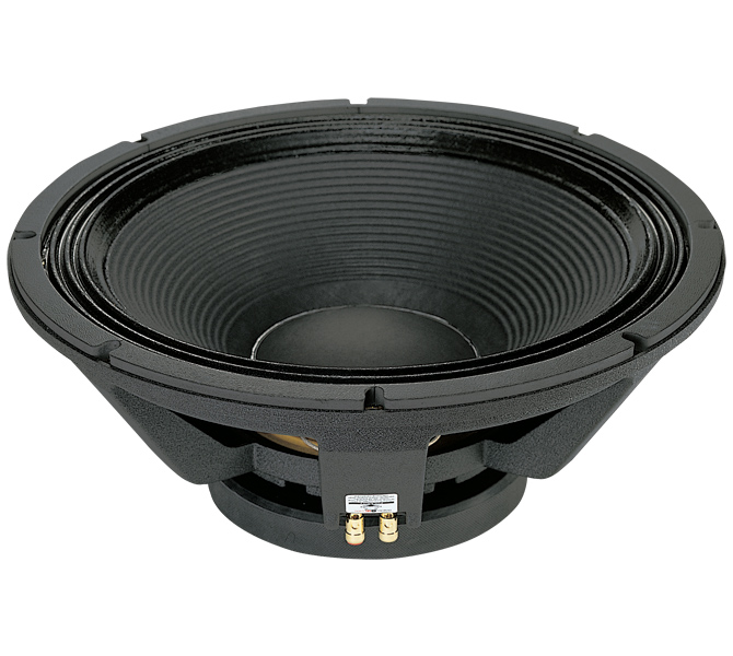

i am very new to the field of speaker design , i have recently made a 500W rms amp for my frnd but due to financial problems he is nt able to take it . So i thought why nt add this amp for my ht system.

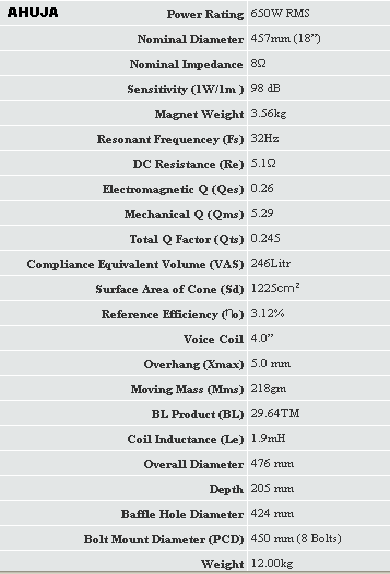

As in my country good subwoofer r nt available or r very expensive I was thinking that could PA subwoofers be used at my home for watching movies or listening to songs . I have a room with following dimentations 13 X 15 Fts.
I am including details of two 18inch drivers . plz help in choosing the right driver and designing a enclosure with lowest frequency response.

PA woofers can be used, but depending on the setup are probably not optimal, as already stated. I use two sealed 18 PA cabs in my basement setup, but its a big room, and I'm not trying to go real deep. They're supplying bass from about 40 to 150 Hz. I also use them for PA duties, so it makes sense for me. If I were picking something specifically for a HT sub, I'd probably be looking at some of the LABsub designs (but only if I needed pretty loud, deep bass). For most people, its probably best to stick with subs designed for HT. The car subs can be tricky because the car environment is different, so more boundary loading is assumed.
I would not buy PA speakers for a HT sub
I did build one though, had a pair of Cerwin Vega W15P 15" woofers laying around and the PA boxes. Calculated that the 3/4" plywood PA boxes had an internal air volume of 3.8 cu. ft. (107.5 liters) The Vas of my woofers was 7.3 cubic feet with an Fs of 35. I loaded them isobarik (face to face/push pull) so the woofers "see" 7.3 cubic feet and threw an 18" passive radiator on the back. Noted my actual Fs was around 32Hz (20 years old) so tuned the passive to 21.4 Hz with weights.
In short, it works and it goes below 20Hz flat frequency response and handles all the power the Carver M1.5t amp supplies (over 500 watts)
I was lucky since the Fs dropped low enough for the passive to extend the response down to HT territory. The Isobarik setup allows twice the power input in half the required space which worked well for my project. I can live with the sensitivity dropping from 95dB 1w/1m to 92dB since I had enough to work with.
If you want loud and low and don't mind a very tall cabinet, maybe one of those 12" Peerless subs tuned in a very tall folded horn? It will go down to 18 Hz and hit around 130dB in your room at 400 watts. You better have a tall ceiling or lay it down since it is around 8 to 10 feet (2.5 meters to 3 meters)

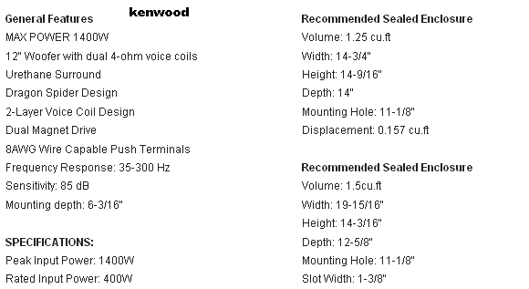

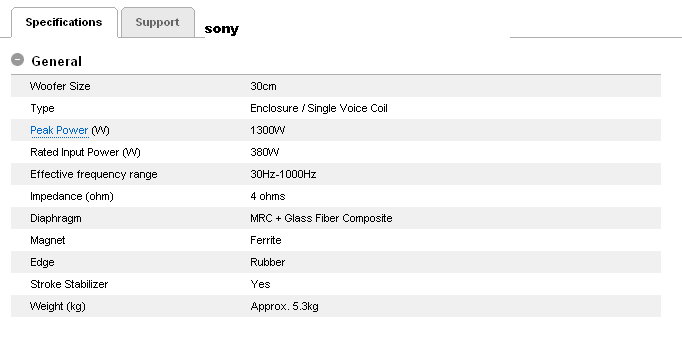

thank u guys for the valued suggestion , So as richeeboy said car subwoofer may be a choice for HT , here are two car subs avaiable at my place , tell me which is suitable with wat kind of encloser .

Contrary to common belief, pro audio subs work well in HT, if you use the correct enclosure. Horns love woofers with a relatively high resonance frequency. Look out for tapped horns or (if you dare to put a >300Liter monster in your home) a front loaded horn design. Both will be big, but also deliver high SPL for the big fun with the movies.
Check danleysoundlabs.com for some impressions on tapped horns.

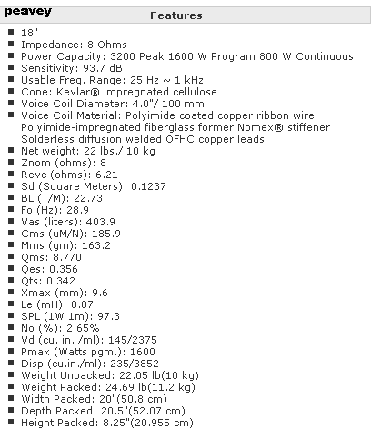

I looked up the Peavey 18" and it is interesting,
In a folded horn subwoofer, it puts out 108dB 1w/1m down to 30 Hz. Although not the 20Hz and under HT sub response, can the horn be made larger so it goes below 20Hz without Xmax exceeding 9mm at 500 watts? My next build is a horn so I'm trying to wrap my cranium around how it all goes together--with my weak knowledge on infrasonic horns, would the Peavey make the most sense if size is not a consideration? How would a horn respond in that size of room?

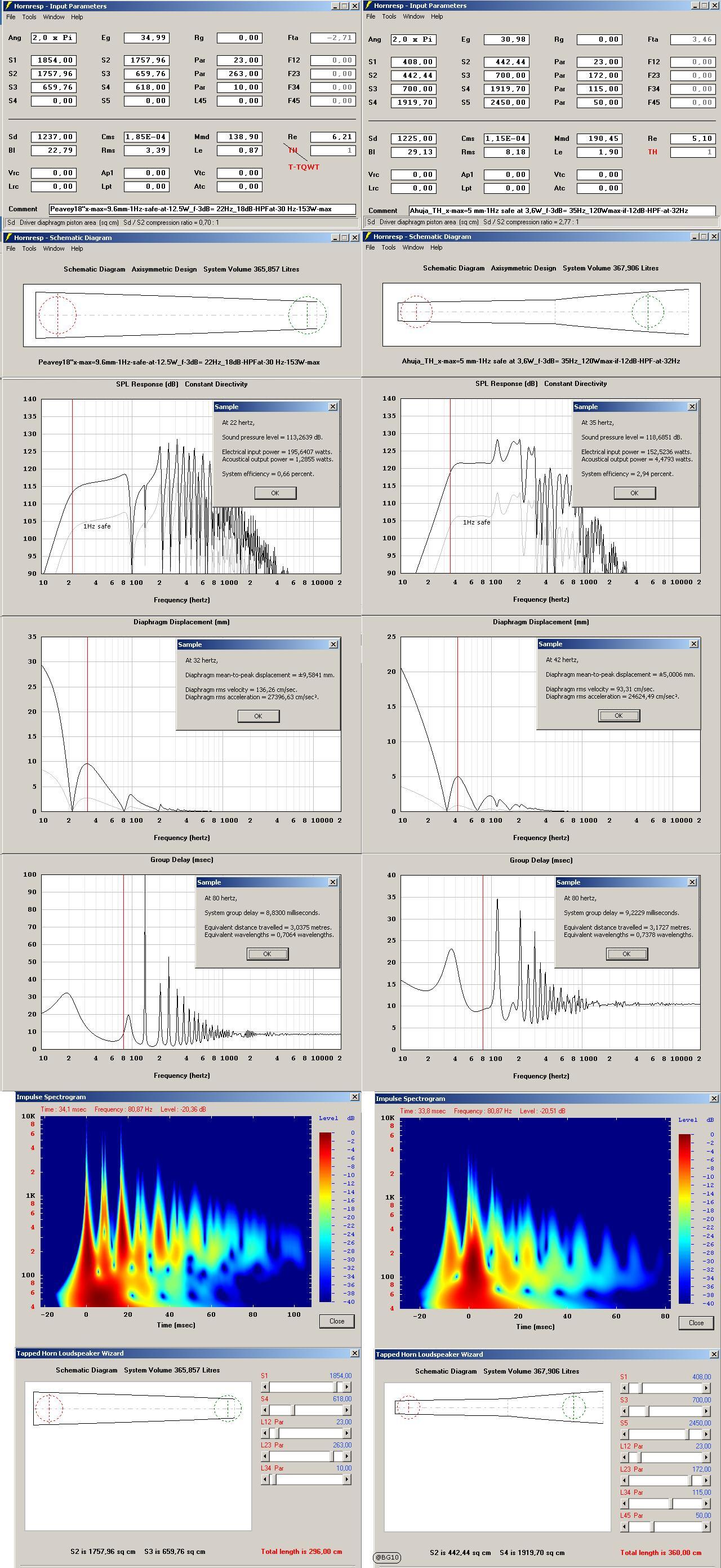

could you post Hornresp input parameters and output chart?it puts out 108dB 1w/1m down to 30 Hz.
Andrew,
The specs are for a Peavey SPFH folded horn PA subwoofer already built. I wonder if it will go down to 20Hz or lower with a larger horn? I'm just starting out with horns so am not to the point of plugging in the Low Rider Black Widow 18" driver to see how low it can go. If it can go to 18Hz F3 at 100dB sensitivity--I'm pulling out the table saw and a stack of wood!
I'll leave that idea to those that are more familiar with the program, I'm still learning.

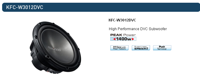

Kenwood apparently doesn't publish the specs or even an owner's manual for the DVC version of the 3012 which seems to be for markets other than the USA, but both have the same recommended sealed, vented box dimensions for car apps, so short of measuring them, the 3012's basic specs can be used: http://www.kenwoodusa.com/UserFiles/File/UnitedStates/Consumer/Manuals/kfcw3012.pdf
Same for the Sony, we have the XS-L126P5 which appears to have the same basic performance data, so lacking any measured specs, these are as good as any: http://www.sonystyle.com/wcsstore/SonyStyleStorefrontAssetStore/pdf/warranty/SEL-asset-153817.pdf
Regardless, for HT, the Kenwood needs a large sealed cab/I.B. or aperiodically loaded alignment and the Sony seems best suited for a tapped pipe, TQWT or horn alignment.

I think both of the suggested drivers could be of use: You could build a TH for indoor/outdoor music or a T-TQWT for indoor music and HT.
