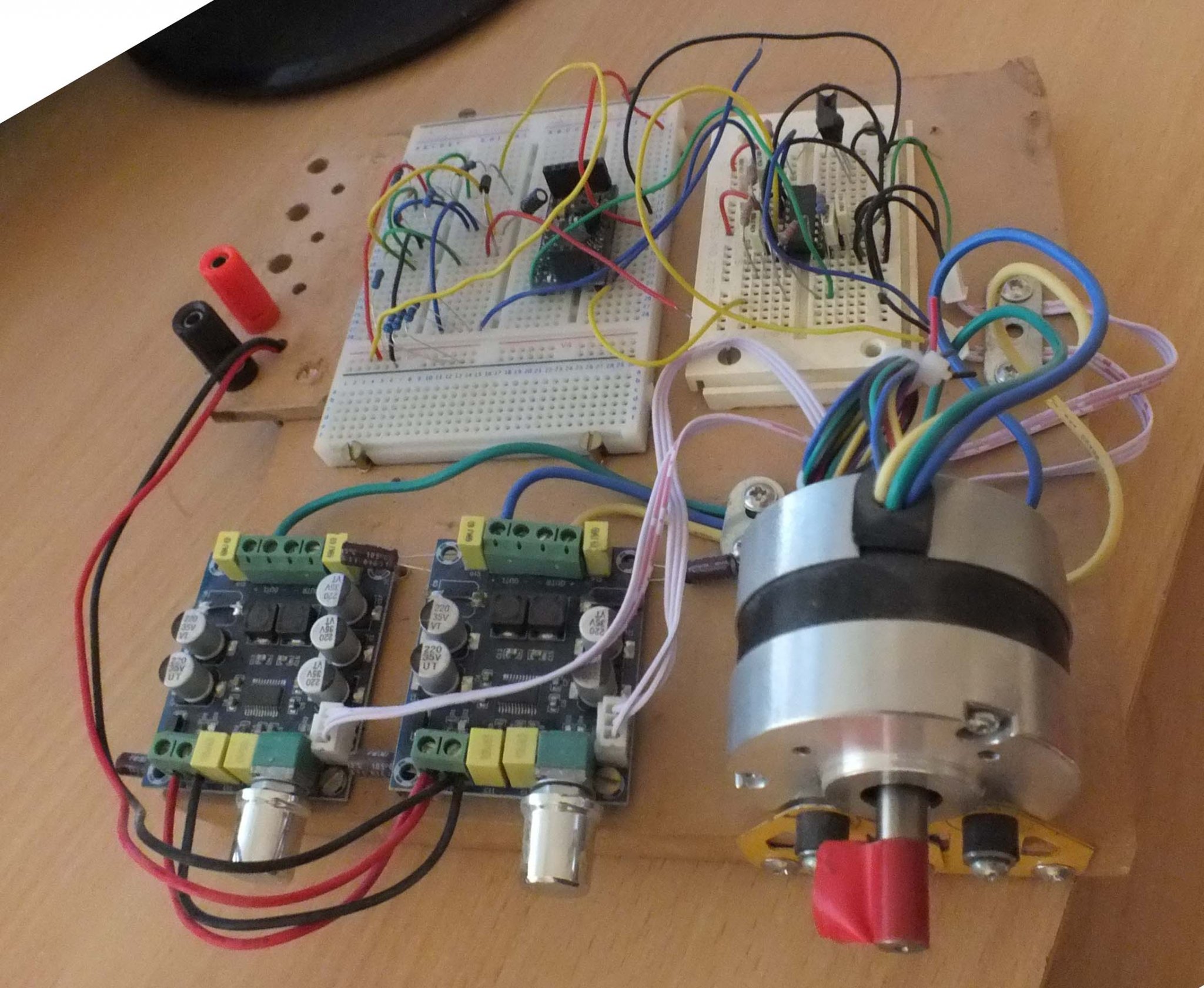

The most important lesson I learnt (from experience) when testing is to ensure cables are secure so they can't touch, connections are clearly labelled/colour coded/proper sockets fitted.
It is so easy when swapping boards & connections to make a wrong connection & let out the magic smoke.
Image attached with boards & motor screwed down, cables clamped & power cables led to clear red/black posts.

This is how new I am to electronics- what are those plastic circuit board looking things towards the back and how can I use them? Are they basically like solder free PCBs (i.e. put wires in on top and connect them on the bottom?)The most important lesson I learnt (from experience) when testing is to ensure cables are secure so they can't touch, connections are clearly labelled/colour coded/proper sockets fitted.

Thanks for the advice.
The white plastic things are breadboards. They are rows of something similar to an IC socket. Underneath they are connected together along the rows. You can poke component leads in a row and connect them together that way. As in the example.
Google "electronic breadboard" and see many.
https://en.wikipedia.org/wiki/Breadboard

Yes. also known as Protoboards.
Very useful for experimenting, but connections are somewhat flimsy, so a clever company
https://www.adafruit.com/product/571offers matching protoboards and exact same layout PCBs, so it´s easy transferring experimental designs to a properly soldered board without extra "thinking" or designing, just transfer parts pin by pin.
Push-in protoboard at right, top and bottom views of solderable PCB at left and center.
