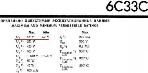

Looks OK , 2 x 5.7 = 11.4V minimum.I am gathering parts for 6C33C OTL amp and not finding a lot of 12.6v filament transformers to heat the tube but I've found a lot of 12v transformers.
I want to use old potted xformers so looking at the old stuff on line. I'd like to use 4 xformers instead of one big one.

In practical terms, nominal 12V is same as 12.6V , use what you find with no remorse.
And well within official filament specs, so don't overthink it.
In fact, the key word is "nominal" , would not be surprised that your "12V" transformer actually is 13V or more unloaded, even 14V.

Pointless, IMHO, there's no real reason not to use AC on the 6C33C heaters. At 6.3V and 3A for each half, a 7812 just won't be able to deliver the current, even with the two heaters in series. The valves generate enough heat without putting even more into a regulator. I don't know where you get 12VA from - it's over 36 per tube.
agreed, no point to use dc on an indirectly heated cathode...
