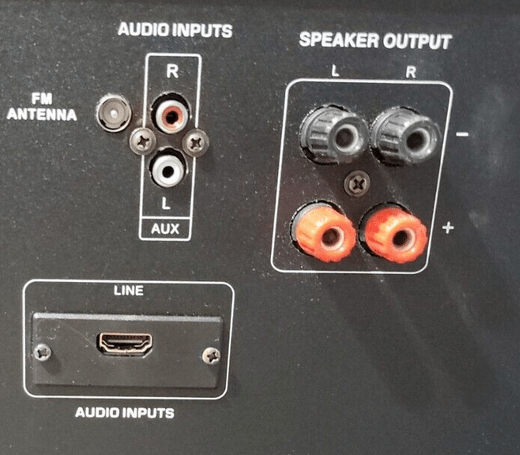

Are you using the AUX R and L Audio Inputs of the active woofer?
If so, what signal are you feeding into them?
If I’m feeding Aux R and L audio inputs from the woofer amp to my dedicated 100 W subwoofer section of your external amp board, this creates low volume
If I’m feeding directly from the back of my woofer driver directly to my dedicated 100 W subwoofer section of your external amp board, this creates normal volume

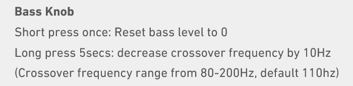

Power Button
Device on:
Short press once: Switch input mode
Long press once: Switch off
Short press twice: Disconnect current WiFi connection and enter paring mode (WiFi mode);
Disconnect current connected Bluetooth device (Bluetooth mode)
Short press three times: Restore the factory settings
Device off:
Short press: Switch on
Volume Knob
Treble Knob
Short press once: Reset treble level to 0
Long press 5secs: Increase crossover frequency by 10Hz
(Crossover frequency range from 80-200Hz, default 110hz)
Bass Knob
Short press once: Reset bass level to 0
Long press 5secs: decrease crossover frequency by 10Hz
The AUX L and R jacks are Audio inputs, it should not used as outputs.
As long as I’m not damaging anything by feeding the woofer driver directly to my external amp, then that’s ok.
According to the specification of your Arylic 2.1 amp board, it can handle 2-4Ω subwoofer driver, so that is OK.
I actually am wondering now if my amp already naturally directs all low frequencies to the subwoofer channel, even if nothing is plugged in there.
Yes, your Arylic 2.1 amplifier board has a built-in 80-200Hz adjustable crossover.
If no subwoofer driver is connected to the amplifier board, the left and right channel speakers can only go down to a minimum of 80Hz, which defaults to 110Hz.
