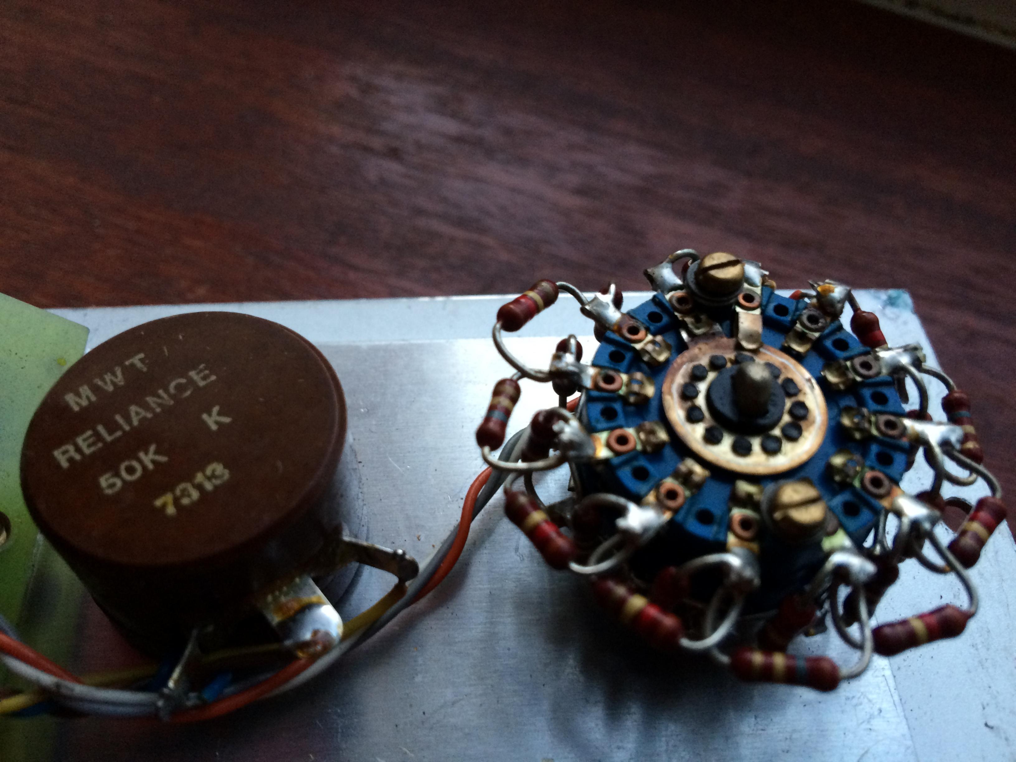

I hope to make a passive preamp as a beginners project. I have come across some bits with 2 stepped attenuators and 2 other potentiometer. The attenuators are only 10 step which isn't ideal but its potentially a free way to hear what Passive preamps sound like and learn along the way.
Would these be ok to make a dual mono passive pre?

I think Yes 🙂
but try first to measure value of attenuators?
the pots are 50K values.
also try to trace original wires in ATT - POT circuit

Measure the resistance from one end (the ground end, preferably) to the wiper at each position,
and that will give you an idea of how well it will control the volume.

Better would be to call these things things precision attenuators. And I've got nothing against experimenting with them to your heart's content. RAYMA gives good advice … yet at the core is something as yet unsaid: whatever the value of the attenuator, it must be of high enough resistance (impedance) at all settings so as to not overly load the source connected to it.
That's why you need to measure it.
