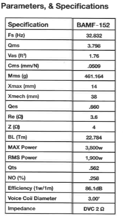

I couldn't find the T/S parameters for this subwoofer so without them it's going to be a total guess as to what would work for that subwoofer. PowerAcoustik posts recommended box volumes but not a tuning frequency for the bassreflex. As for how low you can tune the enclosure it depends on the driver and the response your shooting for. When building bass reflex enclosures for car audio it's not necessary to tune very low and could sound very bad. If your wanting sound quality I would go sealed. If you want everyone to here you from blocks away go bass reflex. After having my vehicles broken into and the stereo equipment taken I don't want people to here me from blocks away any more.

Oh I see, I have the T/S parameters just right here:

I made a couple quick calculations for a bassreflex. The BB4 alignment will give you a smaller enclosure with a Vb= 2.6cu.ft Fb=32.8 and an F3=28hz. Or a C4 alignment with a Vb= 5.35cu.ft Fb=23.6hz and F3=20.5. The F3 in the calculations are for free field measurements so in car responses will be much lower. There are many more alignments available, I just picked these as an example. Also if your interested a sealed box with 2.96cu.ft will give you a Qtc of .707.

Hey, thanks, now that you mentioned that I can get a Qtc of .707 by only increasing the sealed recommended size, I think I will go with that, don't want to go beyond than 4.0 3F, you know, the inconvenience of big things.
Now just wondering if is it true what this brand says, that this thing pushes 1900w RMS, 3800w peak power, even very cheap, in the $150 range.
