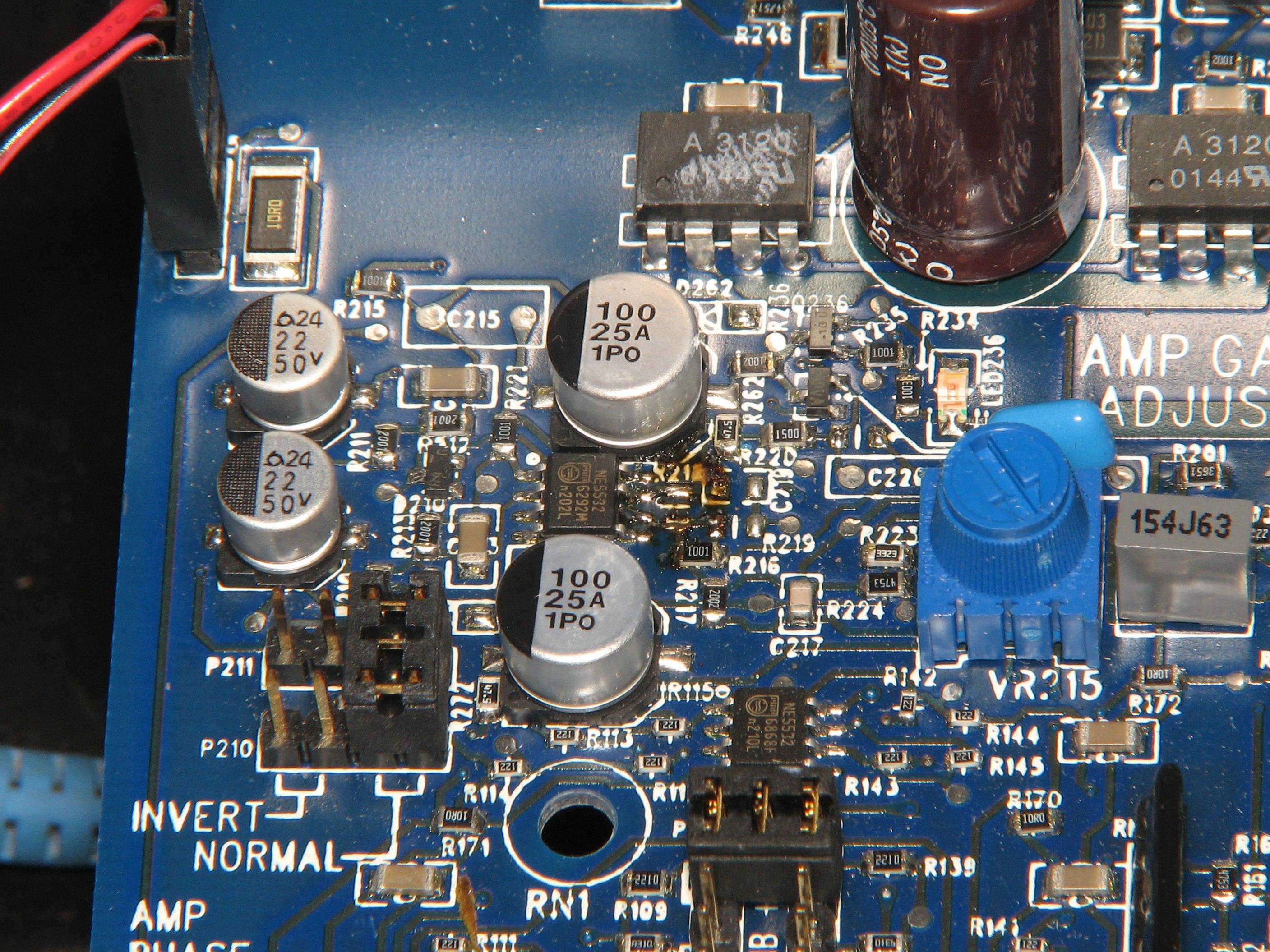

I need a pic if the section of the amp board that has the mute Led as a couple smd semiconductors are not right. If anyone can help? They were changed and the other shop was guessing what they were as the had no schematic or cross numbers to go by and have way of knowing what the originals were so a pic would be very helpful. Also the original problem was it was in mute mode axtant told him over the phone as the led was lit they tell me and they said they said they did not know how to take it out of mute mode?

the section on the input side has the amp gain adjust,Q236,D262 ,Q221,R222 and LED 236 (mute led)

Resoldered the shunt resisters. The two resistors under the current shunt resistor R282. They are often in need of replacement or at least need to be resoldered. What are there values I will check them? Also Q236 and Q221 by the led 236 if I had the part numbers or the spec on them to sub them as the are not the correct one as to be in there as I suspected. You don't know there purpose in the circuit as very hard to figure without a schematic or voltages. Can I power this amp up with outputs pulled to work my way up to the finals and take voltages in the control circuits and power supply?

Q236 and Q221 I need part numbers as 2N or 2S or PNP or NPN general purpose or specification on them to replace them as they are bad and voltages on their legs to know the ones I put in has the proper voltages to them as not to damage the new transistors.

Q236 is marked 1G which is an MMBTA06.
Q221 is likely marked C1 which would be an SST111 jfet. Leakage between the drain and source is normal for these transistors.
I don't know the voltages on their legs but the Vgs on the jfet is likely to be ~0v initially and ~15v after a few seconds. This transistor clamps the drive signal for the optocouplers.

This is a self-oscillating class D amplifier so everything inside the feedback loop has to be in place for the amp to produce all of the signals you'd see when it's operating normally.
You can drive a signal into the amp and confirm that it reaches pin 1 and 5 of the NE5532 between the two electrolytic caps. If you solder a bridge between legs 6 and 7 of the NE5532, it 'may' produce drive signals to drive the opto-couplers. If it does, you would see a signal on the gates of the outputs but it would be at audio frequency, not at the normal carrier frequency (80kHz-160kHz, if I'm not mistaken).
