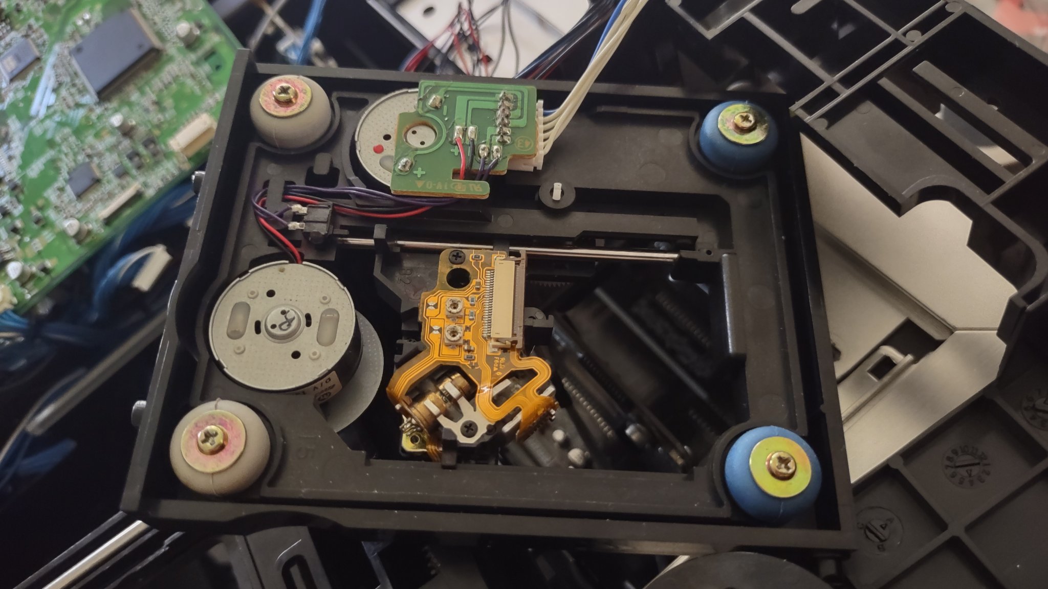

Attempting to fix an Onkyo DV-SP1000 that no longer reads CDs. Could read DVDs/SACDs. I ordered a new laser claiming to be Genuine sony, but finding it doesn't work. (yep, I desoldered the 2 blobs and was anal about static). The laser unit in question is a Sony KHM-280AAA
Unforutnately, since the new laser didn't work, I played with it's pots before taking baseline measurements, and used the old pickup to practice turning the tiny pots. Of course, they are now, both not working!
It's possible I may have connected the FPC cable incorrectly, but want to get back to the original settings to retrace my steps and correct everything along the way. Hopefully I haven't blown the diodes on the new one, but have ordered a replacement anyway. (this time from an US supplier claiming it's genuine Sony)
As the new laser is a few days away from delivery, I was hoping to try and get the unit going and perhaps salvage the purchased unit, if it's not defective and just needed a slight adjustment.

I did get the CD to read the table of contents and on occasion play, but it is very erratic and makes a buzzing noise when spinning, as if the motor is rattling. Sometimes the seconds counter showed, sometimes not. Could not get DVD going though.
I'm not sure what the 2 pots are, as I've not been able to find a data sheet on the KHM-280AAA. The left pot seemed to adjust for allowing a CD to spin and read when adjusted in a very specific place.
The 2nd pot is very loose and doesn't seem to have 'stops' so wondering if I might have damaged that one.
Your are not kidding about the drift, on these pots! Half thinking about trying to replace them, but since I have a new optical pickup on the way, wasn't sure I wanted to go through that effort yet.
At this point, I think that me messing with the pots after it didn't initially work was the 'death kiss' lol, so going to await the new optical pickup mechanism and hoping for the best, or at least a good starting point. This pickup was ordered from a US supplier and also claims to be genuine sony. Hopefully it works!

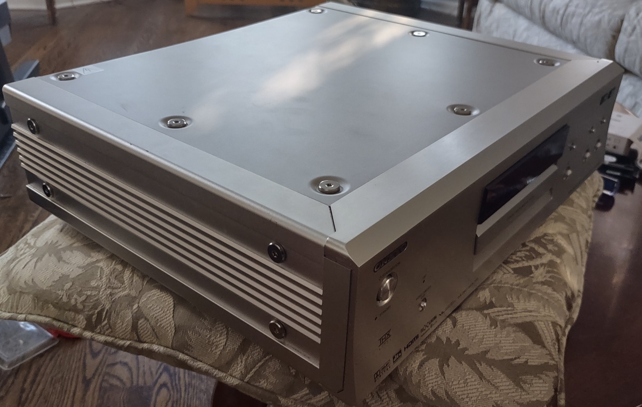

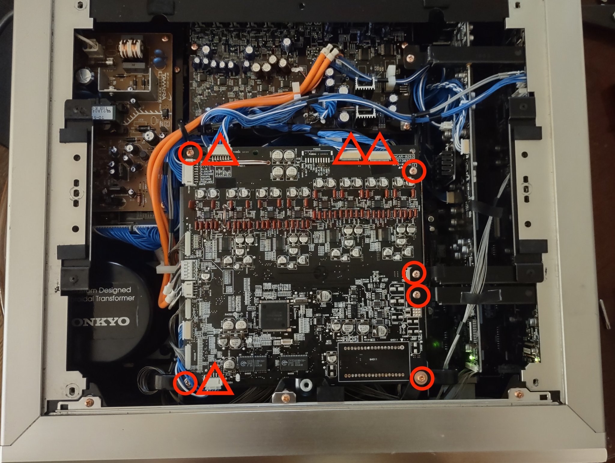

Some pics of the process for anyone in the future, since this is a DIY site, after all.
1. Remove top 7 torx screws (T20) and top cover.

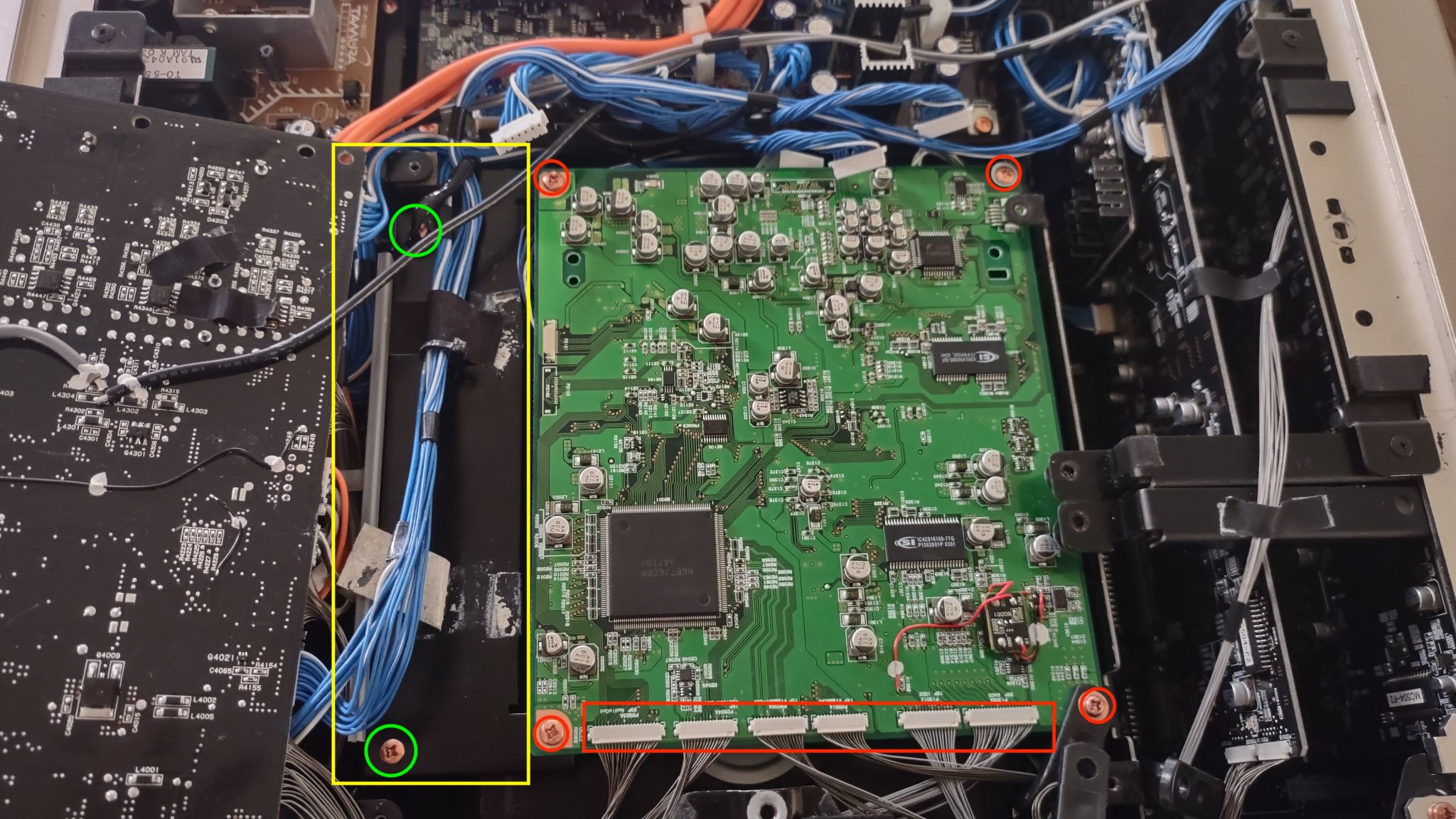

2. Remove 6 copper clad screws (red circles) and 4 connectors (red triangles) from Dac audio Board (black) and lift and tilt it off to the side towards the left.

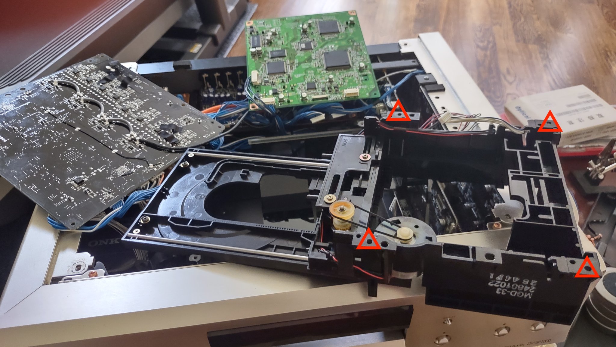

3. Remove 4 screws (red circles) from maind DVD board (green) and tilt it towards the back. Also remove the 6 connectors (red rectangle) and make sure to somehow mark where they go!

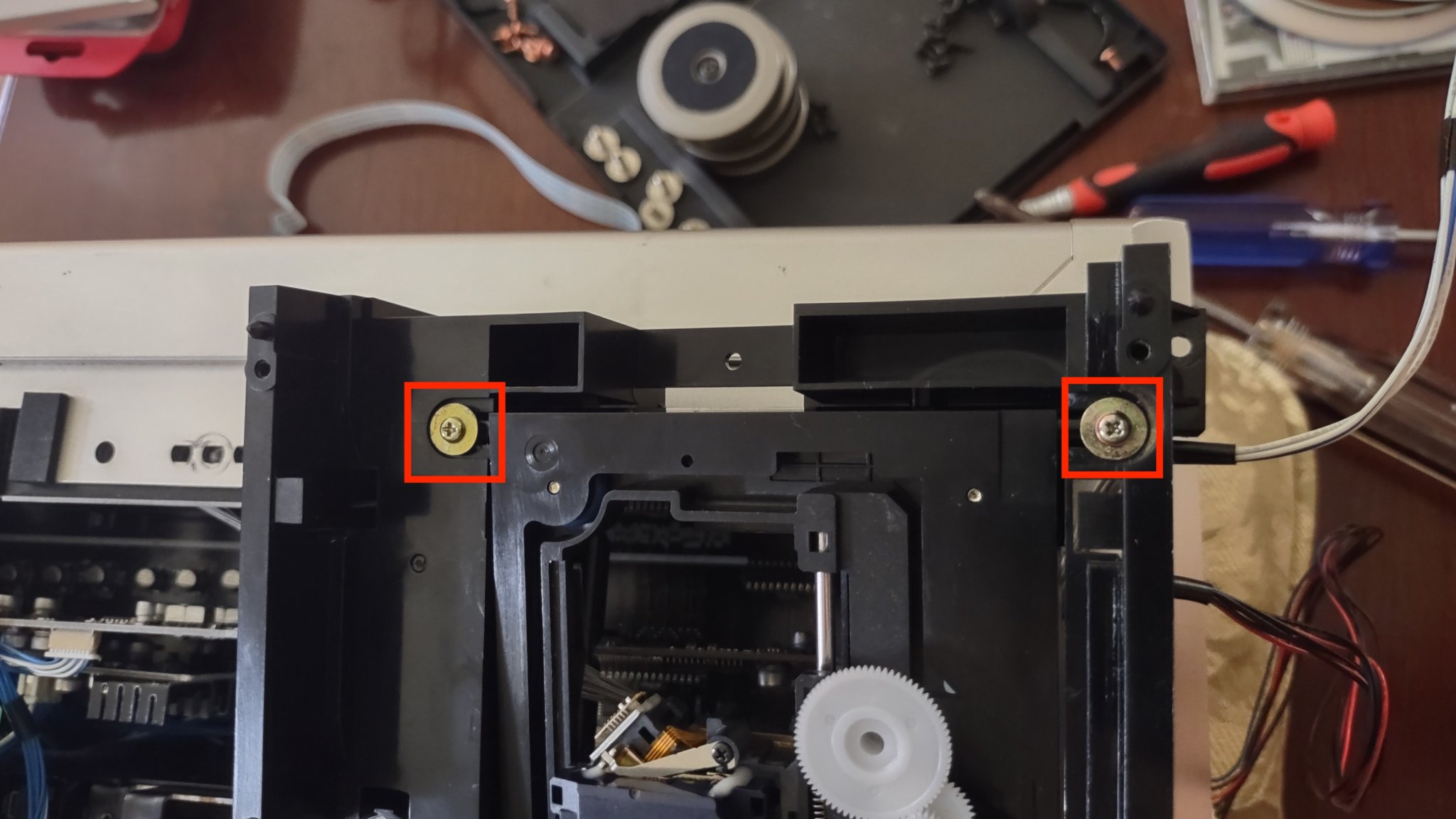

4. Remove the bracket on the left side (yellow rectangle) by removing 2 screws (green circles) - see below
Boards tilted out of the way to allow better access to bracket and transport.

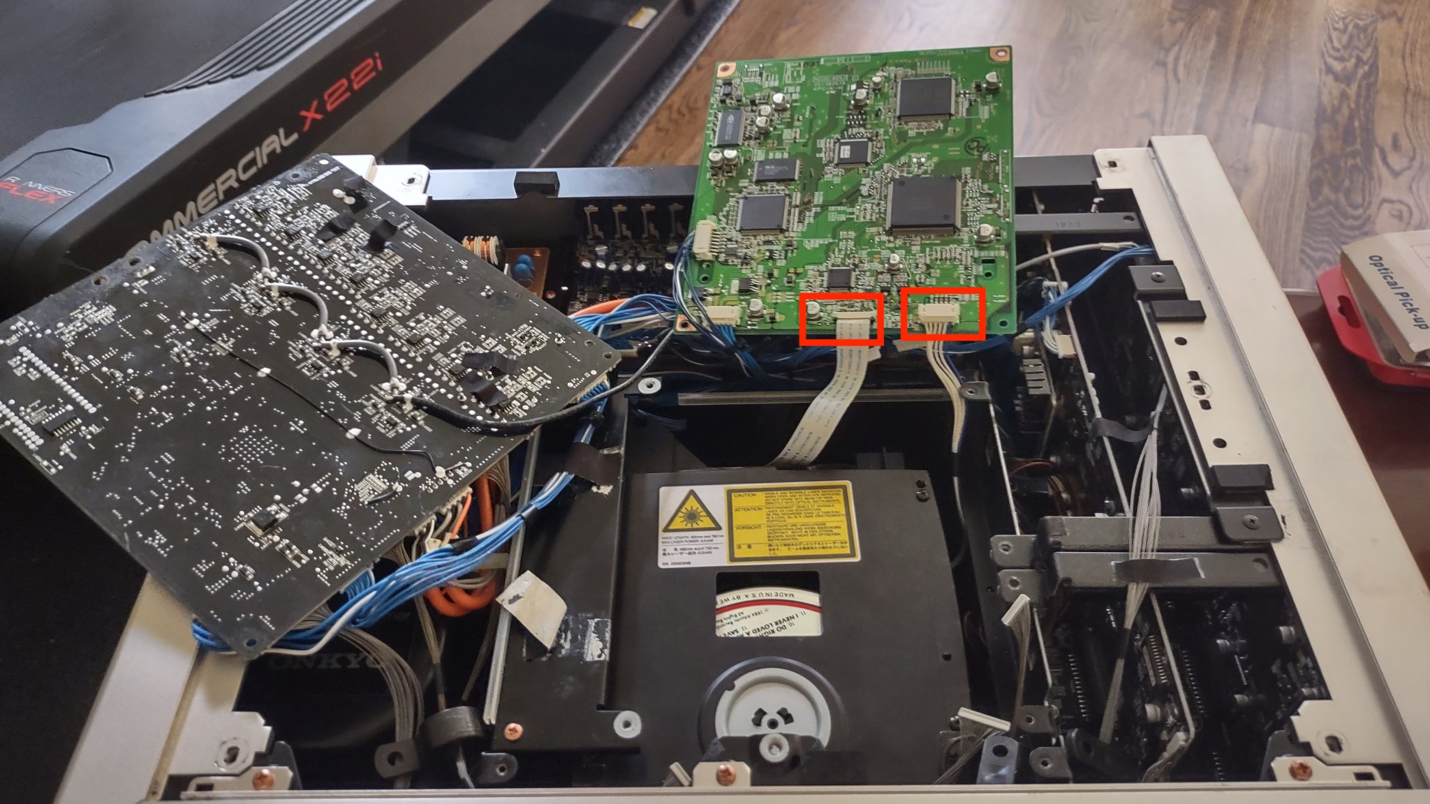

5. Disconnect the wires (red rectangles) to the optical pickup from the DVD main board (green)

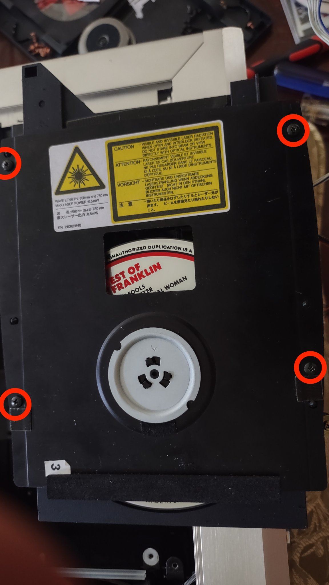

6. Remove Transport from unit with 4 screws at base (shown removed, 4 triangles)
7. Remove Transport cover
continued in next post...
8. Flip transport over and turn belted gear (as shown in transport step 6) to slide open disc tray and reveal 2 screws securing optical pickup.
9. Pickup can now be removed and the 2 cables disconnected.
10. These parts are transferred to the new optical pickup: I also opted to do the desoldering of the static protection blobs at this time.
Install is the reverse!

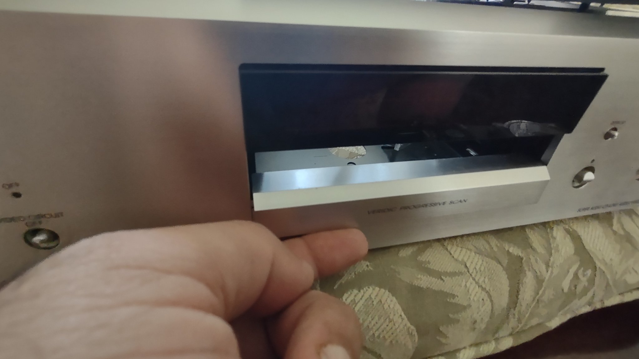

One important tip. When re-installing the transport into the unit, hold the cd tray door up, so it doesn't jam shut and not open on reassembly.
Also pay attention to the orientation of the flat cable that connects the optical pickup to the DVD main board and also the grey and blue cushions. Install them upside down and your disc will just grind. (ask me how I know, lol)

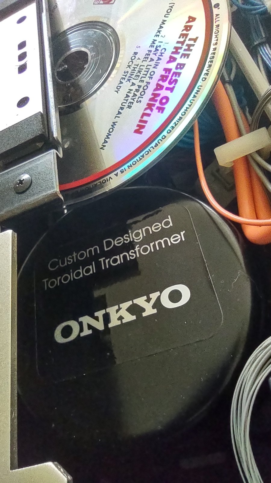

just for fun, a CD to show the size of the large toroidal transformer
