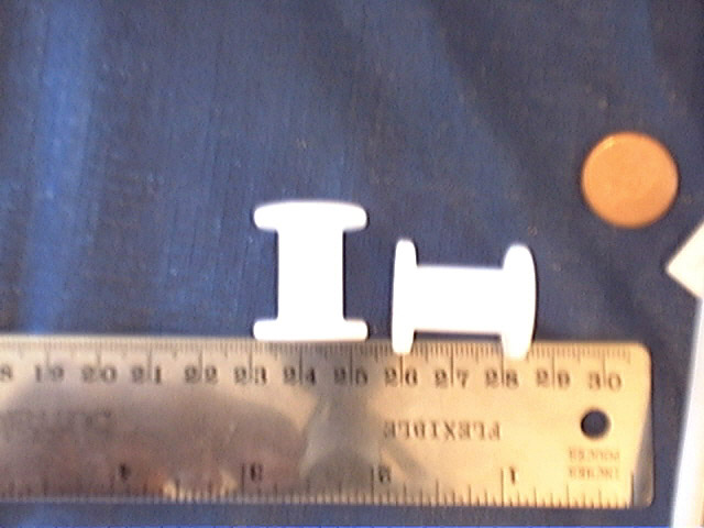

Hi guys i searched and found useful links to how to calculate them but i dont have an Ai value for my bobbins so i can t figure it out
if someone could look at this photo of the bobbins ( diameter = 11mm ,height = 18 mm ) and give me a ball park figure on how many turns to get .6 mH and .3 mH i would appreciate it. I am jury rigging a winder now with a adjustable drill and some screw drivers. This is just to tide me over till solen stuff arrives.

oooops photo would be nice i guess. These are what i was going to wind them on .3 and .6 mH ..... apparently they have a value (the bobbins) but i dont know what it is or what the formula to calculate their value is. So again , if someone is extremely familiar with winding inductors and could tell me approx how many turns that dia and height with 20 guage wire will make those values i would love you for the rest of the day. 😀 😉

i found an online java one that you just have to adjust outside diameter to approximate winding on a give inner diameter air core. Pretty sweet but damned annoying to find 😡
http://www.oz.net/~coilgun/mark2/inductorsim.htm
Thank you anyway for the attempt Mark but nothing came through. No worry i found an online Java based one that seems to be geared towards idiots [me] 😀

http://www.kotinet.com/oh8jep/soft.html
This WILL get you the program that I use. Hope it is what you want.
