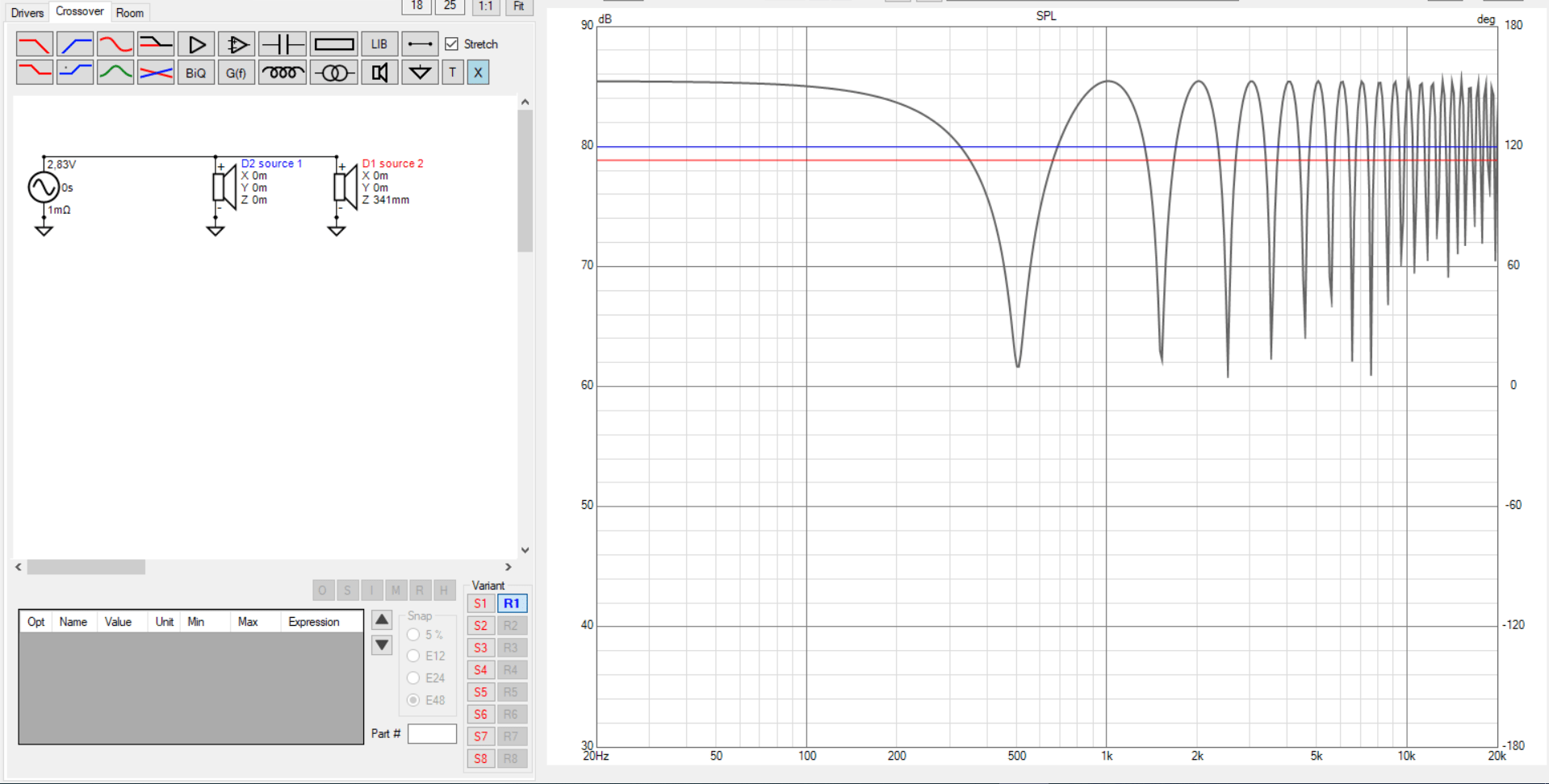

Add two ideal sources and delay the other somehow, just move it further. You could use the diffraction tool to put transducers as you like, for example x drivers in oval shape, and get "spinorama" out of it.
Ok here is about interference. When two sources have their phase less than 90deg apart, 1/4wl, they sum constructively so that the sum is louder than any of the two sources alone. At 1/2wl, with 180deg phase difference, there is destructive interference as they are out of phase and in ideal case could be inaudible. Between, about at 120deg, or 1/3wl, SPL goes below either, so destructive interference it is.
Here, two sources, other one moved back 341mm which accounts for one wavelength at 1kHz. First null is at 500Hz, as 341mm is half wavelength of that. 341mm would be third of about 335Hz so the blackline crosses the blue one. Below about 136,4cm, or 251Hz, 1/4wl, sum of the two is about as good as it gets.
So, the other sound source is behind the other for the observation point we have the graph this is worst case, longest path length differrence there is in this system. If you imagine now having the sources at same physical locations but changed observation angle path lenght drifference from each to you would be less than this. Hence we can assume it's roughly a point source as long as transducers are about 1/4wl apart because it's all constructive interference toward any observation point. And as you see it's not o strict, bit above or below is fine, it's just an approximation.

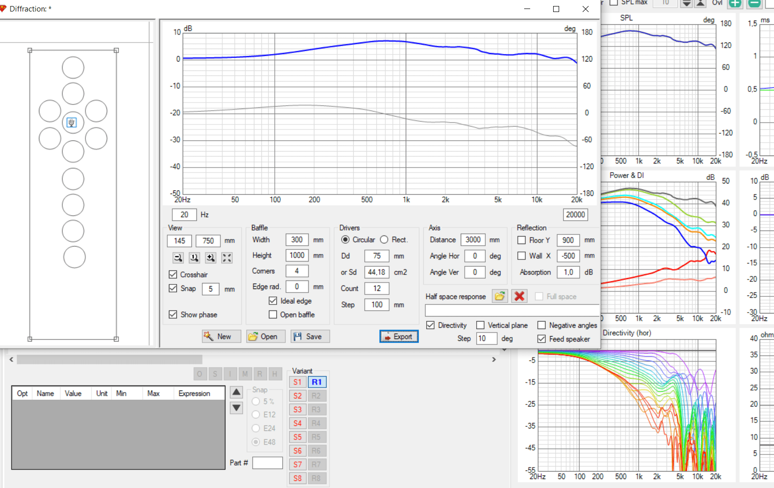

You can have pretty good idea of response with diffraction tool, real time adjustment. Great way to study things, just use imagination to figure out how to make a test for what is it you want to get more info about 🙂 It's all about wavelength, spend some time with vituixCAD or any other software you like that has realtime adjustment (mousewheel) and you'll get a ton of intuition how sound interacts with objects, transducers, all interacting with each other.
