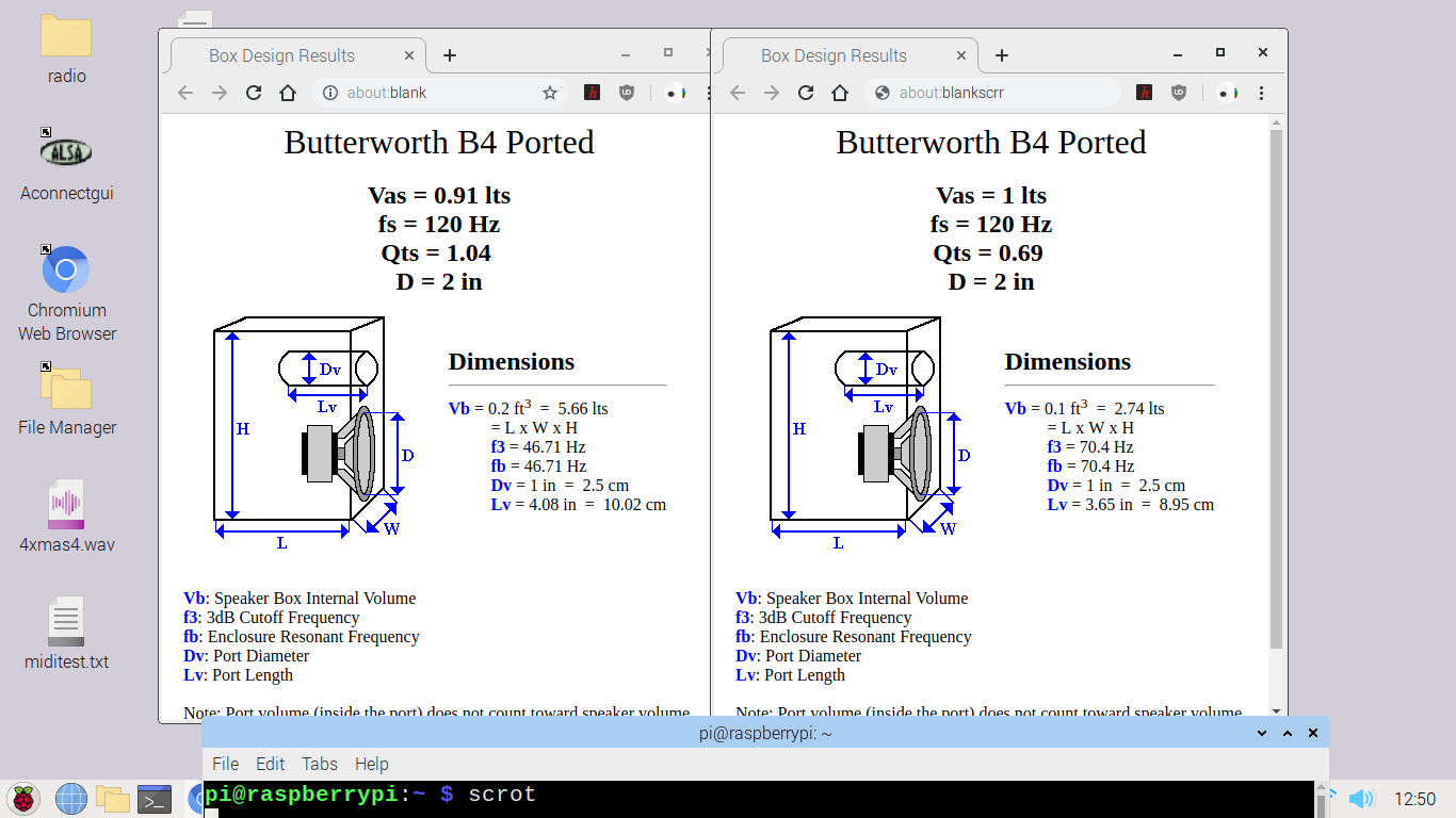

For 8 Ohm model ..... pipe 4" x 13 "
For 4 Ohm model ...... pipe 4" x 27 "
Ok, so when I would use a 4" pipe instead of a 2" pipe, I could almost half the length? And then do a 1" by 4" port at the end? Because I cannot make a 1"x4" port at the end of a 2" pipe.

4" abs with caps ( home depot )
if you drill a 1" hole in a cap .....
one of these :
https://www.amazon.com/10-Pack-Cut-...=2025&creative=165953&creativeASIN=B00LORILBS
will screw in ( some effort and oil needed
since they are 3/4 " they can be ~ 1" long
