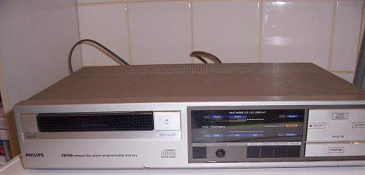

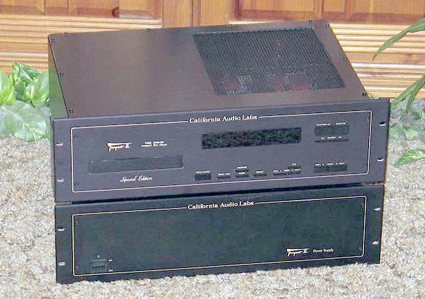

Noticed that it's the Tempest "2" in question ( did not notice that before) If it's a 2 chassis player, the base cd player was a Magnavox 472 or 473, 16bit models. In stock form they had a 'dashboard' at the bottom of the front panel with some of the controls there. CAL folded that pcb down to lay flat on their faceplate. Don't know if Philips had an identical model for Europe or not. Bet TDA1540 can find out.
Attached is a Tempest II, if it looks like this it's a 472/473 player at the core. If it's a one box Tempest, then it was a 2041/CD350 based player.
yes.with identical numbers.

Thanks for the advice guys!. It is indeed the two box Tempest which is giving me all this hassle.... The transformer in the separate PSU does have dual primarys, as does a small (10VA or so) transformer mounted on the rear panel of the main player box which provides the digital 5V, these I have converted for UK mains. The Philips player looked like it would be easy to convert...... What appeared to be multiple primarys were mainly dummy pins used to hold down the TX.... it only has the one primary!. Stranger still, it appears that CAL removed the original TX and replaced it with the one currently fitted!, maybe they could not obtain any more USA spec chassis and were having to modify European ones?
