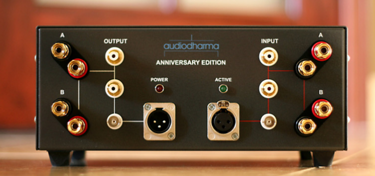

As author of the lone schematic posted thus far (see post #10), I will suggest another way -- a better way -- to build one. Jettison the hardware based waveform generator (2 x 555 with assorted passives) and replace it with a microcontroller and onboard software. Software implements the frequency-vs-time smearing according to your wishes and tastes. You choose fmin and fmax. You choose the frequency-ramp-up time (10 seconds?) and you choose the frequency-ramp-down time (7 seconds?). The little uC chip drives an integrated H-Bridge IC like the DMHC3025 (datasheet) which can pump more than 3 amperes into the load.
Build two complete copies of the circuit with two different current limiting resistors; Copy#1 (for "interconnects") includes a series resistor which limits current to ±250 milliamps. Copy#2 (for speaker cables and power cords) includes a different resistor which limits current to ±2.5 amperes. Notice that by having two copies you can "cook" interconnects at the same time you "cook" speaker cables. Multi-Tasking! Ooh baby.
An AC-to-DC power supply brick from a laptop computer inexpensively provides 19.5VDC at 90 watts link, more than enough to drive this contraption including a hefty airflow "gaming fan". You can even silkscreen the seductive sales-closer phrase "Anniversary Edition" onto the front panel, as audiodharma has done.
