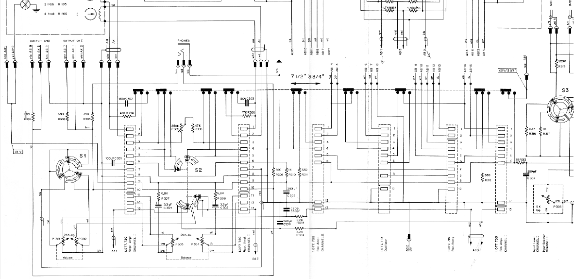

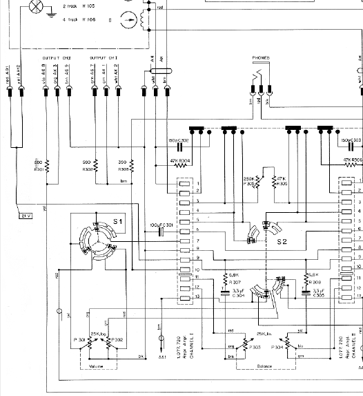

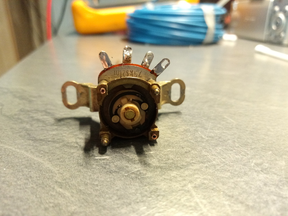

I'm a bit confused so I need wiring advice to bypass (using fixed value resistors) the volume and balance pots of my Revox A77.
I want to know if I've got it right that for fixed volume output to bypass pots P301,P302 I need to short blk/red/yel wires and then add resistor between shorted blk/red and grn for one channel and another resistor between shorted blk/yel and org for the other channel.
As for fixed channel balance do I have to short blu/grn and add resistor from shorted point to yel and for the other channel short red/org and add resistor from this to brn?

I had thought it all wrong, with a bit more caution I understood I have to make a divider by fitting a resistor between red/grn = out/in and another resistor between red/blk = out/grnd for one channel.
As for the other channel doing the same by fitting a resistor between yel/org=out/in and another resistor between yel/blk = out/grnd.
Fitted resistors pairs sum must be as close as possible to pot's 25K resistance.

Just finished both pots bypassing with success, same procedure as above (created a divider) using a pair of 13K resistors for each channel on the balance pot.
Results sounds fine and got rid of channel imbalance and nasty scratches when touching volume or balance knob.
For the record before trying this I had tried cleaning the pots and even disassembling volume pot to rebuild it which I succeed but the result was not as good as it should, after that I had bought a used pair from the bay market but these were in worse condition than mine.

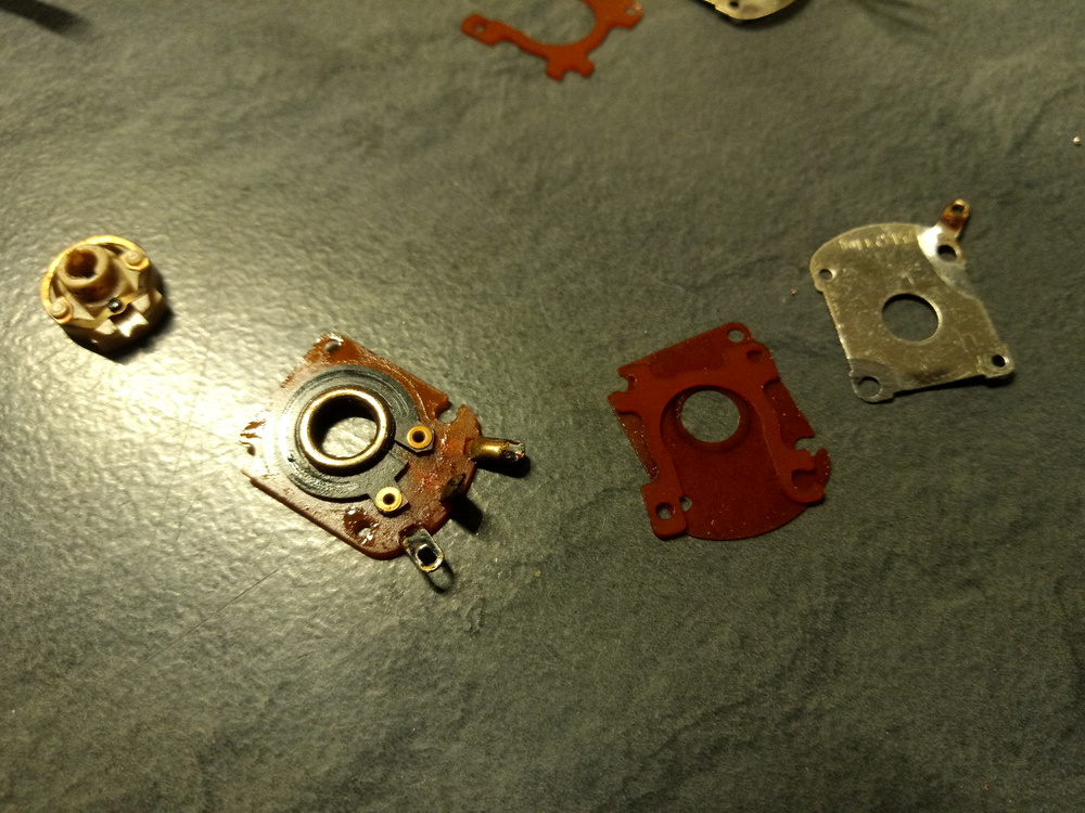

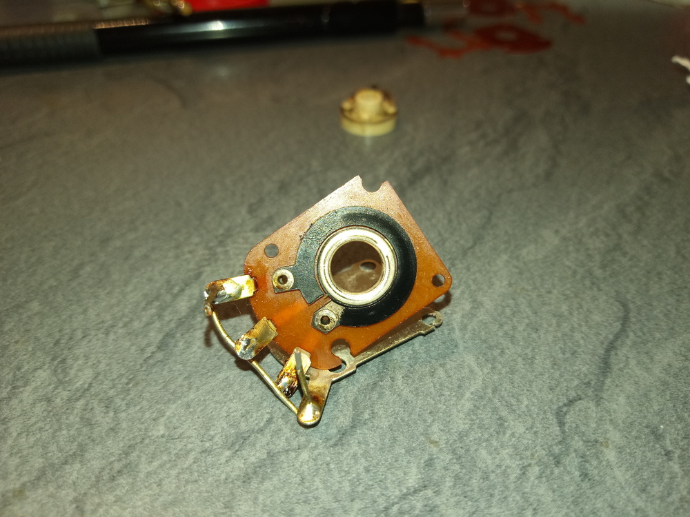

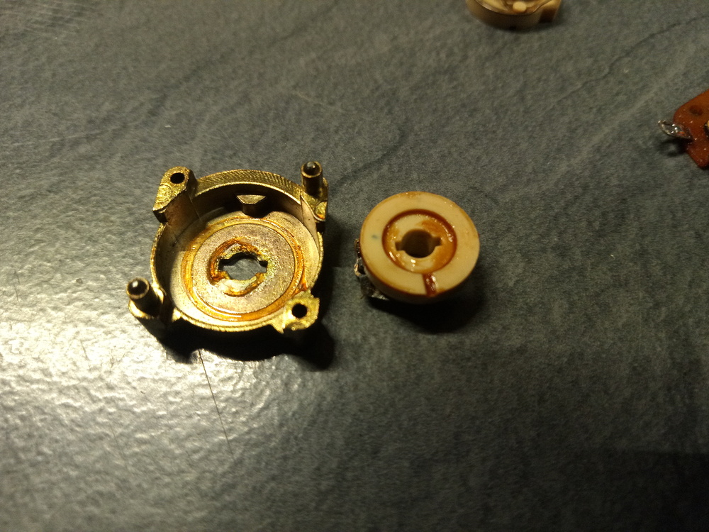

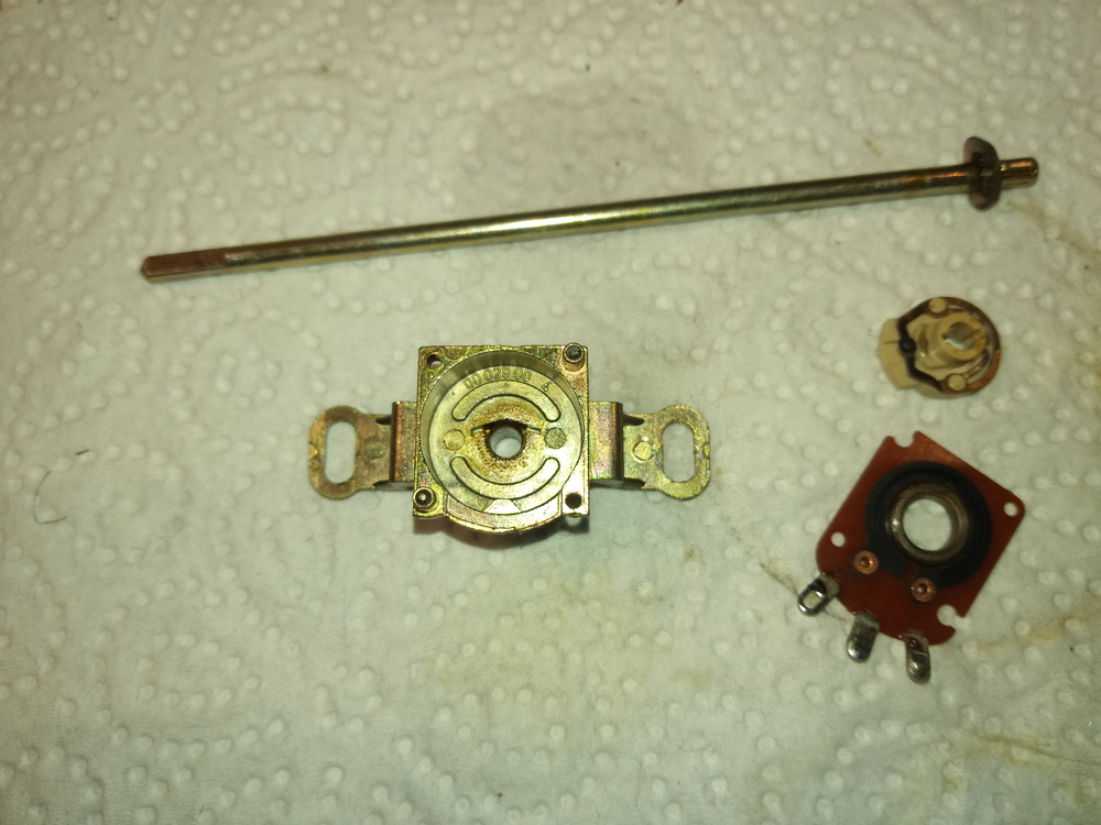

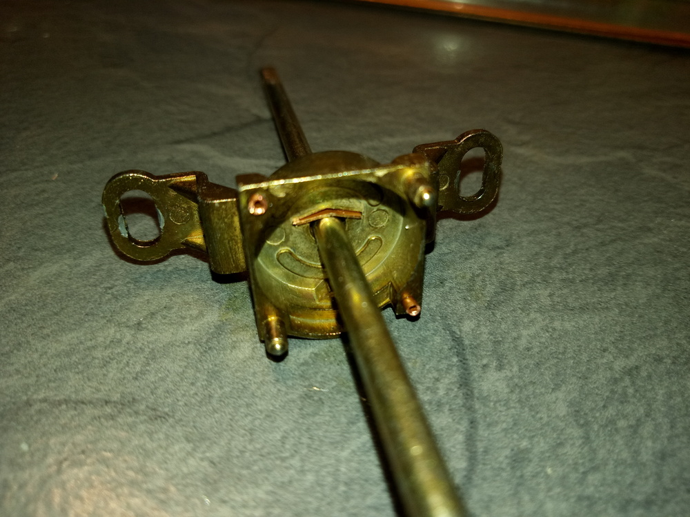

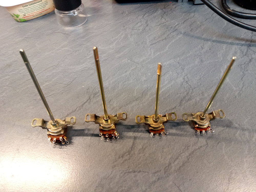

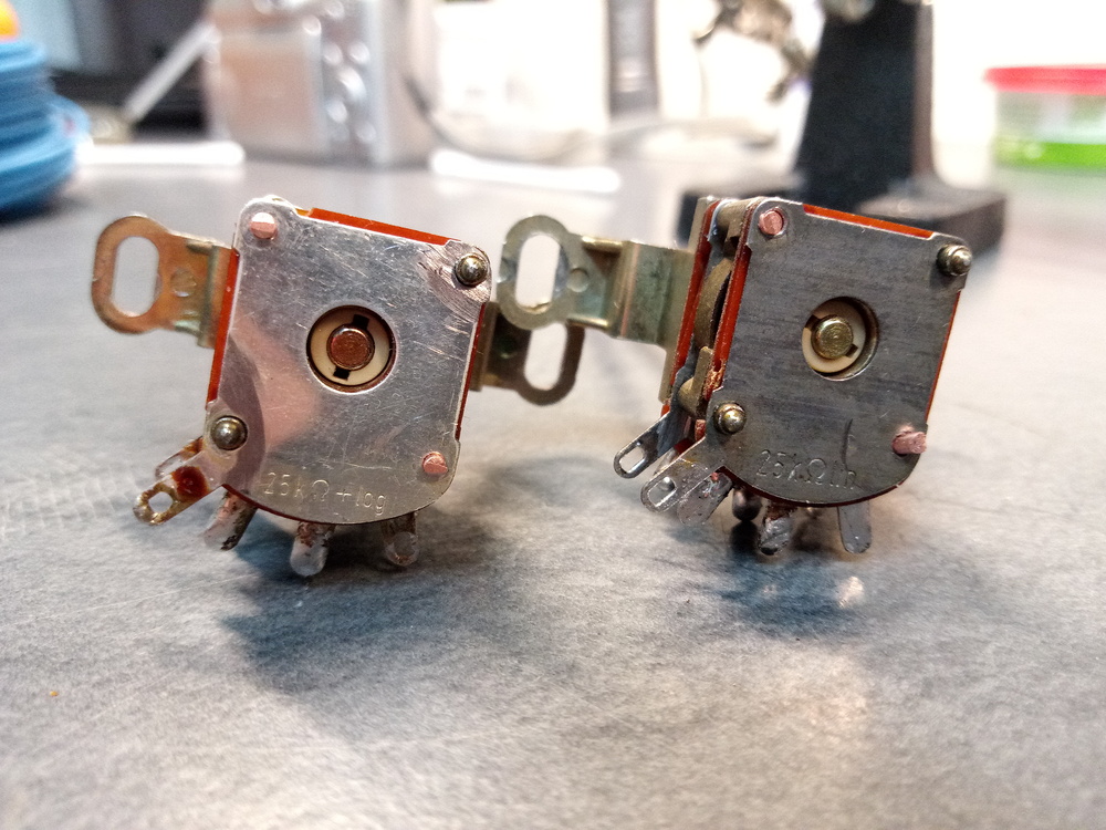

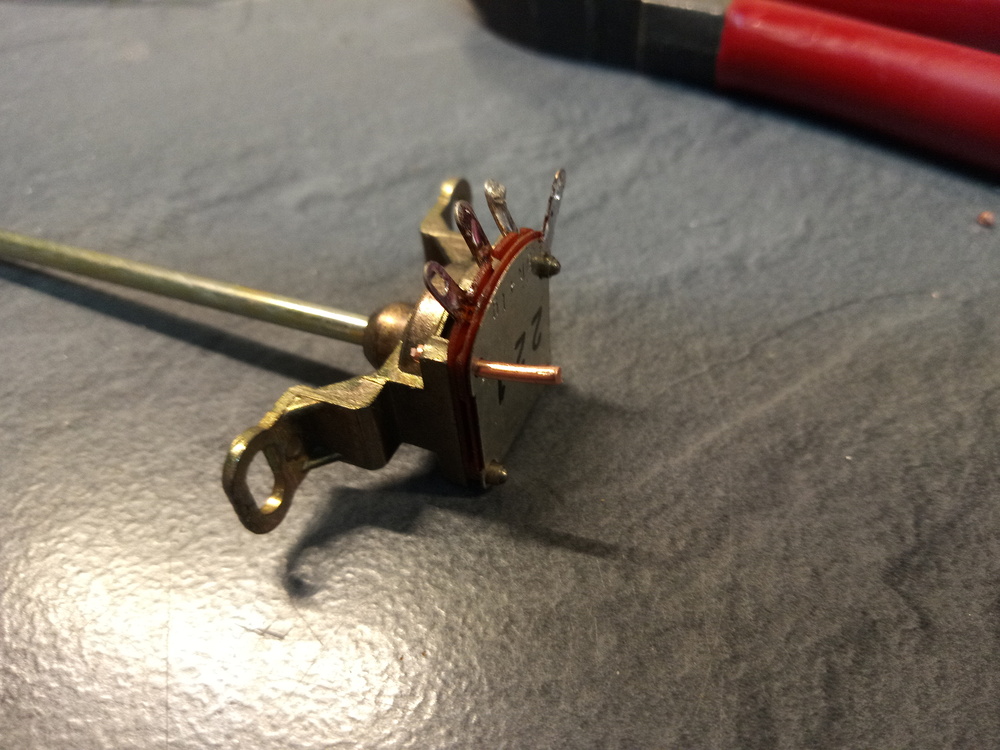

I re-read this thread - the 5k ohm recording level potentiometers are indeed quite impossible to repair, and the elongated shaft is quite narrow. This makes finding an alternative challenging.
the pots are in good quality. Like all pots in this age, they had to cleaned up from inside. It's a difficult work but worthy. All contacts I had cleaned and afterwards sealed. Then all this remounted. With two copper ribbons (from a power cable) that I stuffed, the pots are solid mounted. They work fine again.
Vintage Pots should be handled carefully, in many cases you got no proper replacement.
The recording pots are also good to clean. I had them completed with a bronze feather for better handling in turn the knobs. (I don't know, why Revox this in the recording pots spared?) The a little drop of silicon grease for the shaft...
This long shaft pots were a special series exclusivly for Revox an you will find no replacement for this.

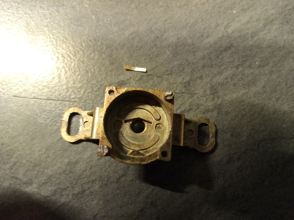

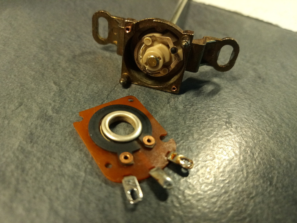

That is fine so long as the Wiper is not damaged. I had the two 5k recording level potentiometers with cracked/damaged wipers. Ok, they are 50 years old now...
Trying to solder the cracked wiper back together is VERY challenging. I managed to do it, but am not sure how long it will hold, so I sourced some used ones online. I am not sure if the wiper from a donor pot would fit... Others from this manufacturer seem to have thicker shafts, so didn't try it.
I also used wire to hold the assembly together after. Note: The little black (carbon?) plug on the wiper can fall off. It is important not to lose this tiny piece!
Ian
Yes, getting them back toe
Ian
The only way is to get ones from some dealers which offers old replacement parts from disassambled A77...

All of the trimmers in an A77 are replaceable with Piher trimmers in the PT15LH series, except for the crosstalk control which is a horizontal PT15LV.
The PT10 range is smaller, and is used in B77 and PR99 machines.
For the volume and balance pots, spray some Deoxit F5 fader lube right inside and exercise the pot back and forward 20 times - never fails.
