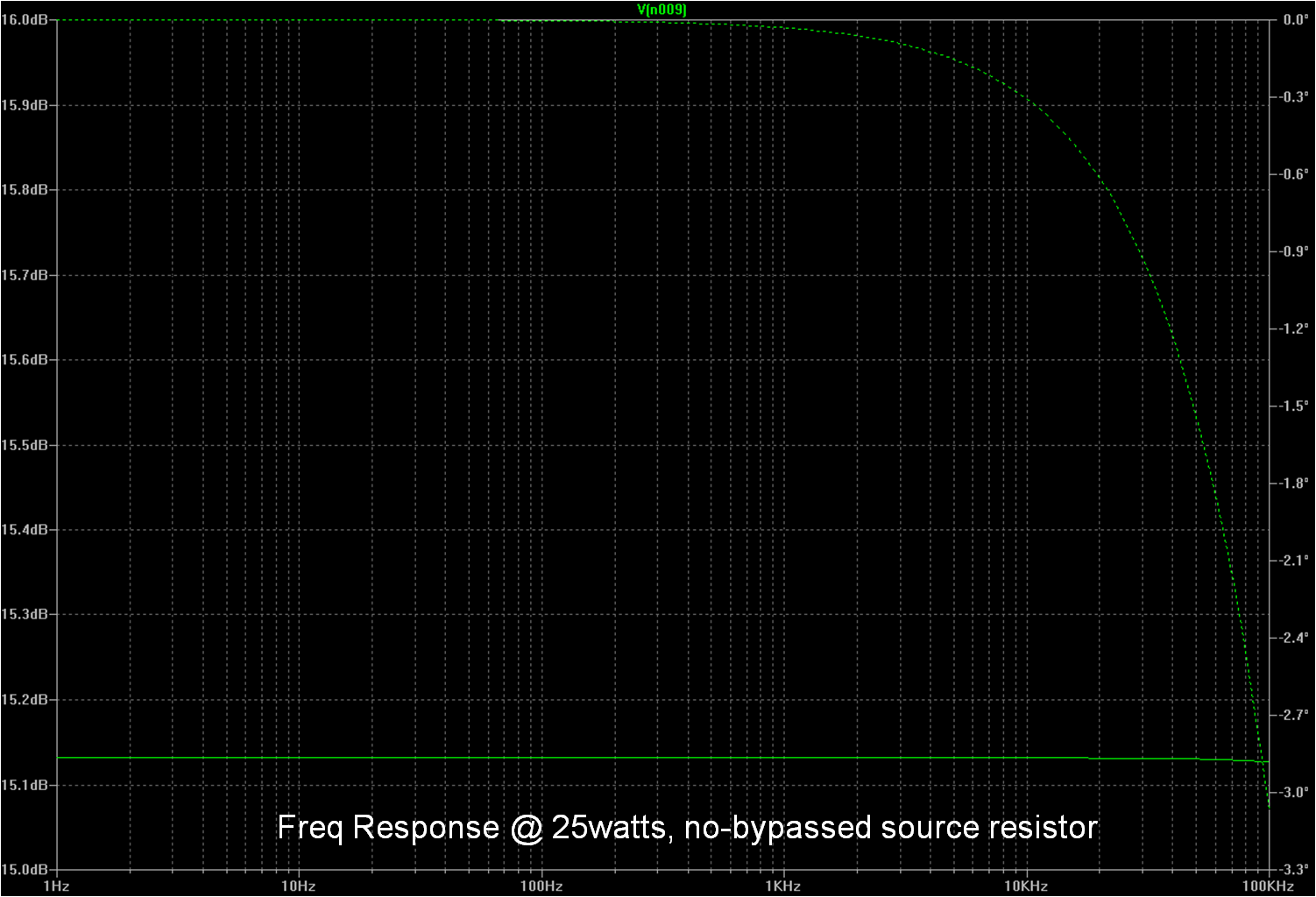

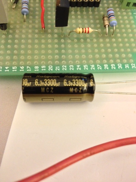

Another way is to bypass the source resistor with a capacitor. Because the voltage dropped across the resistor is small, we can try paralleled high-capacitance low-esr parts. These low voltage caps are commonly used on PC motherboards so are cheap and plentiful. The sims below try and show the approximate effects on freq response and thd for a F5 driven at high outputs with and without the caps. The schematic is the standard F5 and the asc below is one I pulled from one of the threads here some time ago. The models are all embedded so that it's easy to run for anyone interested.
What are the effects with 2x 3300uf of the 6.3v low-esr caps, at 40v pk-pk into 8r (ie abt 25watts) ?

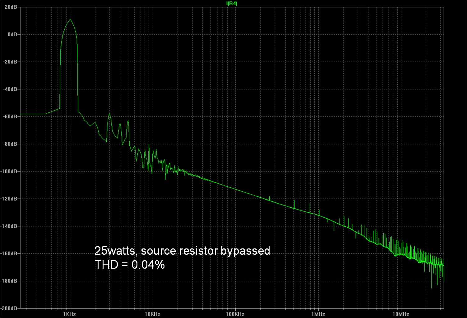

First are the distortion results with and without the caps.

Then with caps: THD is 0.04% as the square law effect kicks in to give us more class A operation.

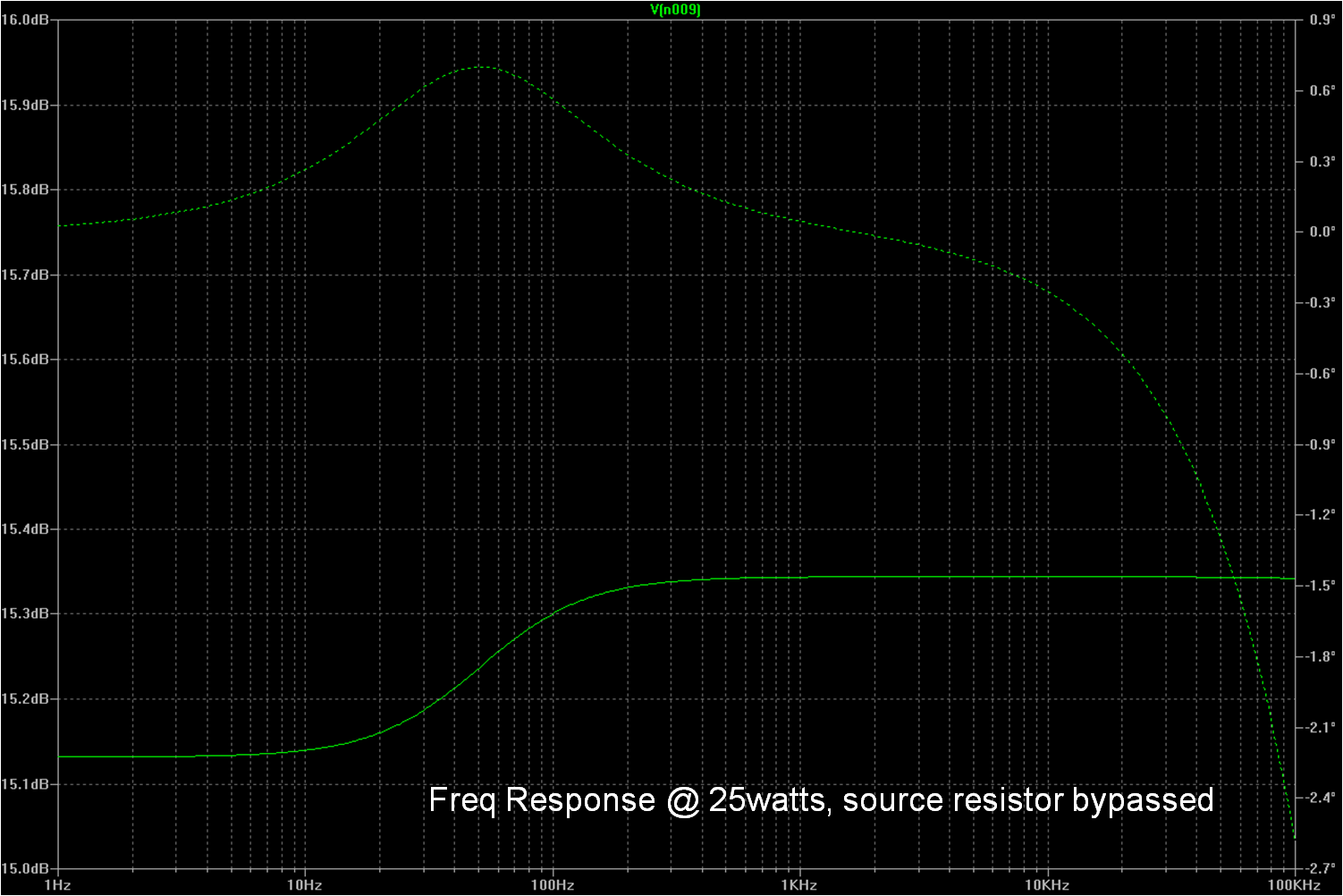

The caps give us some rolloff at low frequency... -0.2db at 10Hz vs flat as a pancake for the stock F5.
The sims aren't definitive of course and my own sim skills are wanting but overall impressions seem to square up with logic.
IMHO, a worthwhile thing to try in a stock F5 build since its completely reversible but I would stay away from going nuts with the amount of capacitance since it increases the time that it would take for the DC across it to build and so for the bias to stabilize. Till that cap is charged the bias will shoot thru the roof - so maybe 3300uF and then add another if things are going ok ?

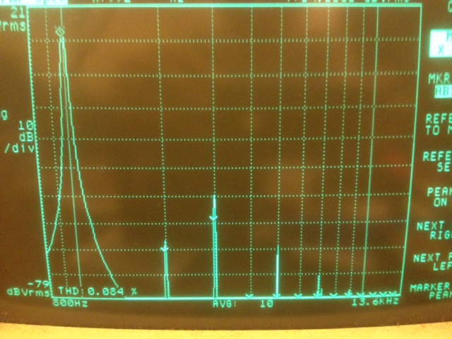

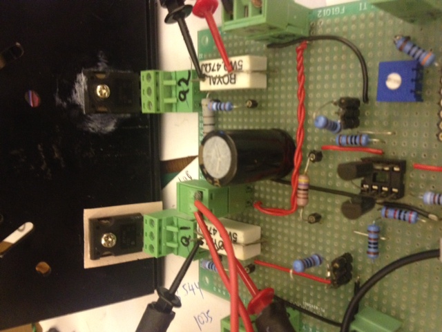

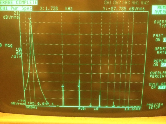

THD spectra - far and away less dramatic than the sim
Ok ... so what did we find... thd drops with the caps (from 0.084% to 0.049%) and ....
interestingly something funky happens to the h2/h3 balance!
Check out the detailed results:
No bypass caps; then WITH bypass caps
thd: 0.084; 0.049
H2:-69.8; -65.8
H3:-52.5; -59.6
H4:-91.93; -88.5
H5:-72.33; -74.8
So adding the bypass caps reduce overall measured thd but shifts thd balance in favor of H2
Dunno why this is the case, maybe the caps are not exactly equal in value and caused the added H2 ?
But anyway what we should see is reduced distortion by adding the caps and a subtle shift in H2/H3 balance that may suit your tastes or otherwise.
Also I dunno how much of the effect is due to square law and how much is just due to more gain from the output stage.
Not a trifling reduction nonetheless from just adding two cheap passives....
cheers

Your guess is right i reckon - i did not match the fets nor trim h2 at all so theres likely assymetry between top n bottom halves.

In this circuit bypass caps increase open loop gain, more feedback, less
total thd. The Source resistances suppress the differences between N and P
channel, so greater 2nd/3rd with bypass caps.
So is the apparent decrease in distortion a function of the cap doing something to the circuit's linearity,
or just because of the increase of total feedback?
sorry can't help there - I don't have a live F5 handy. I think i caused some confusion - the title of this thread was intended for the sim example shown earlier on. The measurements were done on another push-pull amp (see post 8). Nelson in post 16 explains the results nicely and I agree completely.
All that said, i have been using the bypass caps for some time and love them. I drop the loop feedback a touch as well while i'm at it. Opens up the sound a lot.
