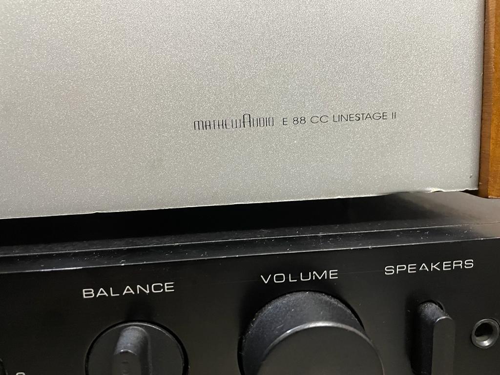

Currently im using krell kst-100 power amp, paired with mysical fedility a3 cr preamp, which is a very nice ss combination.
Im planning to buy used tube preamp, that seller said it is made by an indian designer who is good in this,
To be honest i have shallow information about Tubes, but i assume it will be a nice combination with my krell,
So i thought of getting assistance from this group,
Im attaching some pictures for the preamp, and would appreciate your comments on it
Thanks in advance

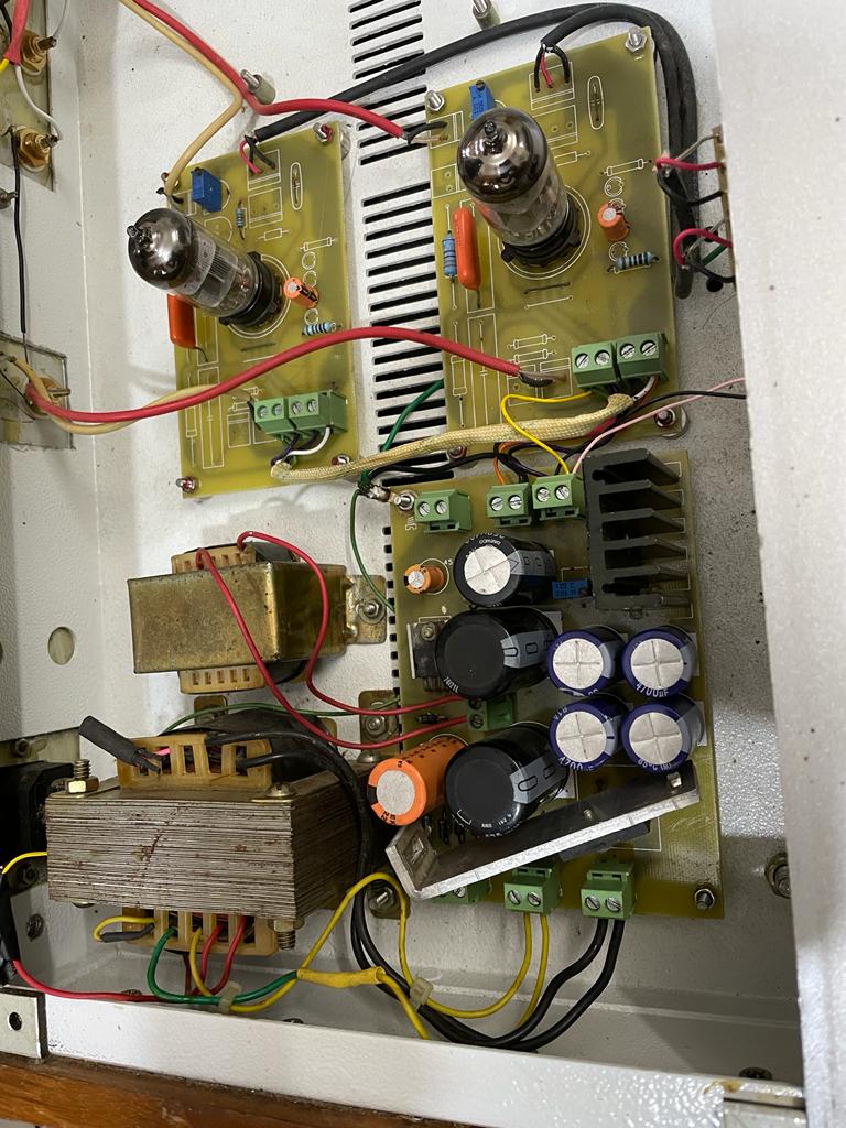

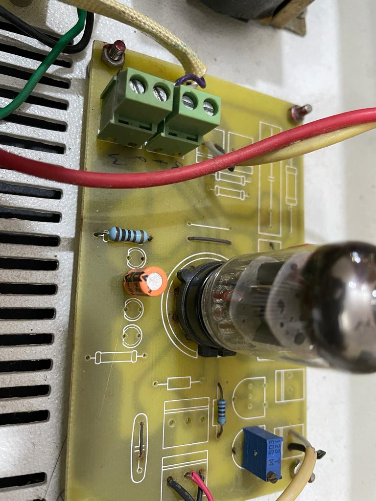

The amplifier boards seems lacking components, maybe only one triode is used as buffer. Make sure a schematic delivered.
I wouldn't buy it. Looks old with rust or corrosion on many parts. Questionable build quality. Might make a decent chassis to gut and use for a new build.
I don't see any op-amp. More likely SRPP stage for each channel since I don't see any high value plate resistor. Let's wait for schematic.Op-amp hooked to a tube buffer? That's what this looks like.
