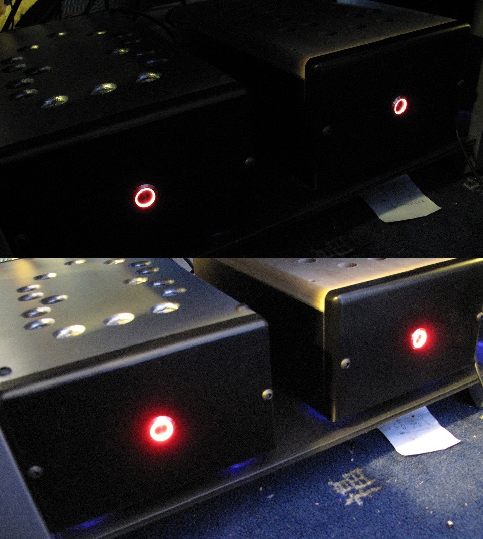

Metal LED Push Button Switch (Red Ring, Latching) on eBay (end time 15-Sep-10 23:51:26 BST)
Are the switches I purchased and they will handle 5 amps at 240 volts. It looks like the seller will also ship to wherever you are too and he has red, blue and green versions, only the front of the switch is brushed aluminium.
I can post a picture of mine in operation if you're interested.
Please do.

You can just about make it out in the pictures, but I've got glowing purple feet on the bottom of the boxes so I wanted a contrast against that. Otherwise I would have chosen blue 🙂
