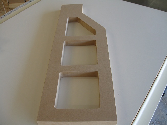

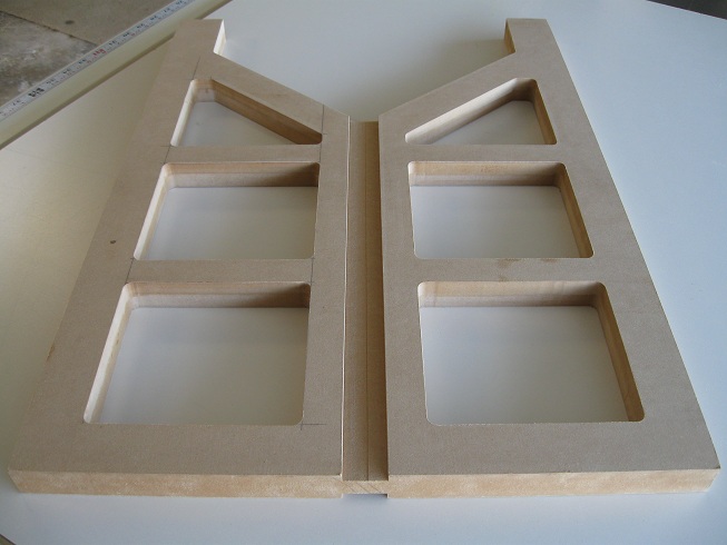

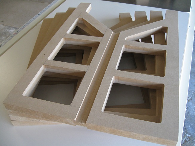

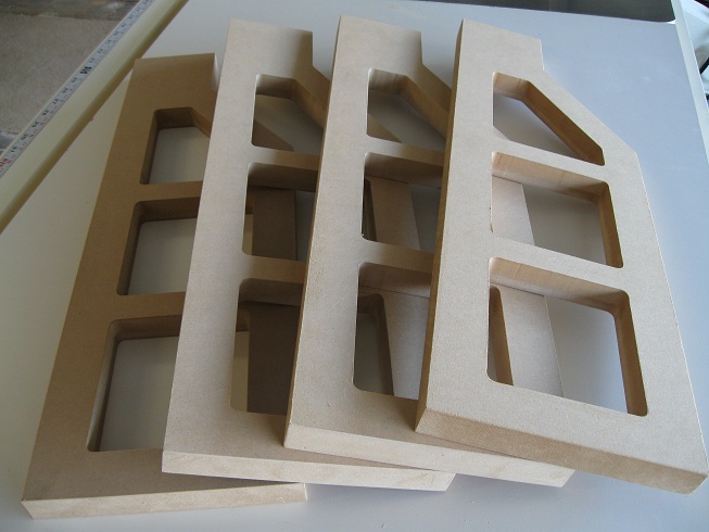

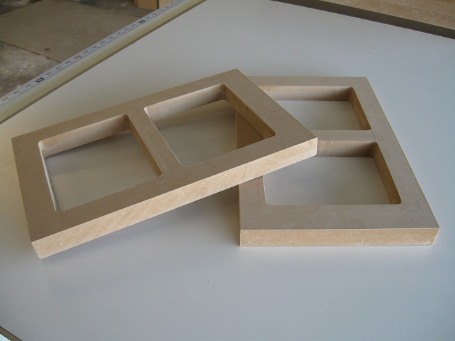

The braces

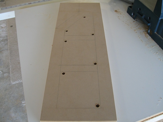

In 2007, Kevin Kerwin, an architect from St. Louis, decided to build the Platinum Edition. He created AutoCAD drawings for CNC cutting of the wood and graciously made them available to other BassZilla builders. I wanted to mount each crossover in its own box and keep the construction of the baffle simpler, so I did not use that portion of his drawings. I did however use his box plans as the basis for my version because I liked the way he braced it. Unable to find a local CNC shop I cut the wood for my BassZillas with the tools I have available: table saw, jigsaw and router.

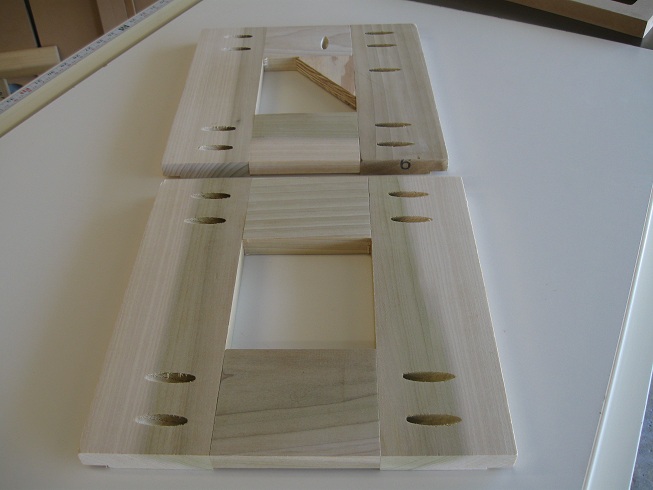

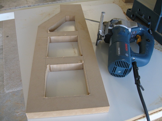

I created templates for the openings of the braces and used them to mark the MDF. I drilled holes on opposite corners big enough to accommodate the jigsaw blade and made rough cuts close to the lines. I then clamped the templates and trimmed the openings using the router and a flush trim bit.

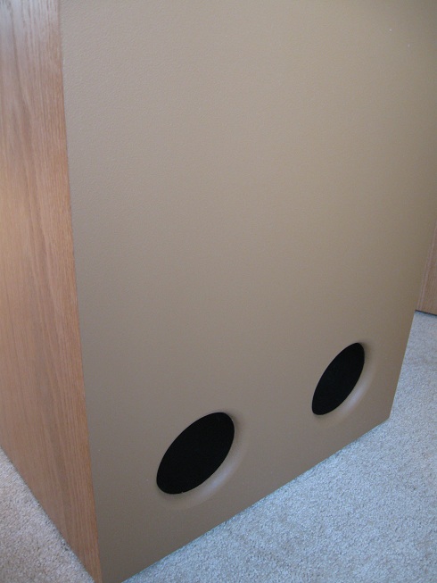

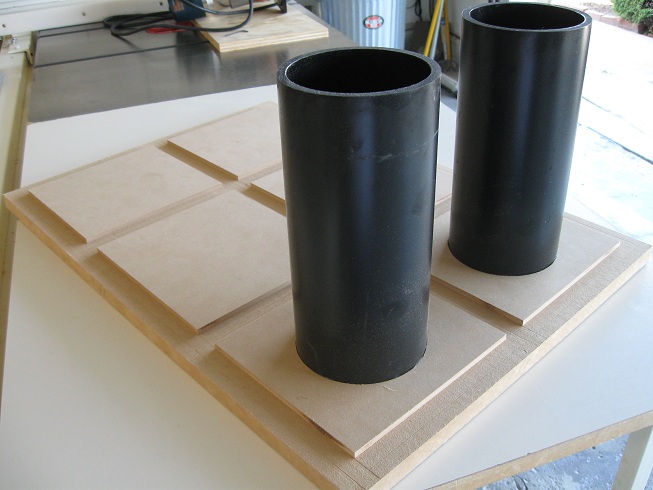

The back panel

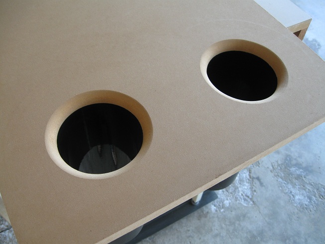

Using the router and a circle jig I cut slightly undersized openings for the vents. I cut internal rabbets to fit the PVC pipes and finally trimmed the openings from the outside using a roundover bit.

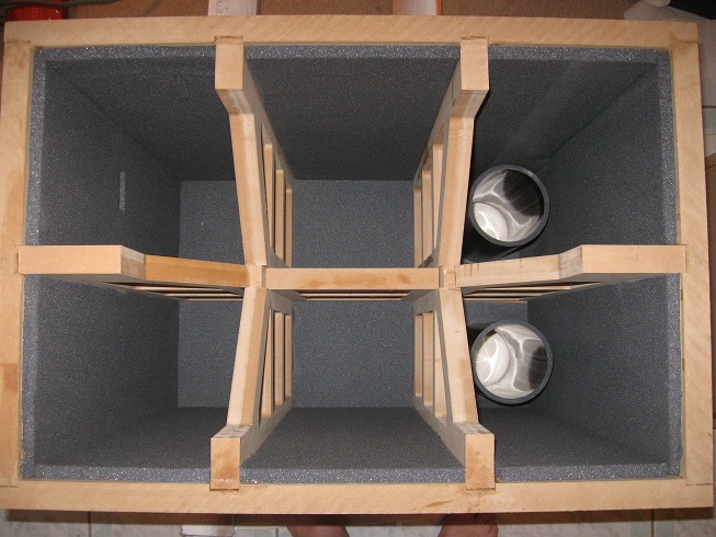

The box

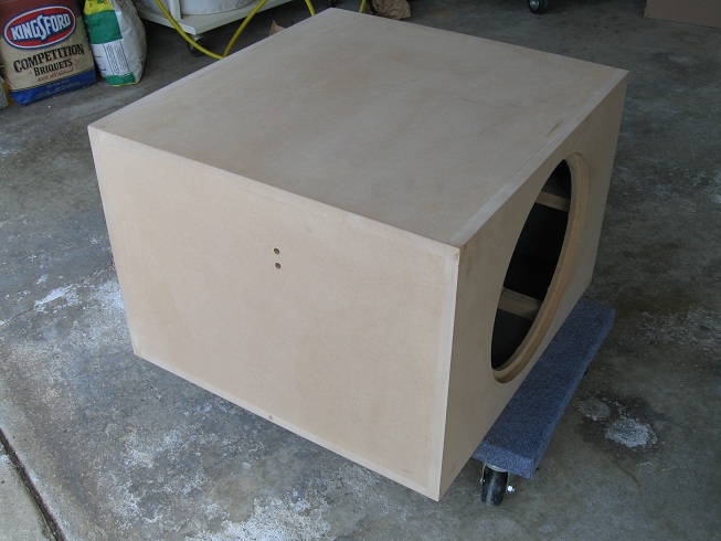

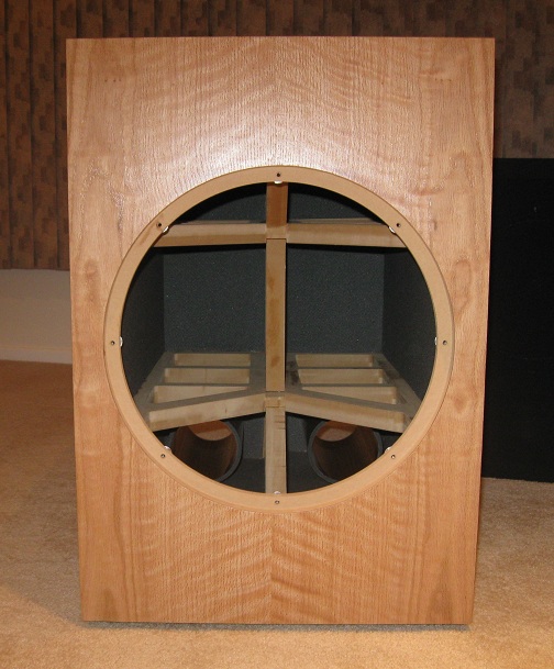

This is a view of the assembled box minus the front baffle. Because of the bracing I decided to install the padding foam before finishing the assembly.
The box fully assembled and sanded, ready for veneering and painting. Notice the holes for the binding posts on the top of the box.

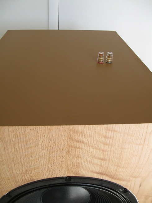

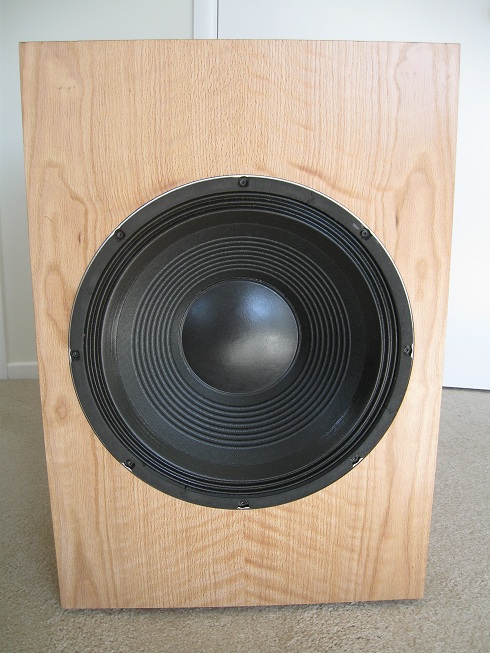

The finished box
The box is now veneered and finished with water-based polyurethane.
The top and back were just painted as they will be out of sight.

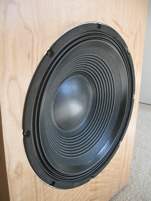

The woofer installed and flush with the baffle.
The top of the box with the binding posts installed.

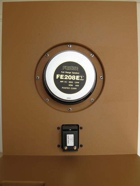

The open baffle
The open baffle finished with the drivers installed

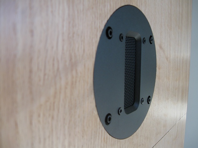

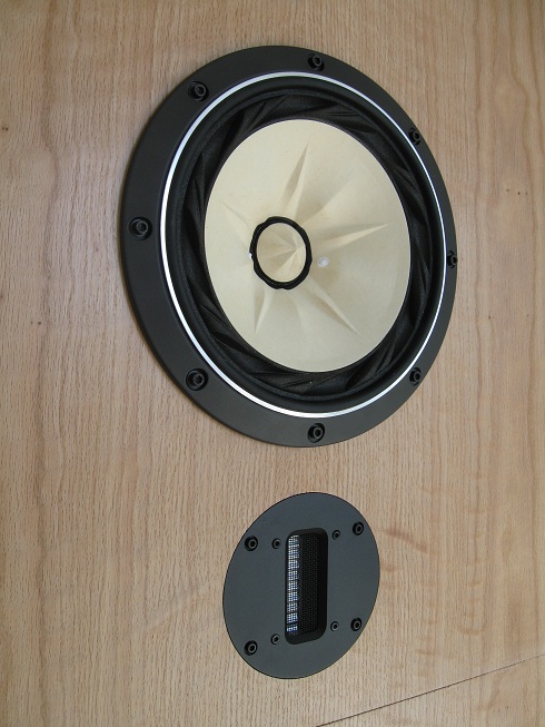

The detail of the tweeter flush with the baffle.

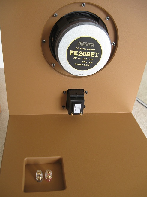

The back of the baffle showing a rabbet cut around the full-range to maximize air flow.

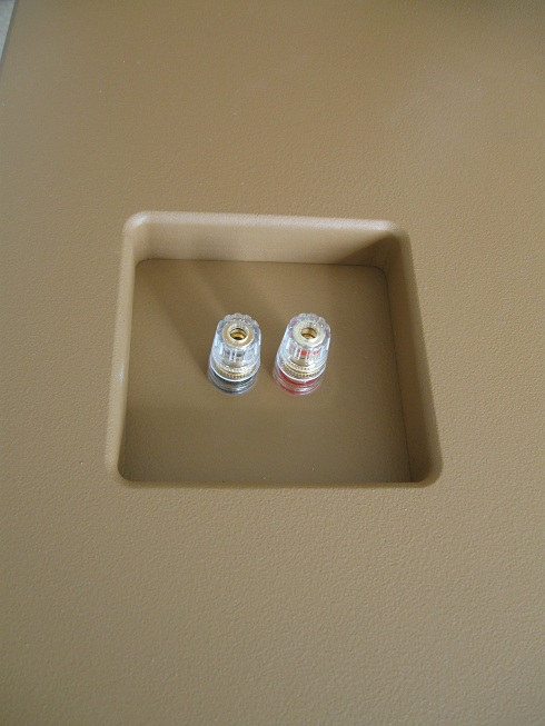

A view of the drivers and the cut in the base of the open baffle matching the location of the box's binding posts.
A closeup of the opening in the base.

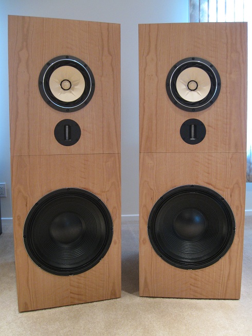

And finally, the completed BassZillas

The sound of the BassZillas
I am thrilled about the sound of the BassZillas. There are two aspects that stand out and I believe will convey my impressions about how they sound. First is the bass generated by the 15” woofers. As a teenager living with my parents I had a large bedroom and DIY speakers with 15” woofers. They were of average quality but delivered a gut punching bass that stayed in my memory for all these years. After I moved out of my parents’ house, space constraints prevented me from owning large speakers. The BassZillas brought back that bass with 30+ years of speaker technology improvement. The second aspect is what the open baffle takes away: the boxy sound. I had heard people talking about it but did not know what that was, until I first listened to an open baffle. It makes the room sound much bigger than it did with regular speakers. As for the imaging, I’ll quote my girlfriend when she first listened to them: “Funny, it sounds like the singer is standing between the speakers”. I think that says it all.

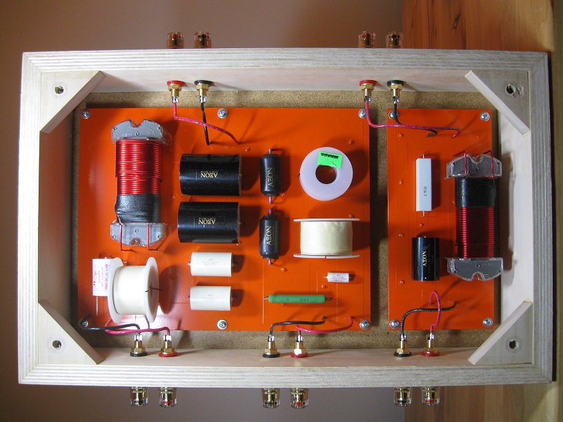

Thanks, I am glad you enjoyed the pictures. The speakers used are the recommended ones for the Platinum Edition MKII, as published by Mr. Olsher in December 2008. The crossover design and component values also comply with the provided schematic diagram.
I built the crossover with separated inputs for the woofer and the mid+tweeter to allow for the use of two amplifiers. I have listened to them that way and it helps if you like that extra punch in the bass, especially with old recordings. Otherwise, being efficient speakers, my DIY versions of the F4, F5 and Aleph J are able to play them plenty loud.

The BassZilla plans include the schematic diagram for the crossover but no layout or instructions to separate the inputs. I decided to do it because I have been using bi-amplification for many years, and wanted the flexibility to do so with the BassZillas. Building a short cable to bridge the inputs is so easy, it would be silly on my part no to separate the inputs. The link below shows one other BassZilla builder who agrees:
