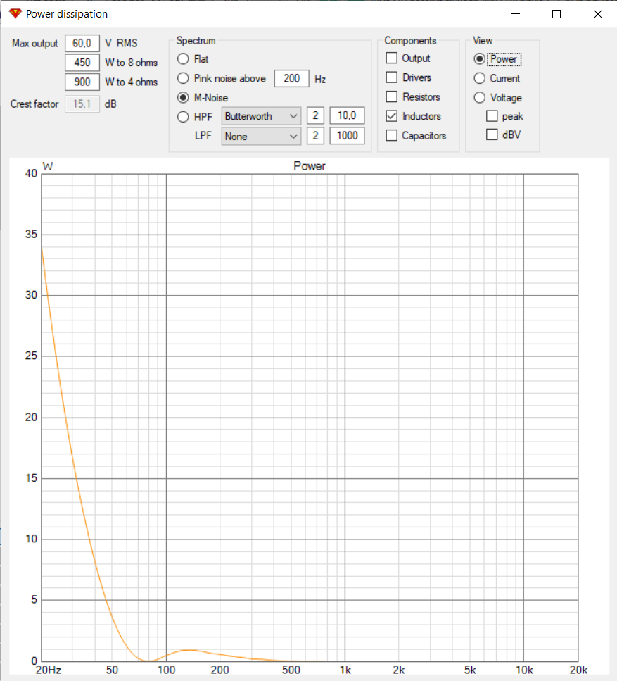

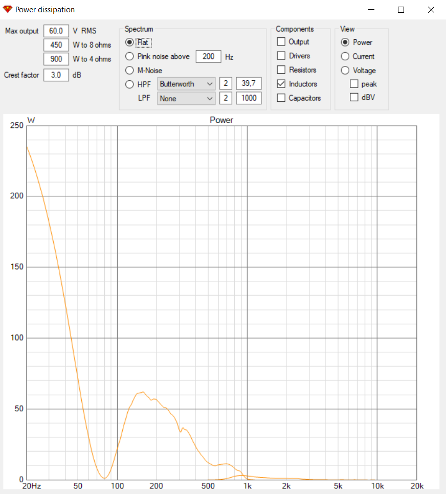

Your capacitors won't see power in Watts. A simulator can be used to show maximum voltage they'll see. Consider the current through inductors and how their resistance will cause heat within them. Inductors usually aren't specified this way, you'll want to confirm your own situation by monitoring them, which means feeling and smelling them as you go.
Xsim does have neat tools like that. Make sure to set your amplifier power first through the amplifier block on the schematic.

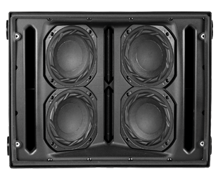

@WhiteDragon I should clarify. was planning on doing something like the Yorkville psa1, which makes dispersion and beaming less of an issue, but decided against the supper tweeter, now I'm just going for a regular horn so i don't have to cross so high. Thank you so much for the info!
Ahh cool, sounds like fun.
Cross Fire or splayed baffle seems like a lost Art.
I've mentioned or suggested them for multi drivers.
And people make funny faces or excuse them cause they dont " look right"
So cool choice.
Takes much more time to simulate.
But can be done and helpful to see the notch in the response.
When you start to increase or decrease splay angle.
Be interesting to know what Yorkville used.
If I remember shallow splay not more than 15 to 20 degrees
worked best.
Once you go up to 30 or some even 45 degree
the response notch is more apparent. But usually
very narrow notch. Not much more than notches
you could get in a normal room without a splay.
Very cool, good way to mount drivers vertical and horizontal.

@WhiteDragon great minds think alike🙂 also these 250 caps volt from parts express should be able to handle the now 700w 4 ohms im planning to feed these speakers! from the info from u🙂 was planning to do a 10-20deg but maybe i will make it adjustable in future reiterations. currently pk sound has a very nice cross-fire mid tweeter setup on there line arrays. so the lost art stays alive🙂
