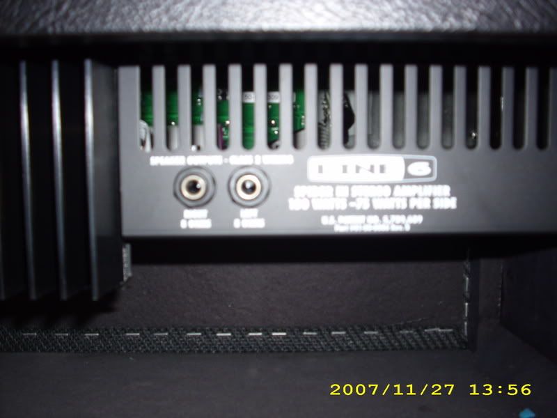

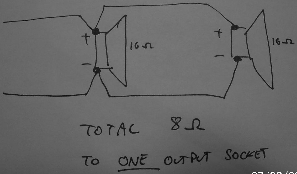

I have an old cab from like the 70s and i want to make a new cab for the speakers.
The cab contains 2 15inch 16ohm speakers. i was wondering how i could wire those together for 8 ohms.
I have a line 6 spider 3 head with two 8 ohm outputs on the back. could i wire 2 inputs with 1 speaker to each in the cab? or would this not work
I really am not to smart with wiring.

BE CAREFUL !!
If your amp is the Line 6 HD150, it has two outputs of 8 ohms minimum each, this amp is stereo and you can´t use only one of the inputs or connect them in parallel.
If this is the case, you can connect one 16 ohms speaker to each channel. The amp can handle speakers with more ohms but not with less. If your amp is the HD75 (like mine) you can connect the speakers in parallel to obtain 8 ohms because this amp is mono. Don´t worry to ask about.

Aidan135711 said:If he does this,will the amp will not produce as much power as it could into 8ohms?
Depends. On some Line 6's each output has it's own LM3886. If this is what he has then 1 driver per chip is the batter way to go.

Well I have played out of this cab using only 1 output for about a year and had no problems.
Id really like to use the full power of my head though, so only using 1 output doesnt seem good.

Ok, if your head is stereo and you are using it for about a year with only one output connected without problems, you are lucky !
Line 6 clearly express that this is very dangerius. Why not connect one output to each speaker ? In this way your amp will be using 16 ohms by channel, the total power of the amp will be less than using 8 ohms but more safe, and if you use only one ouput the total power will be the half, remember that the HD150 is 75W per channel. About the size, of course you can !

I will start building my 2X15 cab this weekend, with 1 input so 8 ohms. then once i finish that cab im going to buy two 12'' speakers(16ohms each) and make another cab to hold those two speakers. So i can really use the power of my head. 1 output for each cab.
I think the hardest part is going to make them stack
But thanks for all the help. those links gave me a way better understanding of what im going to do.
