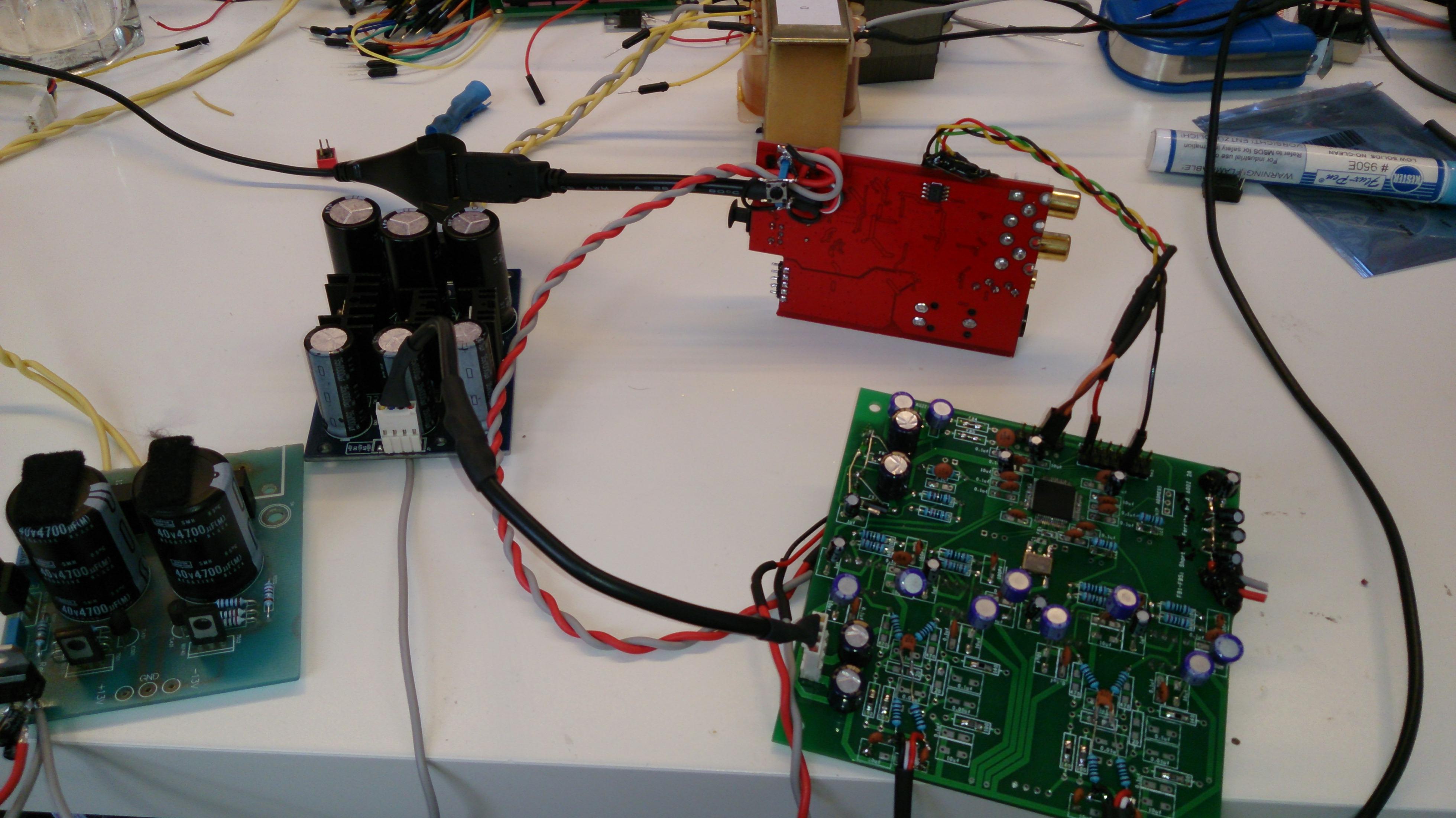

Finally its alive 🙂
First pictures on the scope just arrived. And it is working...

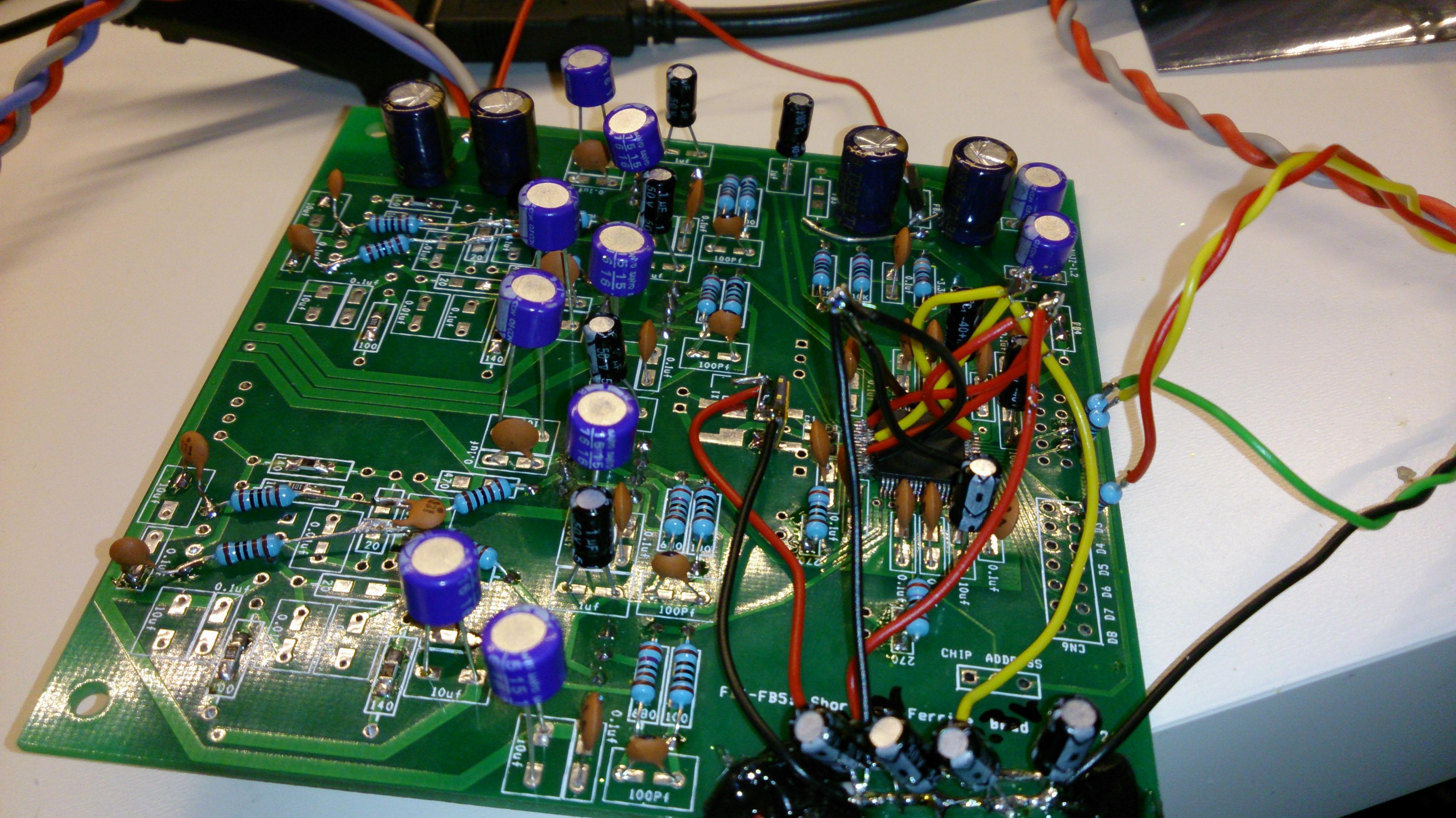

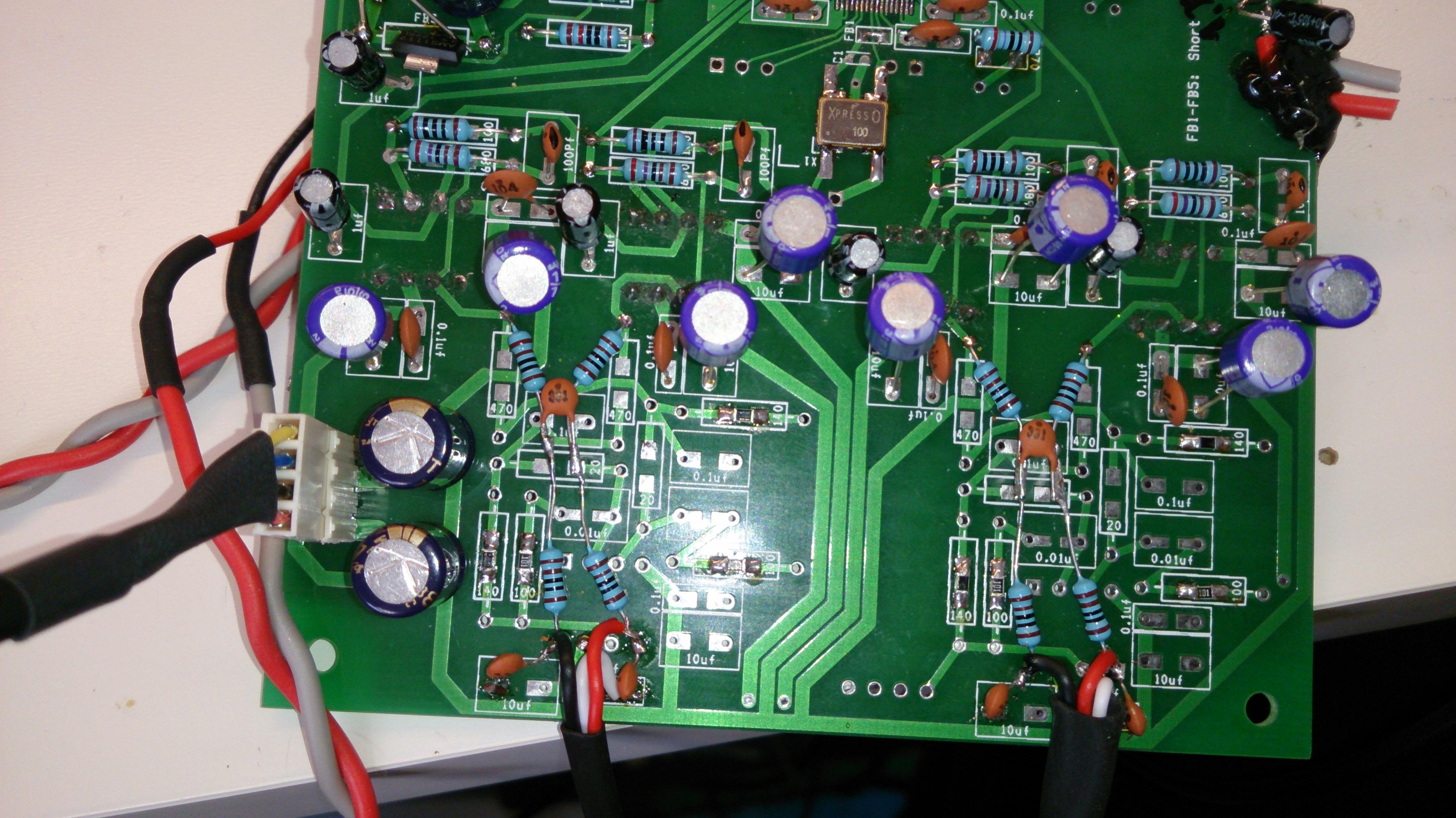

The board has a lot of messy modifications. But thats the reason i got this board.

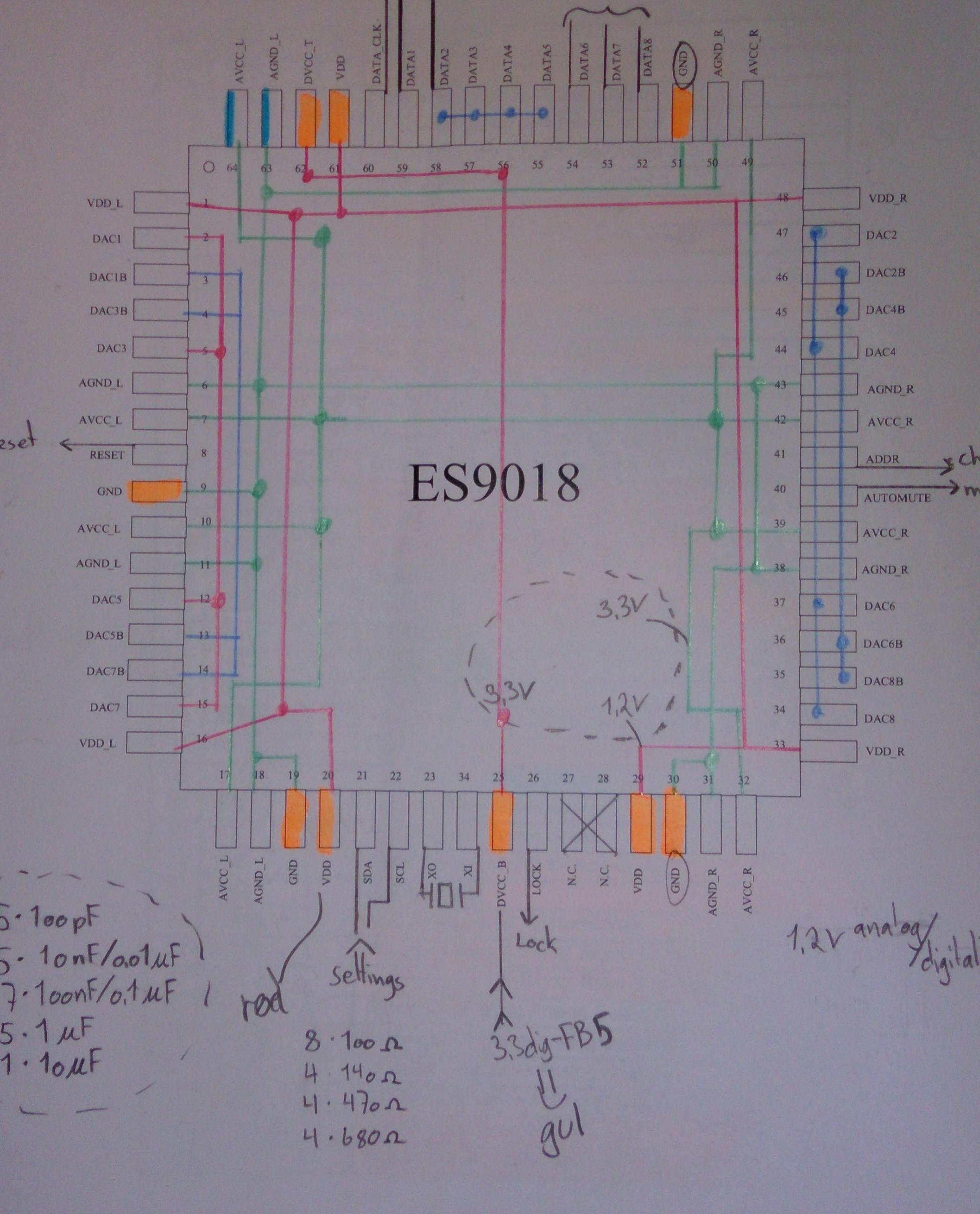

mod 1 - Separate ground for analog / digital signal
mod 2 - Balanced output (following ESSTech´s design ??)
mod 3 - Power supplys
Components used is at the time a mix of some good ****, and some that I had available. Esstech rated AD797 on top. So of course I had to get a few of these expensive op-amps.
Tomorrow I hope I will manage to do a simple test, that its actually working with amps instead of scope. After I have fixed one of the outputs that didnt behave as supposed to. The negative output on one of the channels.

I notice from your pictures that you have a few connections directly to the chip pins. What are these for?
Can you please explain in a little more detail the mods you have had to do get a balanced output and seperate the Digital/Analogue grounds?

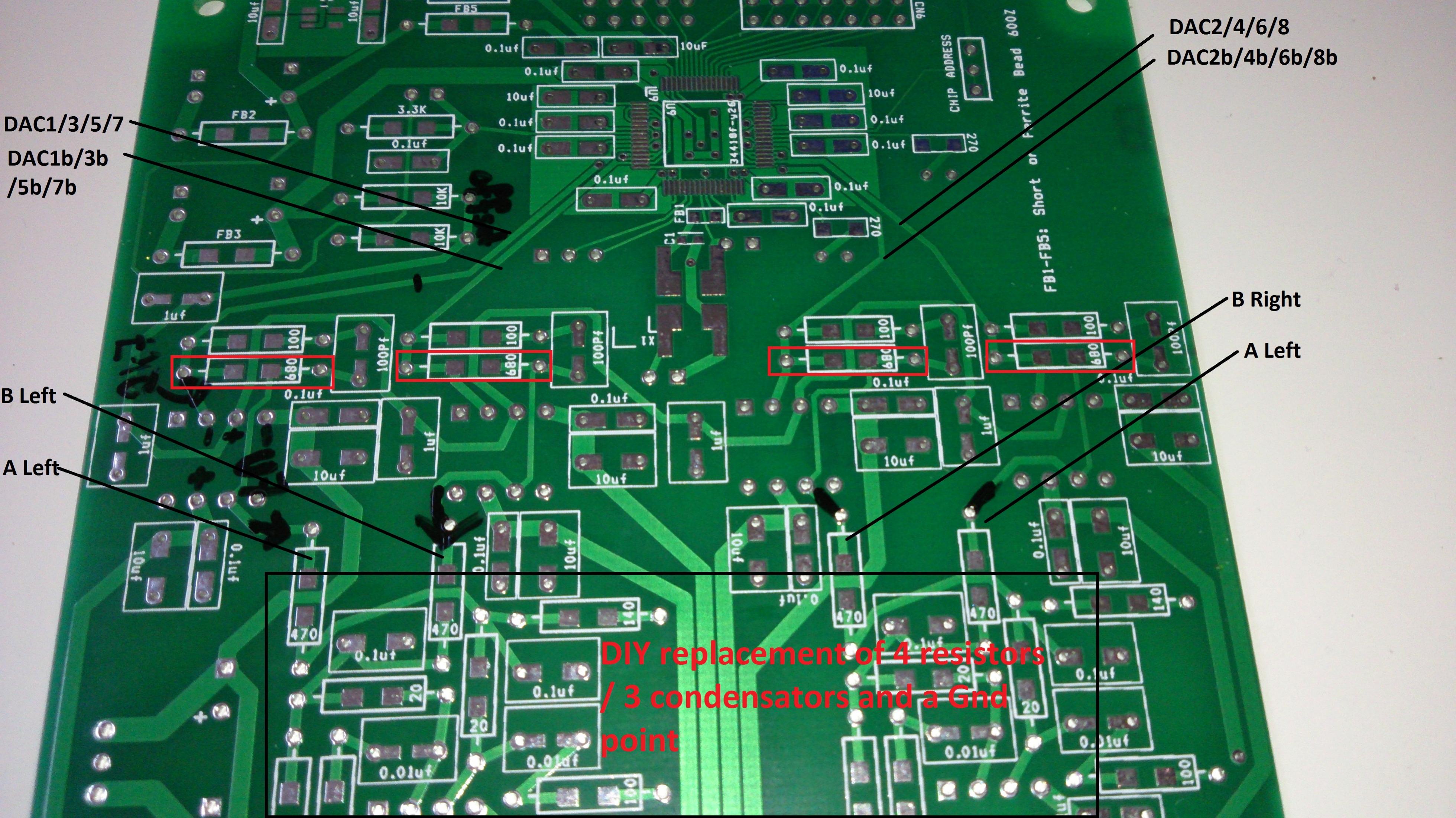

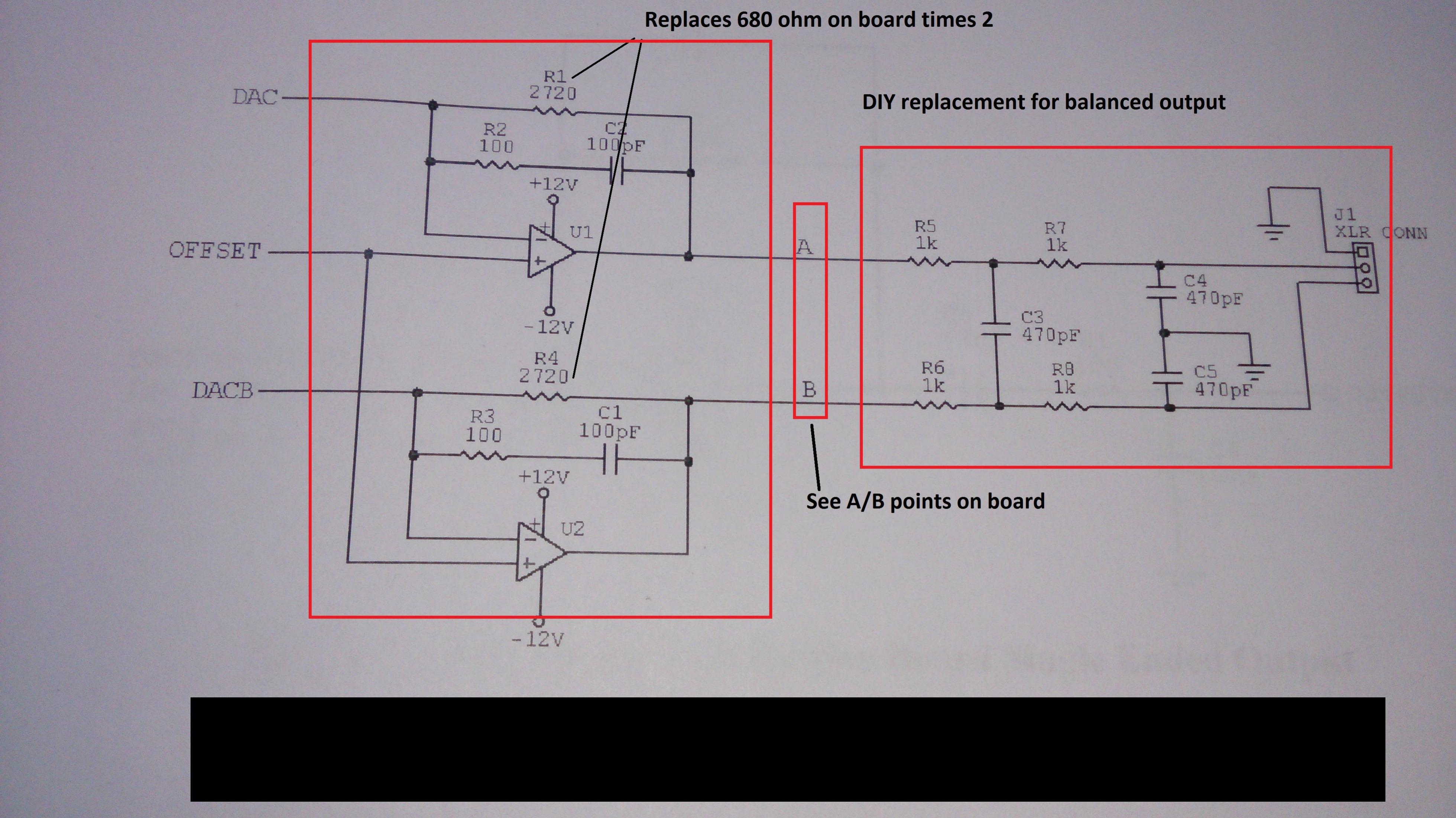

Balanced output :
Replaced 680 ohm with 2720 as in ESS´s papers, which probably is because the single ended output is removed, otherwise i dont know.
See pic´s.
Balanced output :
See pic´s.
Direct connections is Dig gnd, which will be removed....
Red and yellow direct connection is digital 1,2 and 3,3 Volt supply. Delivered from another PSU then the analog parts.
Crystal has its own ADP151 3,3V regulator, and crystal is one of the few 100MHz I found on RS online. Crystek seems to be non-available on ebay / ELFA / Rs-Online / Farnell.

Balanced output :
See pic´s.
put the 680R back, you are following the 8 channel IV values... 2720/4 = ?? with 2 channel you have 4x the current, so need 4x lower resistor to get the same voltage. with stereo and 2720 the output would be erm...slightly hot.
the ESS App notes that are available sometimes use one or the other and either dont mention it, or its a bit vague. to be sure though 680R is correct, not 2720

actually you better watch out with that resistor value, I would replace it before switching the dac on, you may kill the dac with output voltage compliance
It has already been on, but not connected to anything yet, except scope.
I´ll replace them before any further testing. And do som calculation afterwards, to se what settings that will match my ASP1000 modules the best.
cool, yeah short periods will probably be OK, but calculate for just under 16mA for a stereo channel. so if you are running the balanced out and dont have the second voltage divider on the second stage BAL-SE convertor opamp to bring the voltage down, then youve still got a pretty damn hot output with 680Ω

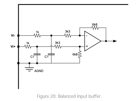

Schematic of dual ES9018 balanced setup.
Did I forget anything ?
Is it okey to use the same crystal for both ?
Is it okey to just connect all data inputs in parallel ?
edit : Added offset circuit which i had forgot.

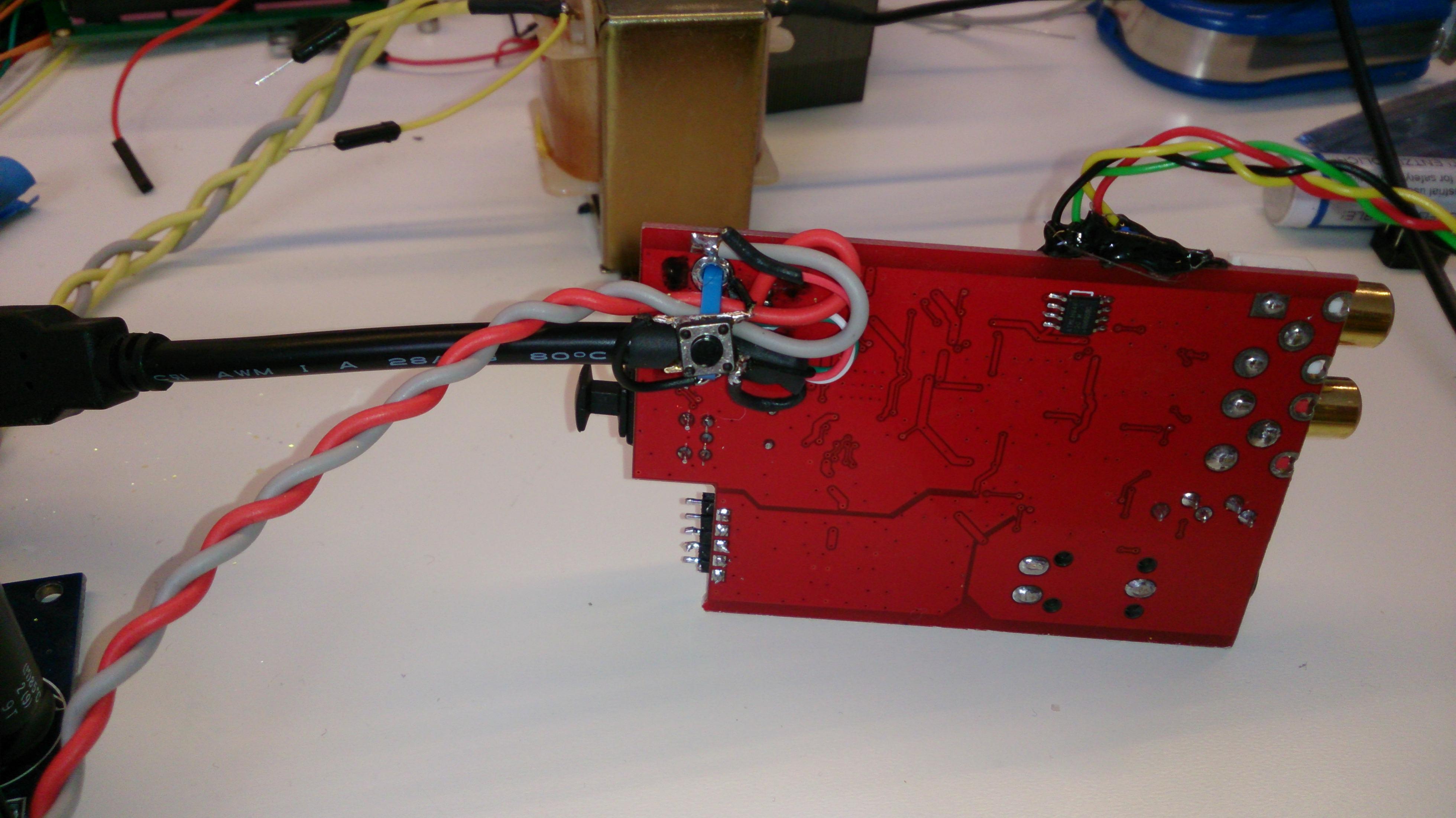

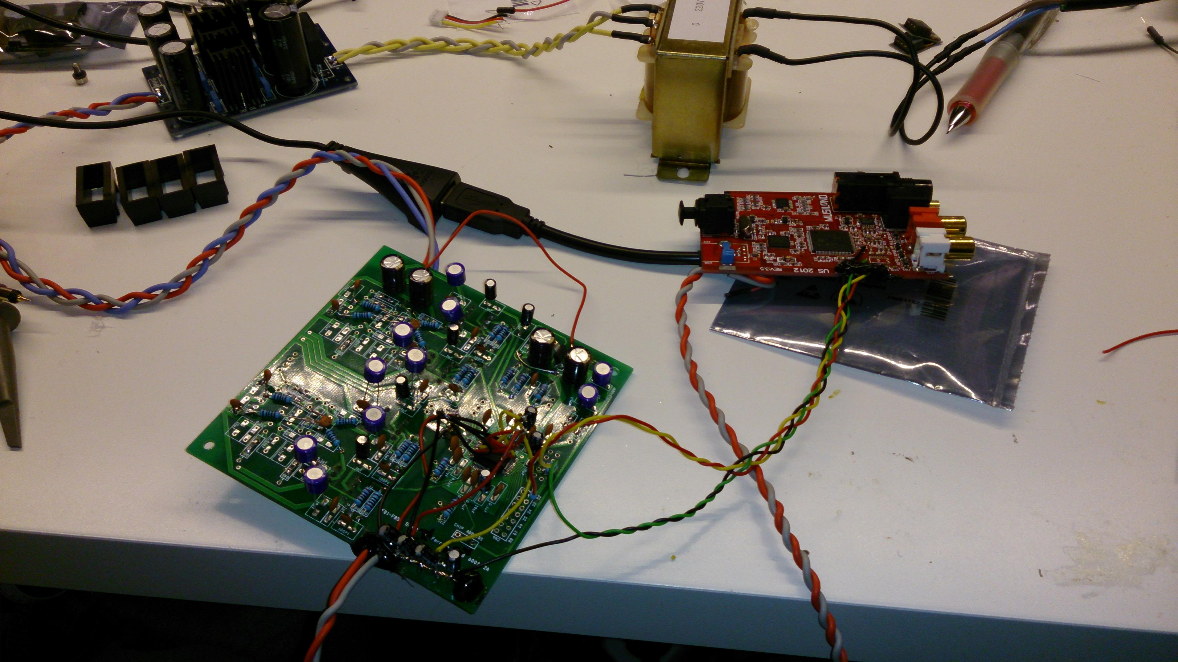

Finally had some time, to undo some mods, and connect anything needed.
Musiland US01 2012 :
I disconnected ground and power from the computer cable, and added a switch to connect ground if needed. This because when gnd is connected, the computer senses the audio card. But afterwards it works fine without it. (usb data dont need gnd reference to transfer data)
Just hold the button a few seconds at startup, and everything is fine.
That also solves some of the lock-down issues with the Musiland DAC. Need further testing to know if it works flawlessly now. But it seems much better on the bench, due to no lock-down when iI turn on/off other equipment. Which it did before.
All ground connections has been connected as supposed to on the DIYINHK board. Only difference is the Balanced output, and that I put some 1117 3,3V regulators directly on the board.
Output signal is measured at +/- 11V at almost max volume on computer. I dont use any pre-amp yet. And therefore dont modify the I/V converter any more yet. (to decrease the output voltage).
AD797 and es9018 easily temp and functionality checked on the bench, and nothing gets hot. AD797 is a littlebit hotter then cold. ES9018 is, I guess about 45-50 degrees.
See pictures for visual details.

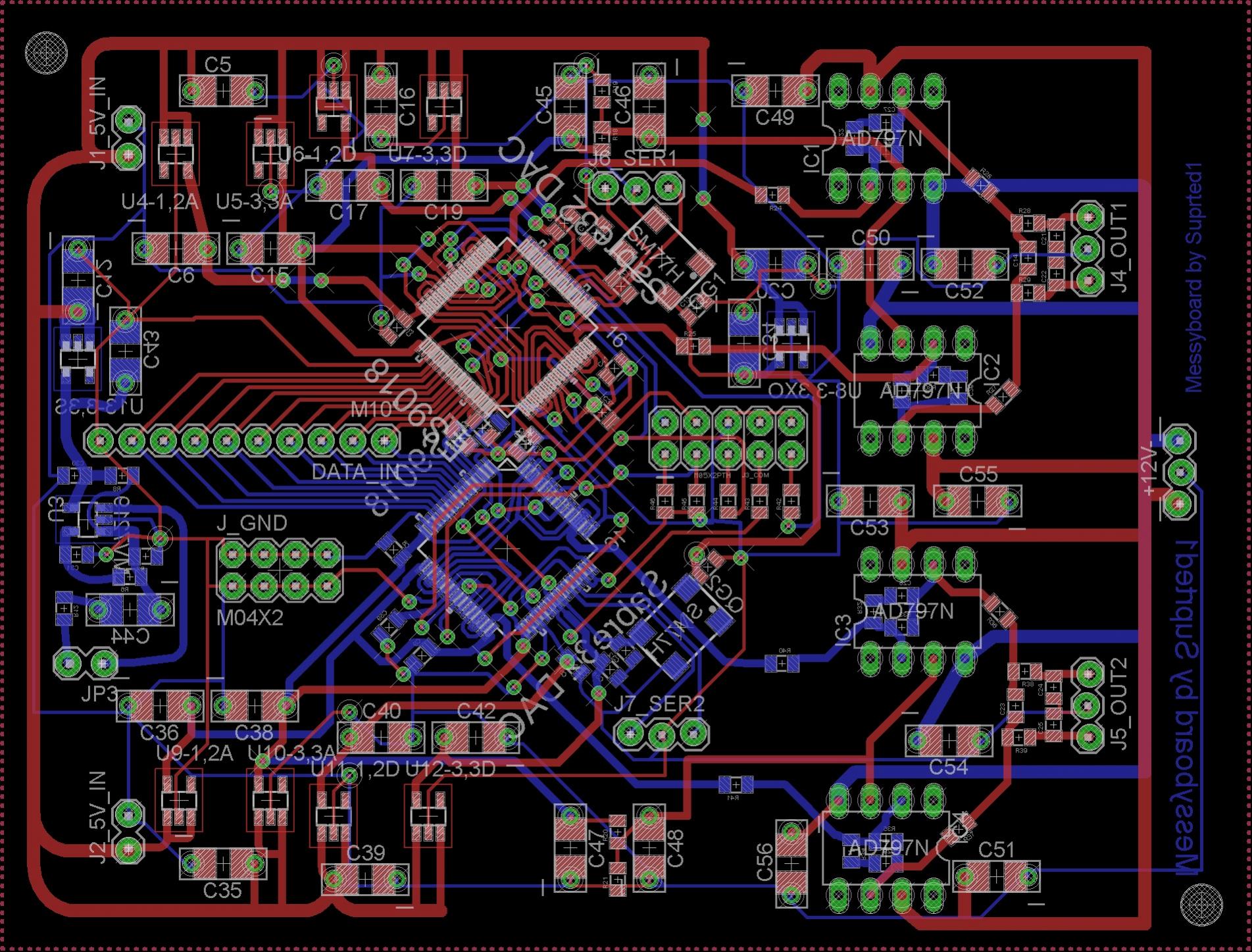

I also made a new board in eagle for dual ES9018 chip´s. But its pretty messy.
