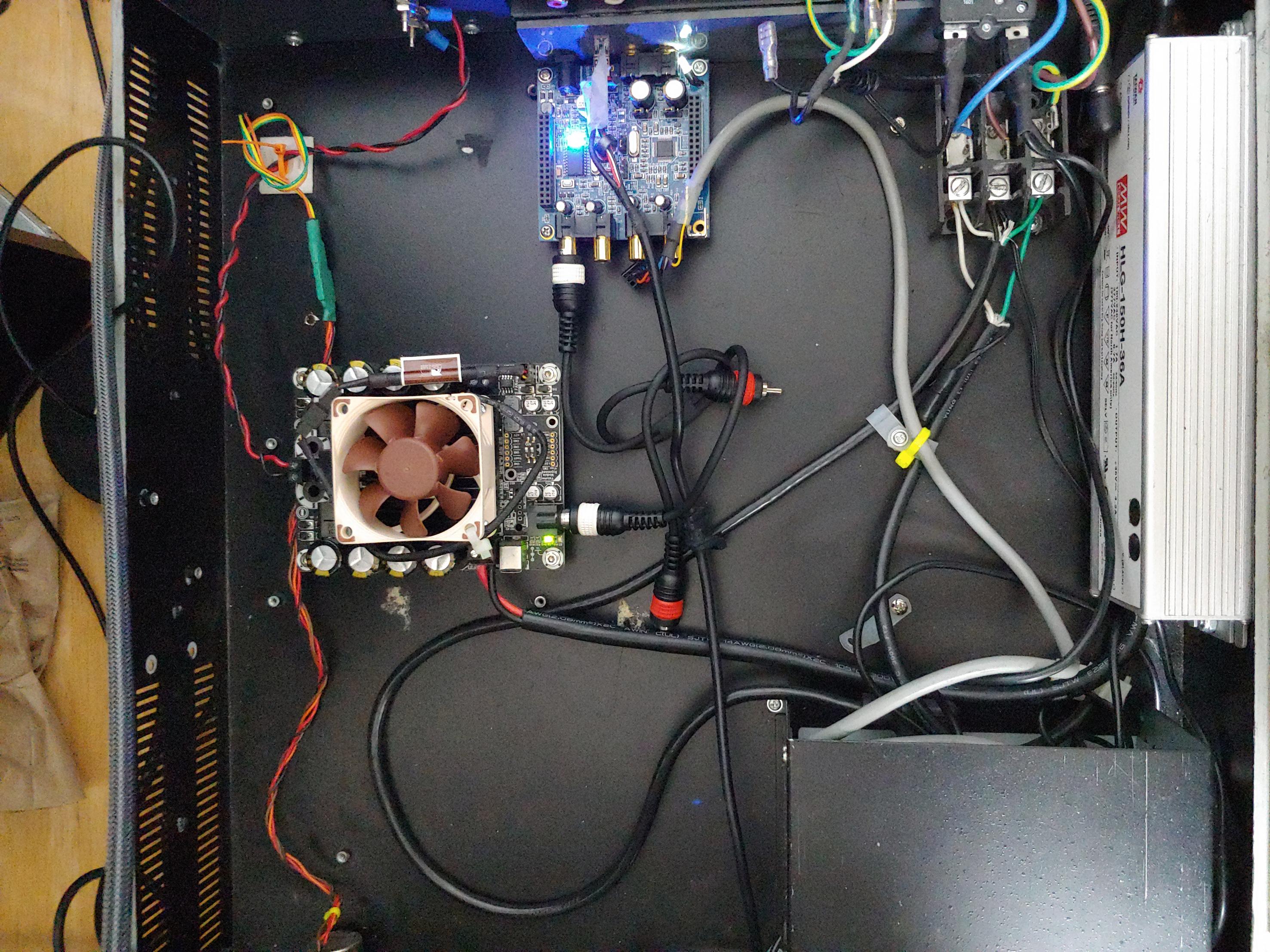

If you want to try the diy path, the sure amps are a great way. I have this setup
Meanwell HLG-150h-48a. These are sealed waterproof power supplied designed for 24/7/365 ussage at full power. This one will supply 150 watts at 48 volts. I am using it at 40. Sealed, waterproof and with power safety built in.
amp: 500W capable/ Me, im a running it with a 140 watts power suppy
Sure Electronics AA-AB31511 1x500W Class D Audio Amplifier Board Compact - T-Amp
My box is an old discarded computer. All you need is to connect the power to the amp, the power supply to power, rca to the input and banana pugs or bare cables to the output. NO need for power harness. Fir seven dollars you can get also a volume control
